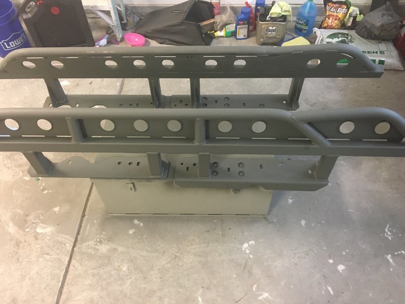

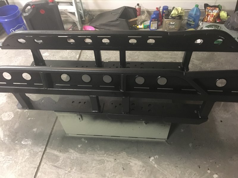

  5. Dec 19, 2016 at 5:06 PM
    #205
    oorah54
    oorah54 [OP] Well-Known Member
    May 13, 2016
    #186887
    566
    Darren
    Guyton, GA
    2015 Blue Tacoma Base
    Bedliner is done on them. Now I'm going to let them cure for a couple days then throw them on the truck Wednesday night. I don't recommend trying the Duplicolor Bedliner spray. Most of it just dribbled out of the nozzle and onto the floor. I sprayed a layer on each just for the extra texture then put two coats of the Rustoleum bed coating on. Tomorrow afternoon I'll rotate them around so I can prep, primer, and coat the backside if the flanges that will meet the frame.

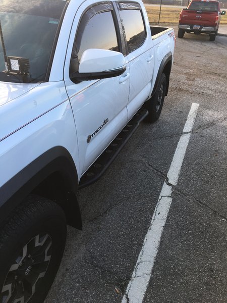

    I dont think I ever posted a picture of the finished product. The fit was awesome. Had to do some minor tweaking to the black box on the drivers side to get it to slip through the holes, but after that, no problems whatsoever!

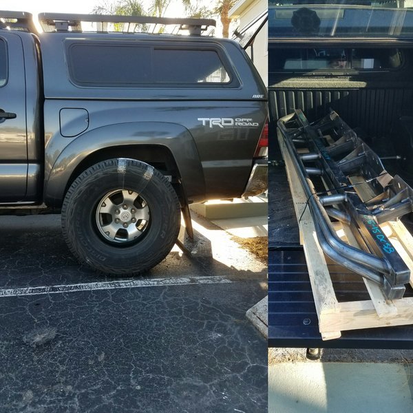

    2013 DCSB TRD OR 4x4 Mag. Gr.
    Sliders and tires showed up same day:) at my local powdercoater!IMG_20161229_112355_385.jpg

    21 MGM Sport
    Did you bedline the whole slider or just the top of the fill plates?
  19. Jan 2, 2017 at 7:46 PM
    #219
    oorah54
    May 13, 2016
    #186887
    566
    Darren
    Guyton, GA
    I did the entire thing. The Rustoleum version doesn't have the cheese grater surface like Line-X. It's just enough grit to provide extra surface.
