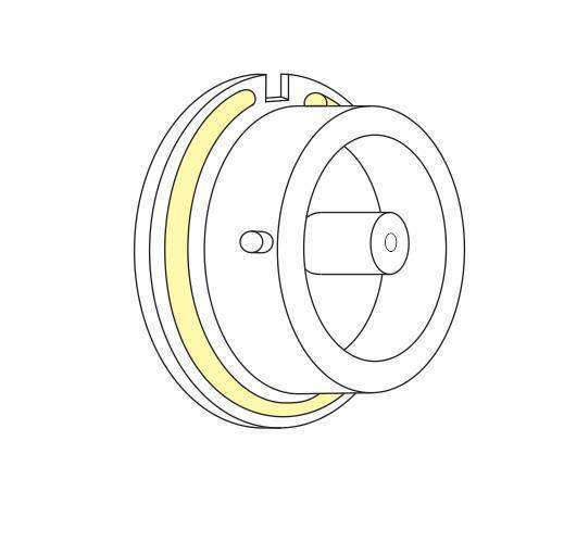

    D2s go bulb locked in place, then the metal ring, then the rubber gasket, and then the large locking ring with two notches in it

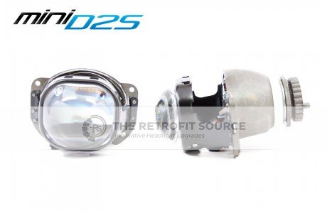

    Didnt mean to say retaining clip, was reading about it and last thing I saw was retaining clip. Pretty much on this picture youll see the back pieces, I have the harness needed already in, then all the pieces inside but the bulb still spins inside. moirmoto_mini_d2s_30-5739_1_zps001aa1d3_985800154a85bd79e7e3a8d96d992c44fa623988.jpg

    Thats exactly what I have but still the bulb spins, I found this video and did the same steps but still the bulb spins in the projector whenever I try and take the ballast connector off the bulb

    Are you sure it's not the projector spinning, because mine does that. Your bulb can't soon if it's placed onto the notch it's impossible unless you have something in there wrong

    I think I might of had the rubber piece facing the wrong way. Might be the reason, but I had tightened the final locking nut and it was still spinning. Never had a problem like this on my first retrofit, dont know why its doing it now. Ill be able to play with it more tomorrow.

    Hmm ivehad my rube piece every which way and its worked fine, are you sure you didn't break the tab off the housing or something ?

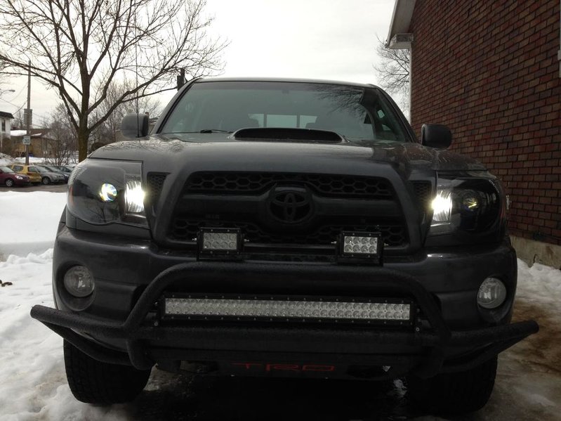

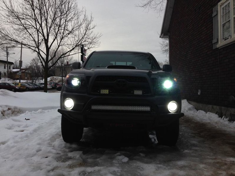

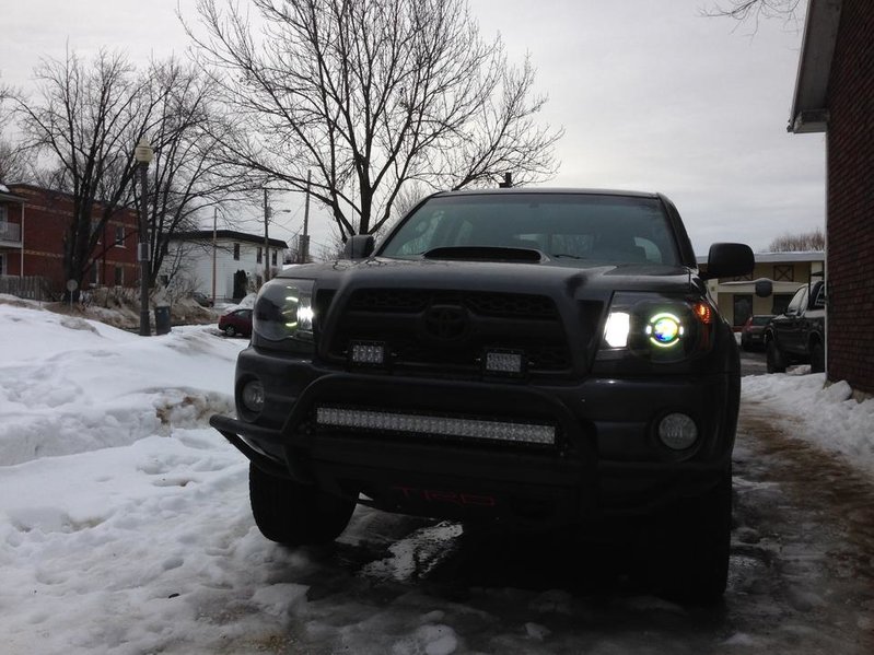

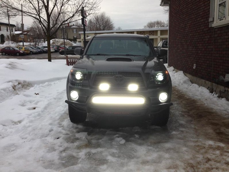

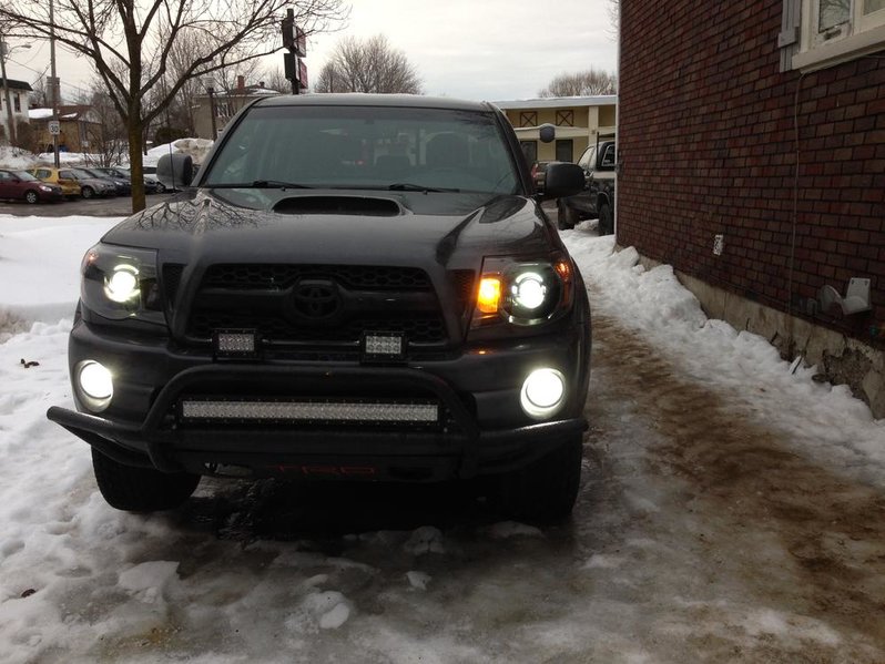

    my retrofit is done; I was lucky enough to have both ballast working at the same time for pictures :) can't wait to get the new one soon…
    Magnetic colour match bezel with black bowl and shroud. 3'' FX-R, XB halo inside.
    Painted all reflectors since i'm using some VLEDS switchback running/turn signals + VLEDS fog light bulbs…
    all i can say is it's bright :D
    DRL only
    Halo's
    projectors + fogs
    switchback turn signal
    the whole shebang
