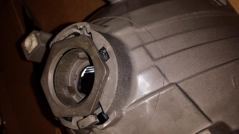

    So I'm balls deep into this retrofit... I'm trying to mount the projects into the bowl but the threads coming from the projector aren't very much and the nut is way bigger than the hole. Am I doing something wrong?

    Is the projector hitting anything when you are feeding it through the lens side of the headlight? When I did mine we had to cut some of the shroud to get them to go all the way in and seat properly.

    No. I think they gave me the wrong hardware. The lock nut is a hexagon and not round like the ones I've seen on other peoples install threads.

    Does the nut fit the projector when it's not in the reflector?
    What all hardware do you have? The projector should slip through a pretty fair amount. The only thing on the projector side of the bowl should be the projector and the large silicone washer.
    Everything else goes on the back.

    Large silicone washer on projector.
    H4 adapter, lock nut spring and 2nd lock nut to secure bulb
