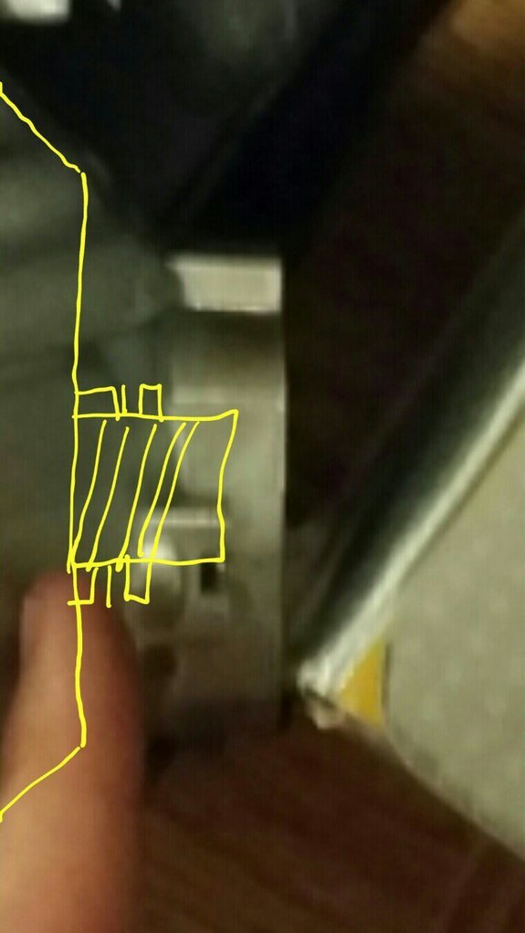

    This is my idea right now. Where my finger is I will cut flat then make a new backside to it with hole for the shank to come through.
