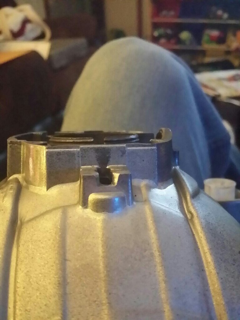

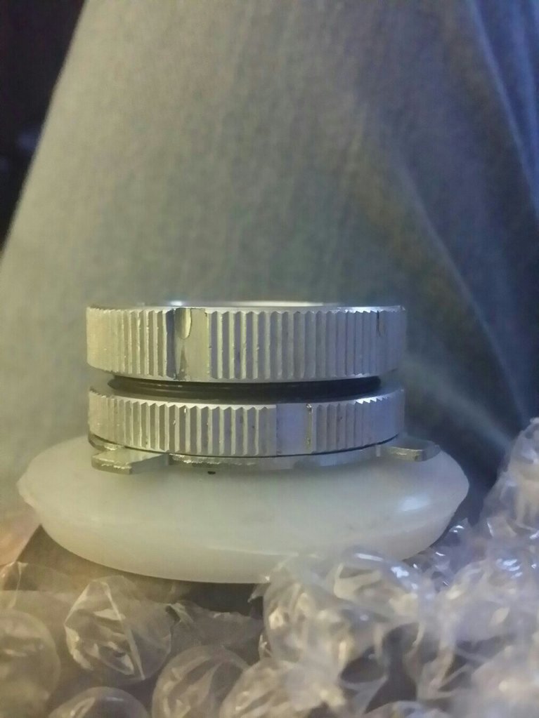

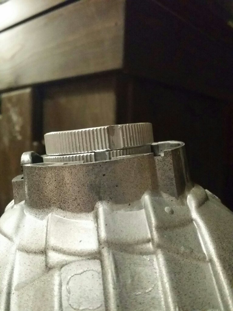

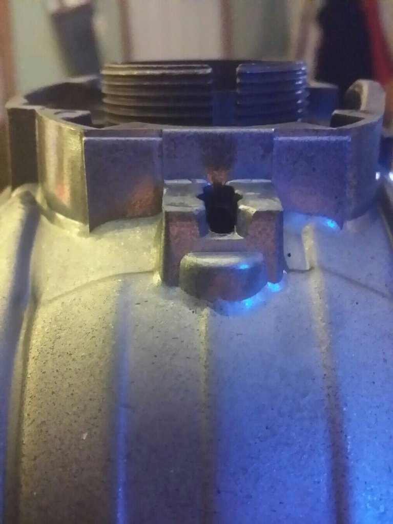

  10. Mar 15, 2014 at 7:00 AM
    #2450
    03is300ztk
    03is300ztk Well-Known Member
    Dec 16, 2011
    #68845
    397
    Zach
    Somewhere in the hills NC
    07 Tacoma 4X4
    Grillcraft, with front and rear bumper/bed in the works.
    D2S 3.0
    Visible threads using silicone washer.
    Without silicone washer.
    Lock ring fully seated and bulb retainer ring fully seated.
    Lock ring and bulb retainer ring just sitting in back of reflector bulb housing.

  11. Mar 15, 2014 at 7:50 AM
    #2451
    tacodane
    tacodane The Slow But Getting Somewhere Build
    May 25, 2013
    #104898
    4,902
    Dane
    2013 Tacoma Prerunner SR5
    Led Interior Lights AFE CAI Stage II, Aero Turbine 2525 Muffler Snugtop Cab-Hi shell TRS Retrofitted Headlights
    I wonder if a thinner silicon washer could be used
  12. Mar 15, 2014 at 7:51 AM
    #2452
    03is300ztk
    Dec 16, 2011
    #68845
    397
    Zach
    07 Tacoma 4X4
    That's what I'm going to try and find. Maybe just some rubber o rings will work. But as is there is no way to tighten the lock ring enough keep the projector from moving in the housing.
  13. Mar 15, 2014 at 7:58 AM
    #2453
    tacodane
    May 25, 2013
    #104898
    4,902
    Dane
    I don't see why a washer that thick is being used.
  14. Mar 15, 2014 at 9:27 AM
    #2454
    Sacrifice
    Sacrifice Motorcycle Goon
    Oct 8, 2013
    #114093
    15,939
    KS
    DCSB OR 4X4 LT
    Pelfreybilt Front Bumper,BAMF sliders, Airflow Snorkel,Mini D2S Retrofits, ADS Rear Shocks, Deaver U402 Leafsprings, 35s, AllPro +2LT
    If you look back a few pages the d2s 3.0 now requires grinding of the back plate where the threads come through in order for the nuts to seat all the way
  15. Mar 15, 2014 at 9:31 AM
    #2455
    TRSJimmy
    TRSJimmy All I Do Is Nguyen
    Jul 10, 2012
    #82308
    3,088
    Jimmy
    Gainesville, GA
    12' Mall Crawlin Peerunner
    I think he's trying to find ways around it. I didn't even bother and went ahead and grinded that thing.
  16. Mar 15, 2014 at 9:34 AM
    #2456
    03is300ztk
    Dec 16, 2011
    #68845
    397
    Zach
    07 Tacoma 4X4
    No I already saw that. But that was just some drawing on a picture. No one has actually shown what it looks like post grind. So I'm not just going to grind away and hope to get it right.
    Measure twice cut once.
