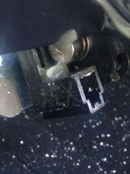

    To those that are finally getting their retrofits and are about to tackle it, good luck! Just take your time and everything will be ok!
    But I want to give you guys a heads up. When gluing the shrouds to your projector, be careful not to put too much. Some can drip onto your high beam motor and you will not have high beams like myself (just the passenger side.) As you can see, the jb weld dripped onto the projectors where the high beam mechanism moves in and out. I had to dremel out just enough so that cylinder can move freely. I made the mistake so hopefully you guys won't do the same :)
    Oh yeah, the customer service from Andrew and the whole TRS crew has been wonderful. I had a problem with one of my halos and Andrew promptly sent out a replacement and I got it within a day. (Does help that I live in the same state :) ) Thanks!

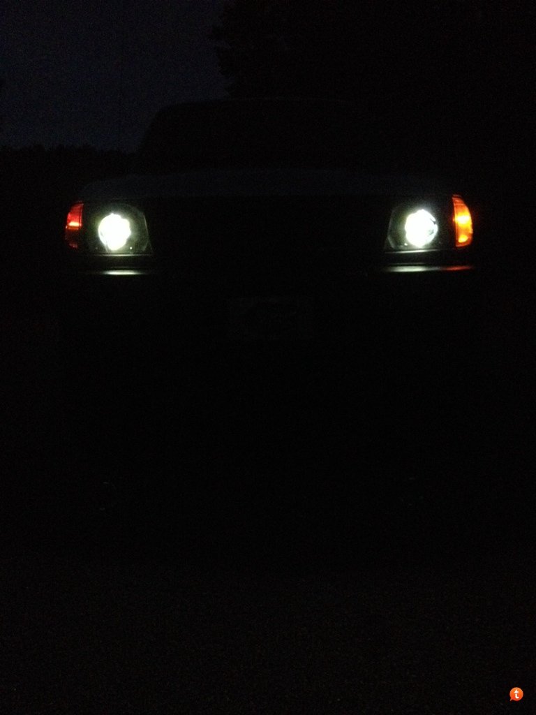

    Check Out My Builds
    Yea I got mine done yesturday, just need to fine adjust it. Man I can see everything! So glad I got these, not too mention they look awesome!

    Toytec Ultimate lift Coilovers Toytec AAL No diff Drop 5% Tint all around Morimoto 2Stroke LEDS High and Low Morimoto Fog Lights MESO Key FOBs
    That's probably what happened on one of mine. Just haven't had a chance to take it apart
