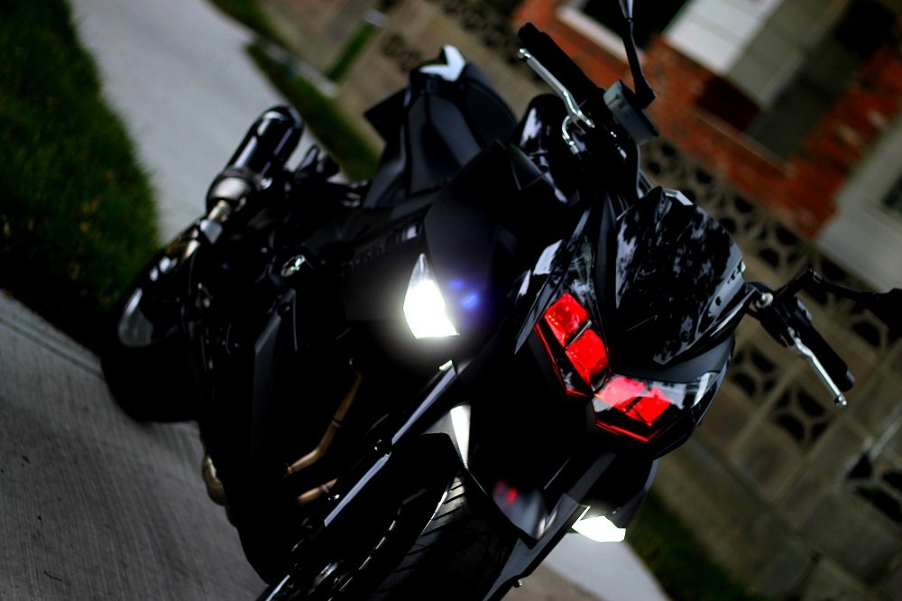

    One of our customers built this crazy 2014 avalon retrofit for his Z1000. Something similar to what I want to do in my truck, but with two sets of projectors stacked.

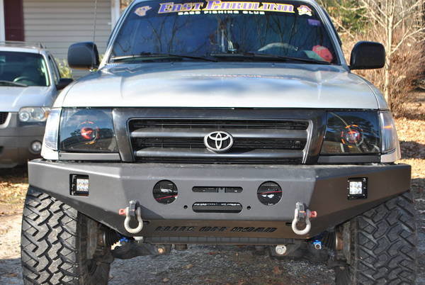

    Inside of my shroud with epoxy
    Ooo Well thats understandable then haha

    The color through vents is given by a halo, you can color the projector, I've done red, blue, and black personally I like red the older styles were easier to paint, the new ones were a bit difficult

    Yes that's natural reflection with all the stuff painted red except for the spring, on my 3.0s I just used a qtip and a paint pen lol pain in the ass but I didn't want to dremel out the little thing to take the lense off
