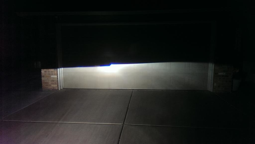

    Check Build

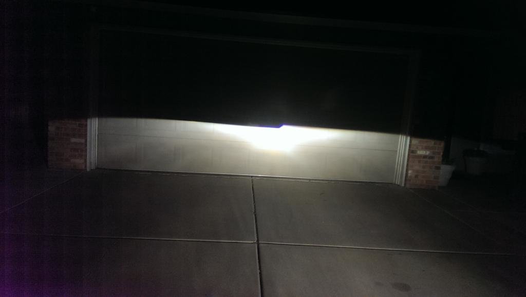

    Hey Andrew or anybody who has some info, what is wrong with my cutoff? I tried taking out the bulb and putting it back in. Did i do something wrong? Is the bulb bad?
    Driver:
    Passenger:
    Thanks

    I dont see anything? Try posting the picture again

    Looks like it's just not seated correctly or something isn't lined up in regards to the cutoff shield inside....

    Hope its not the shield... Everything is all sealed up. Ill try reseating everything tomorrow. Maybe switching over the bulbs and see if that changes anything.

    Looks like your bulb just isn't seated correctly

    Thanks, I'll try taking it out and outing it in again. Maybe I'll try switching driver and passenger and see if that changes anything.

    Make sure to look at the bulb, theres two little knob like thins on it that tend to break off easily, they could be seated correctly then when you try to clip the ballast on it throws it off

    What they all said. Make sure it sits flat against the projectors.

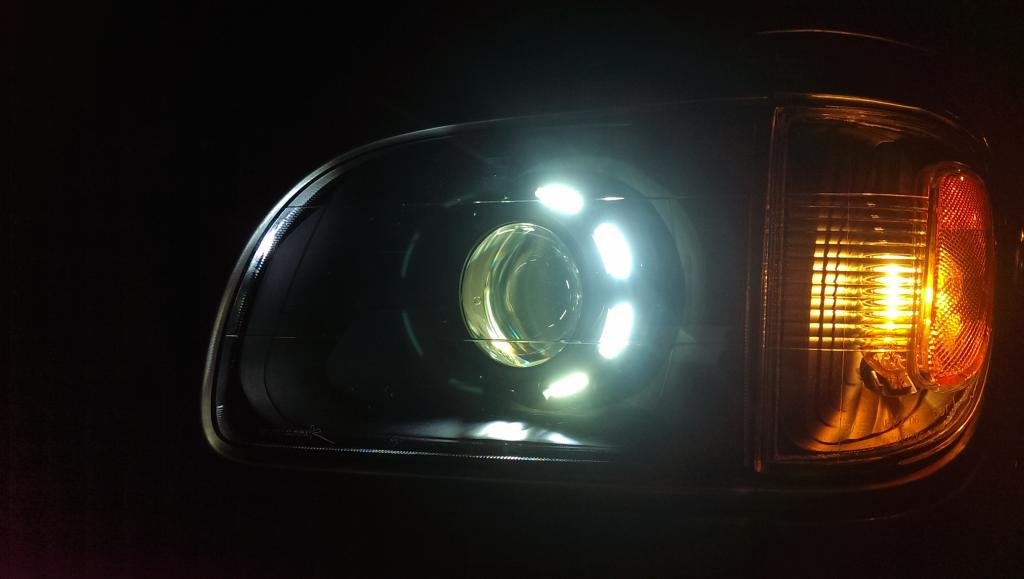

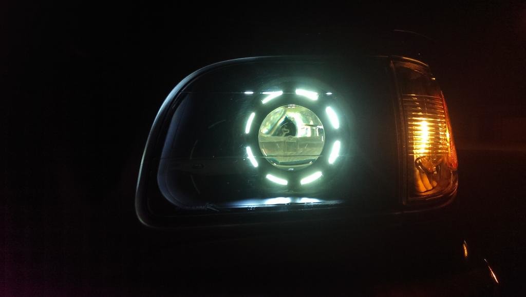

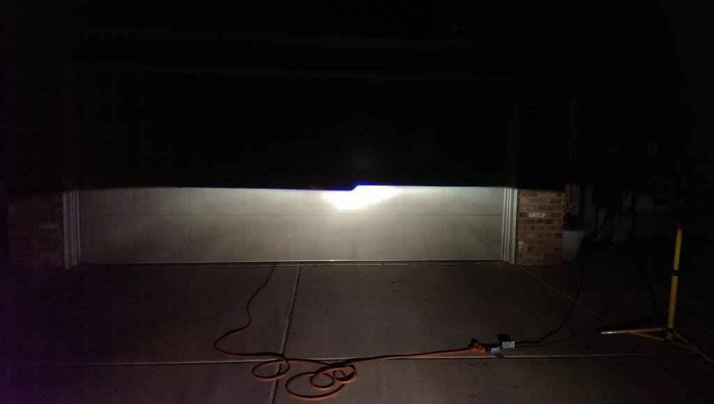

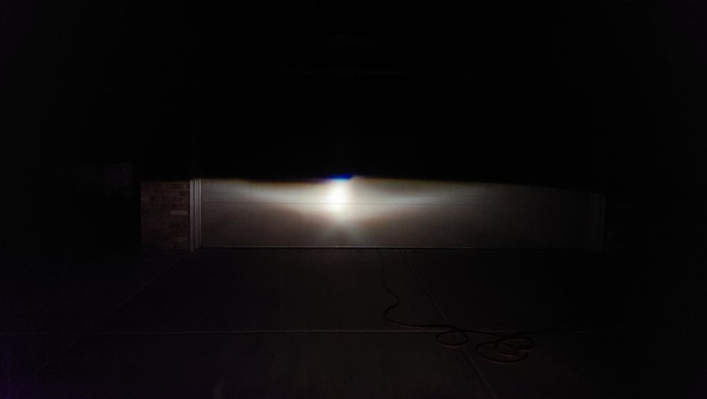

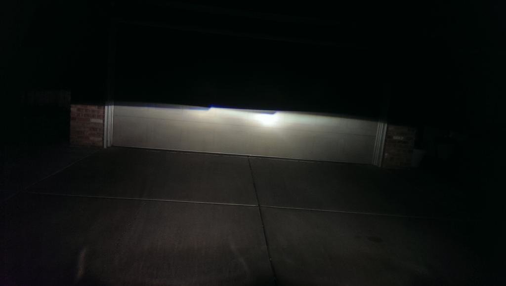

    Just finished reseating the bulbs. I switched the driver side bulb to the passenger and vice versa. Took a couple of times but I got it to where its good enough for me. Thanks for all your help!
    Driver: (First one i did.. Cutoff is angled up a bit, i think is projector is a little twisted or am i wrong :()
    Passenger:
    Together:
    Finished product:
