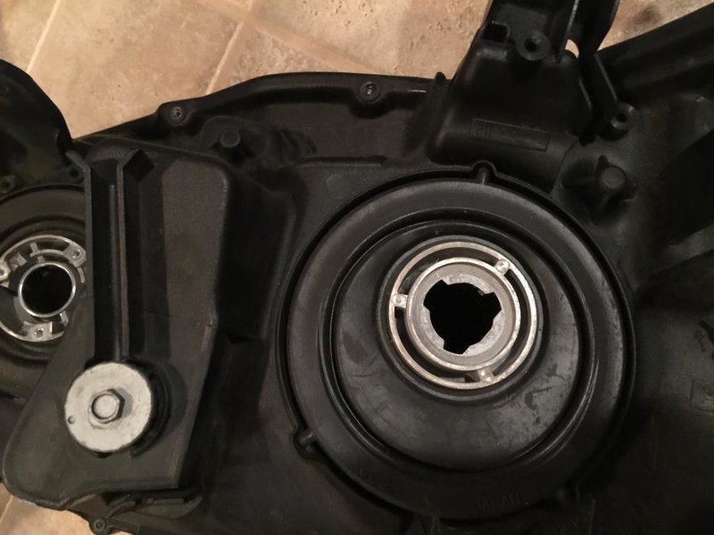

    Nightstr
    Nightstr Well-Known Member
    Dec 24, 2009
    #28125
    5,373
    Felipe
    Sacramento CA
    05 prerunner sr5
    BLHM BLWM 3" TOUGH COUNTRY LIFT TRD SEAT COVERS THULE RACK M/T KM2 265/65/16
    Does any one know what I have to do here. I'm putting d2s mini 3.0 in a 5th gen 4Runner but not sure if I need to just bore out the inside of this hole or trim it all down. Any help would be much appreciated.

  19. Jan 22, 2015 at 8:36 AM
    #3419
    TRSAndrew
    TRSAndrew [OP] Instagram: @apissues Vendor
    Jan 3, 2012
    #69858
    3,348
    ATL
    ‘22 4Runner, ‘14 F150, and I’ve had 4 Tacomas (‘12, ‘15, ‘16, ‘18), 2 FJs
    Basically just bore out that hole big enough for the Mini D2S 3.0's threaded shaf t to pass through. It will still bolt on.
