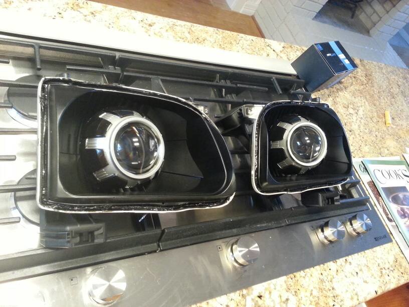

    Looks like I'm going to have to trim at least half an inch off the Orbit shrouds to fit for me. They are huge!

  18. Feb 13, 2016 at 6:54 PM
    #4418
    gray223
    gray223 Well-Known Member
    Nov 6, 2013
    #116062
    3,439
    SE Missouri
    2014 Tundra Limited
    Looks good!

    Thanks. Those Orbit housings are freakin massive. Took a lot of trimming to get them to fit
    gray223[QUOTED] likes this.

    But worth it! Looks great
