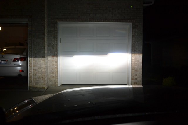

    Does anyone know how I'm supposed to get this jagged edge out of the cutoff line?
    I got the lights at the same height now (after this pic) but I want it to be a straight cutoff line, not jagged. any help?

    Lower the right one and aim it slightly to the left

    That's (kinda) what it's supposed to look like.
    The cutoff is below centerline on the left, and slightly above centerline on the right.
    This prevents oncoming drivers from being blinded, but it casts more light farther on the right shoulder to help see animals, pedestrians, and turning vehicles.
    Just lower your right headlight to align the low and high cutoffs.

    No.
    That will result in the beams crossing and oncoming drivers will be blinded by the right housing.
    The center of the cutoff should be EXACTLY centered in front of the housing.
    If the bulbs are 60" apart (Tacoma is somewhere around there, not sure exactly), then the cutoffs should be 60" apart as far out as you can measure.

    Well that makes sense. I already lowered the right light, it was just after the picture. Thanks Rich

    I meant the other left :p

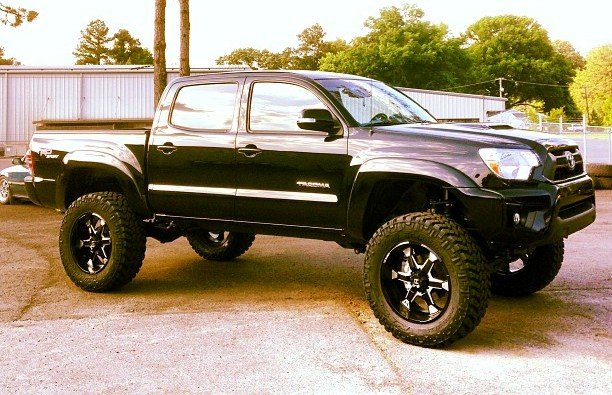

    I am personally glad that TRS does not make you have more than 100 post because I am new to TW and honestly found out about you guys off researching discounts for h1 retrofits. I am very happy I did find out about this forum cause I recently bought a new 13 tacoma and have found a lot of useful info off the site. So far this is my truck its still a work in progress. hope you guys like it!

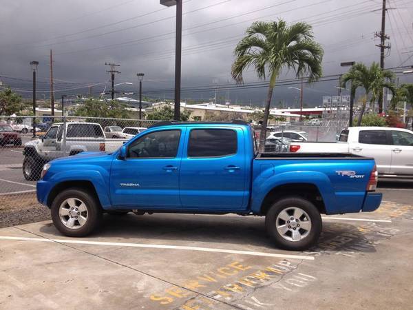

    X2, Just became a member... recently purchased a 2011 SWB DC from another member, still have a 2010 DC Prerunner that I will sell once I redeploy. But just looking at all the threads I have a lot of plans for the SWB when I get home!!

    ummm...ok still need to figure out how to put pics on here :D

    The copy location didn't work, I have a mac so not sure if thats why. I guess I'm gonna have to check out this photo bucket thing...
    This is the new baby...

    Mmmm... speedway blue.
