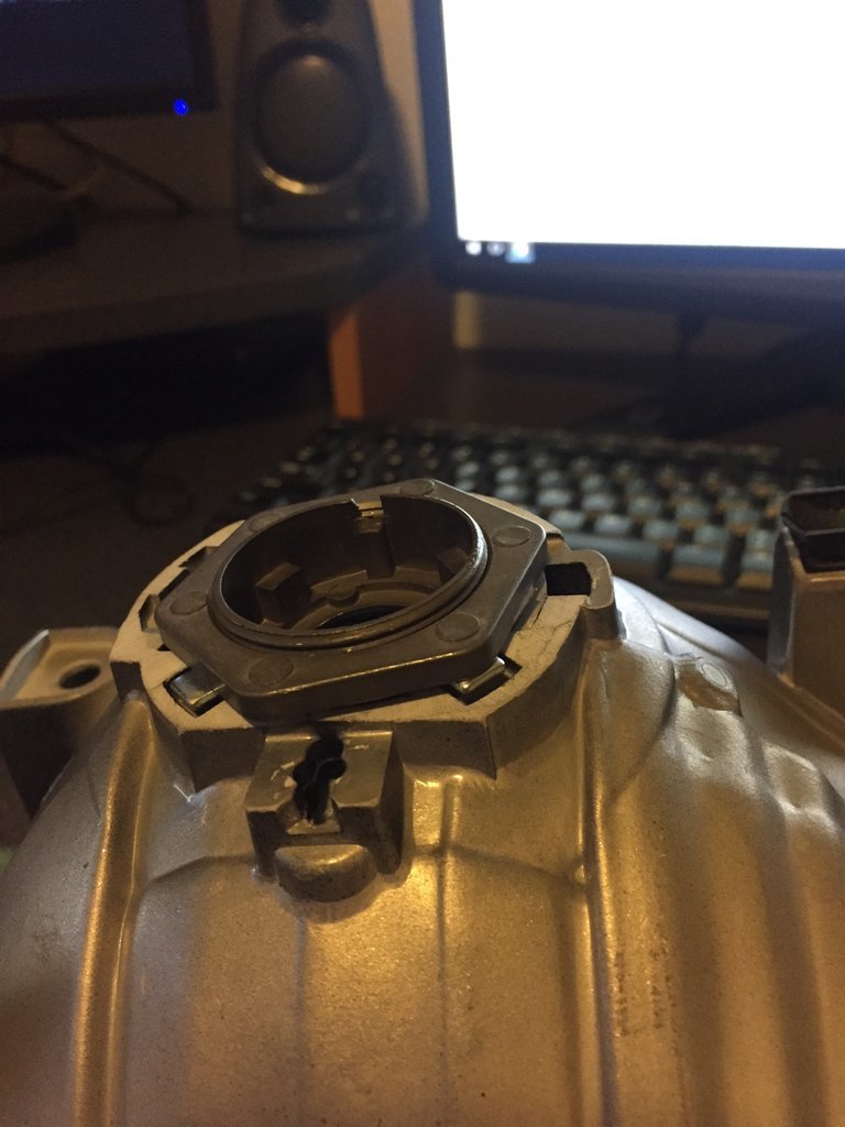

    on the 2010 tacoma headlights how much did you shave off the back side? I shaved mine down just barely so the Y washer would fit but i have like no threads out the back side.

    @gym_jamz do i need to sand it down farther? thats finger tight and had to get pliers to take it back off @deeezy

    We have different style housings, but I didn't use that bumpy ring. I followed the "how to" from the other thread exactly.

    did u have the ring that fit guides the projector on u can see the edges in my picture its a washer with 3 flanges on it. I dont see where i would use the extra ring either.

    I didn't use the washer/ring with the 3 legs. Just the big hex nut that I jb welded on after I set the cutoff. Then the bulb retainer nut with the spring (if you have the D2S kit too).

    yes i do. I left some housing on there to use the 3 leg washer but i dont think you can. SO now im gonna sand more off. No big deal. Just not doing anything tonight.

    That's just another lock ring for your projectors. The hex ring works better.
    Pretty much what deeezy said. You'll need to sand it down futher; enough so your bulb retainer can thread on. I would just go ahead and shave all the flange off.
    The H4 adaptor (ring with 3 prongs) is not required since you shaved the flange off. Besides, Toyota mount their h4 slots slightly off to the right for some reason so the adaptor wouldn't work anyways
