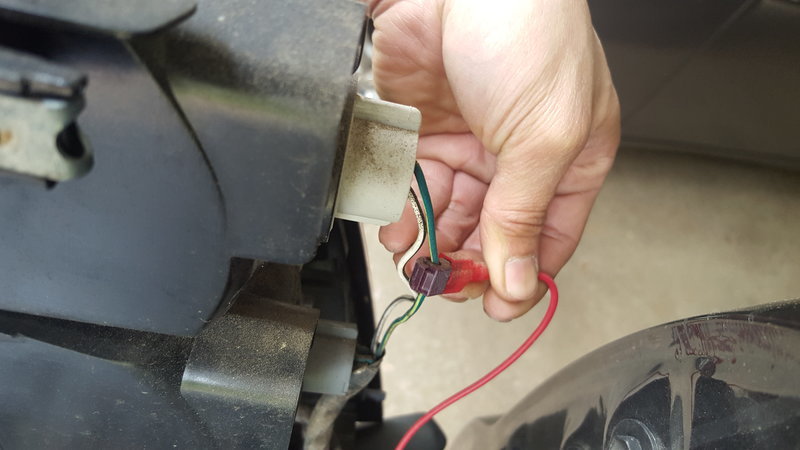

    Interesting...it's whatever the top connector is. Mine is green with yellow stripes
    Example
    BTW you don't need a 9v to test solenoid. Any 12v source would do; car battery etc. A 9v is just smaller and convient lol

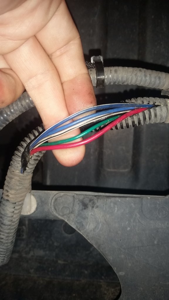

    Hm very interesting indeed. I was wondering if there is a difference in wiring for the older tail lights vs newer LEDs, but I see that you have a new truck with the leds as well. Pic immediately below is drivers side, then passenger below that.
    The red, green, and blue wires are solid colored and there is a white with a black stripe. These four are on each side. The difference is a solid yellow wire on drivers, and a blue with white stripe wite on passenger.

    Hmmm I guess the only way to tell is test it out with a voltmeter. That's a lot of wires though? Is that right at the bulb connector?

    The other way to test it is to just do it and hope it works:D And luckily, it worked! Both halos functioned properly in normal mode and when the blinkers were turned on!

    :woot: sweet man! Which wires was it again? Would like to know in case someone else needs help.

    For my 2010, I tapped into the solid yellow wire in the drivers side tail light harness, and the blue/white striped wire in the passengers side tail light harness.
