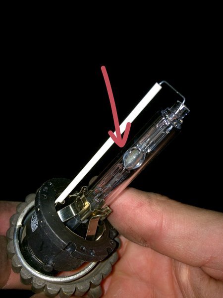

    So my passenger light doesn't work and I'm thinking it's the bulb, I didn't think they'd go out after about 2 years. I cleaned out all connections w/ electrical cleaner but haven't bothered to switch bulbs from the driver side cause I'm lazy.
    Does this look like moisture got in or..?

    Might be able to see moisture a little better if you zoom out more

    Ask the dealership, I'm betting your "moisture" is a 14k new eletrical harness for the entire truck.

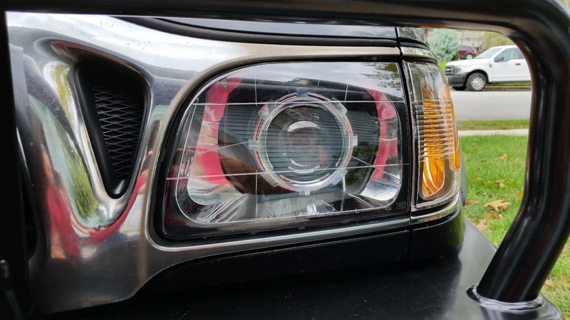

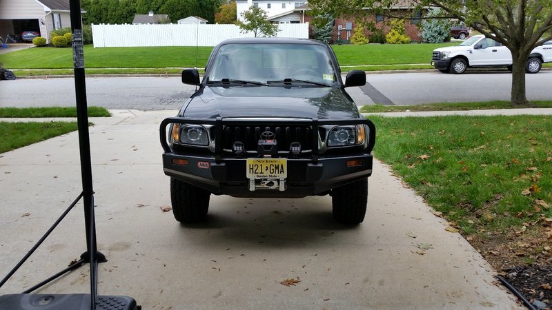

    Just did my Mini D2S 4.0 retrofit today. My first retrofit so I don't have anything to compare these to but they are awesome! Still got a few small adjustments to work out and then I'll post up pics and output shots tomorrow night. The high beams are insane, offroad lights are pointless now. My only worry is that I'll have to aim them pretty low in case I put a lot of weight in the bed.

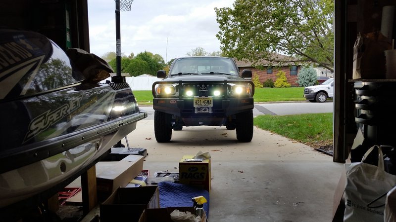

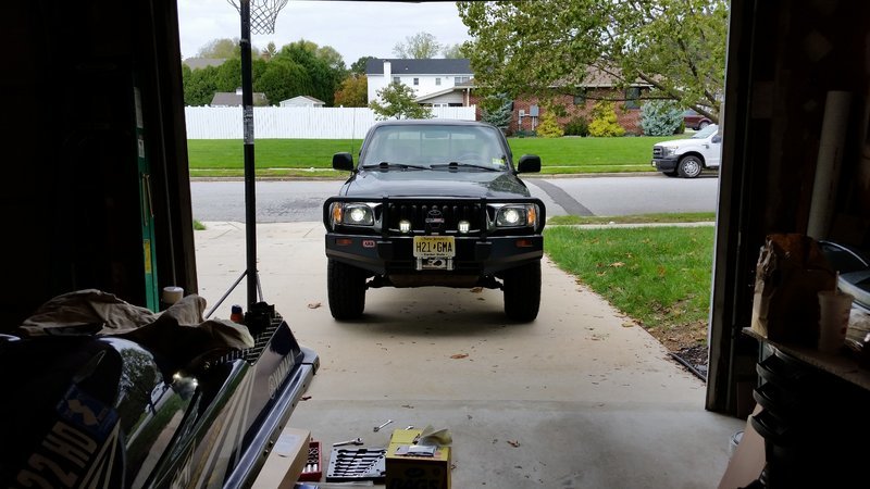

    20161016_113029.jpg 20161016_113015.jpg 20161016_113307.jpg 20161016_113313.jpg
    Here's a few daytime pics
    D2S 4.0 with the 35w ballasts and 4500k bulbs. Gatling gun 1.0 shrouds. Fogs are JW Speaker 6150.

    Looks sick!! good job, tough to install?

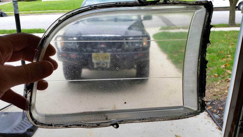

    Install wasn't too bad. Worst part for me was dragging that heavy ARB bumper and winch off the truck to get to the grille.
    For my first retrofit, I think it went pretty well. I just used a heat gun to pry the lenses off. I bought a cheap set of replacement headlight housings from Amazon and used their lenses on my stock housings.
    The aftermarket housings had a ton of play in the mounts and adjusters.
    I started the install around noon and finished everything by the time it started getting dark.

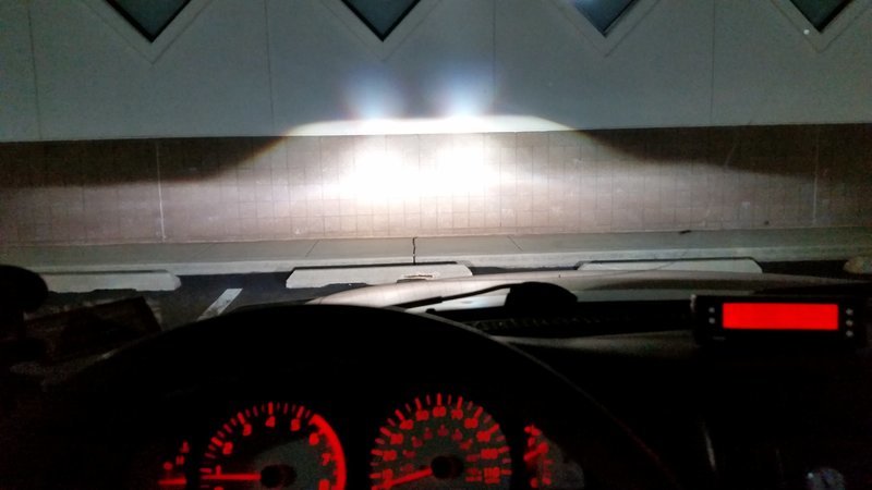

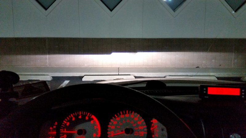

    A few night shots. Still gotta fine tune the adjustments.

    Looks normal to me. I would swap the bulb to the other side and see if the problem follows. Let us know what you find out and we'll take care of you!

    Yeah definitely need to test that. I was gonna say screw it and just order new bulbs anyways. The picture is how it looks, kinda like a green bubble but I can't base that on anything cause I haven't bothered to look at the drivers side.
  20. Oct 17, 2016 at 2:29 PM
    #5120

    For sure. Swap them and let me know what you find out! I would hate for you to purchase new bulbs and it doesn't fix the issue! We'll take care of you!
