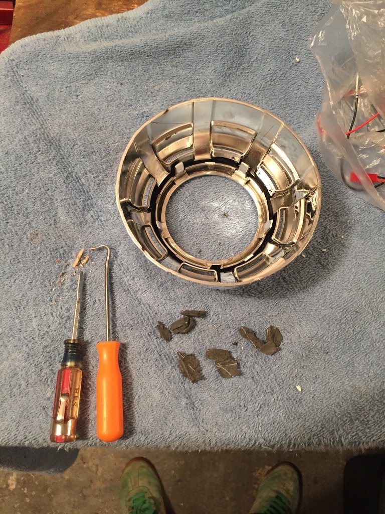

    257E5786-60A9-4D20-9867-D392E92C8C3A_zps_287eb305b925b5899c47cc99868e68268cb74ed1.jpg
    Also, I got the halos off with no issue. Just used a little pick and small flat screw driver. I guess they werent prep'd too well. Lol.

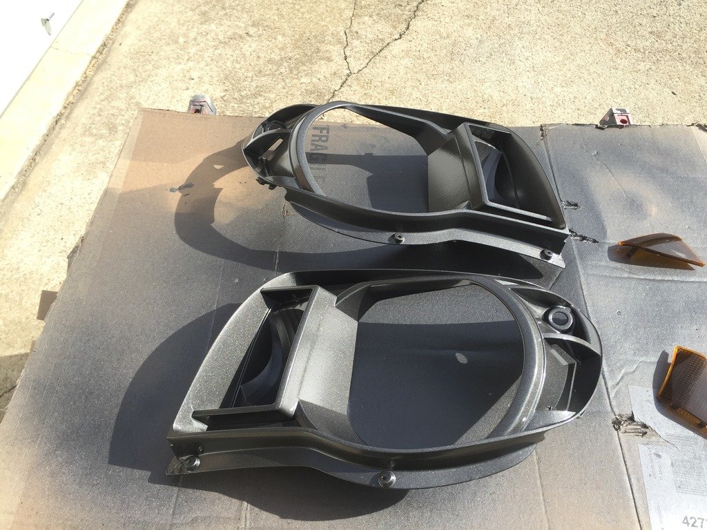

    Progress.
    6C2DABF9-22AD-48B0-8D53-FD2FDB3ED525_zps_4846e3c5fd91d510cf52c3532e9851b34c314312.jpg
    2F5BCDB2-1338-4893-86BA-43B08E9D2BB3_zps_205737a143dc0ce0f303b15fd702c787db67aa31.jpg

    what color/kind of paint is that on the bezel?
