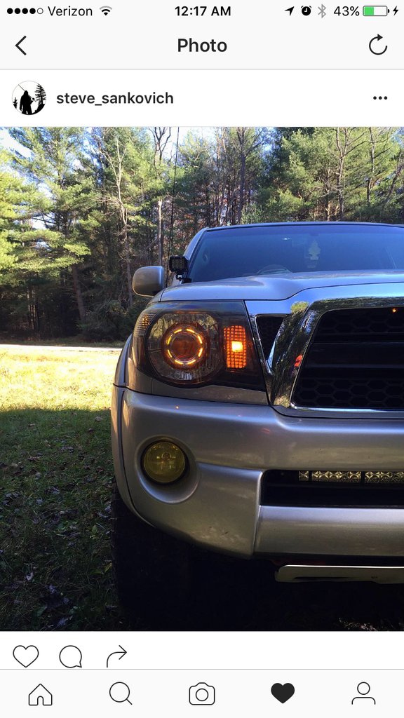

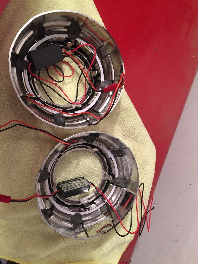

    Swapped in some 100mm halos.
    1CF4EC98-5811-445B-A8C7-AA049AC750F5_zps_17711e1815a7691946a2847383c195f9b44d14bb.jpg
    42445B10-EB84-4EFA-BC0F-59EAD20F67F4_zps_5a910982de6b12143b203fac017ac830dd14b249.jpg
    Mucho bettero
    Also, mounted my shrouds with JB Quick Weld. Letting letting everything cure overnight then sealing them up tomorrow.

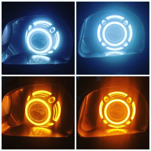

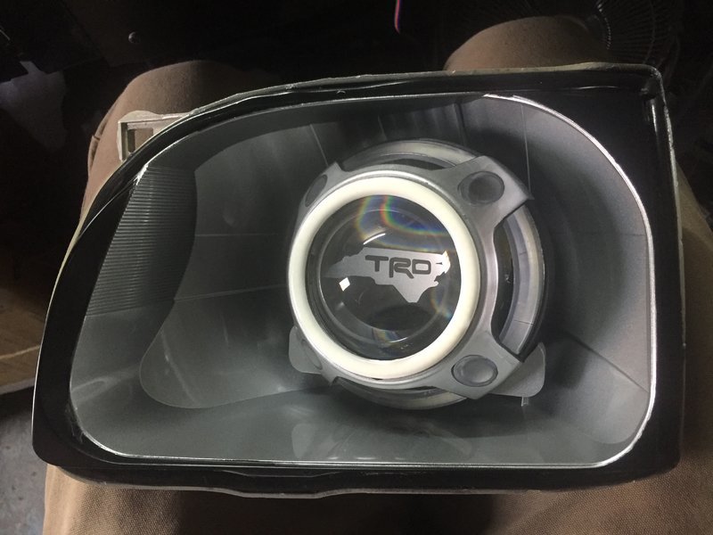

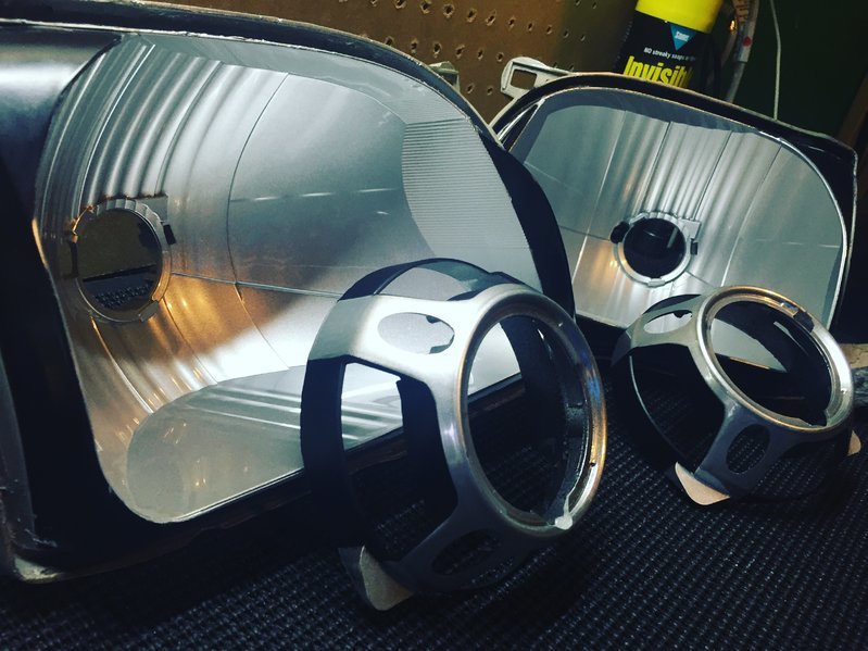

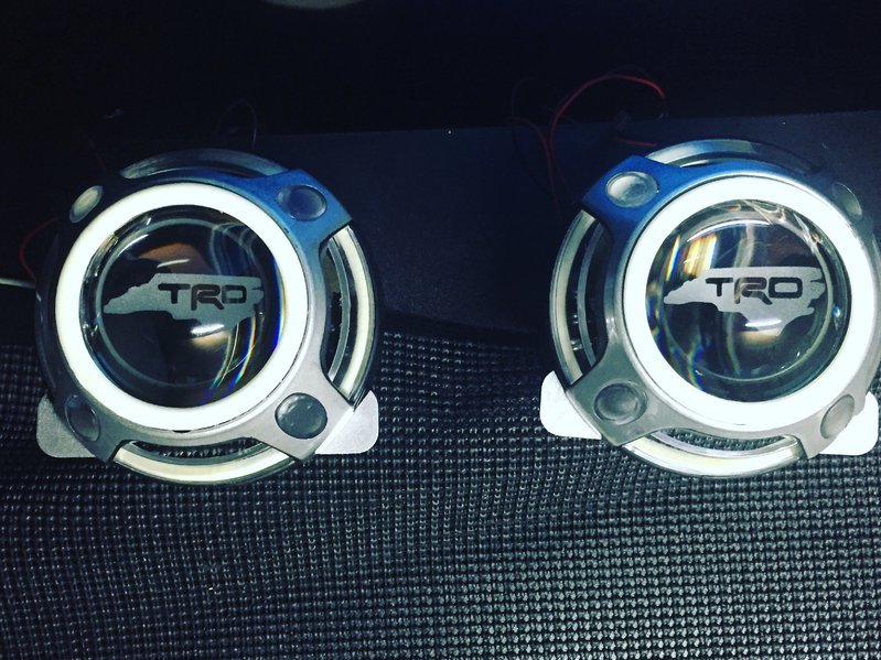

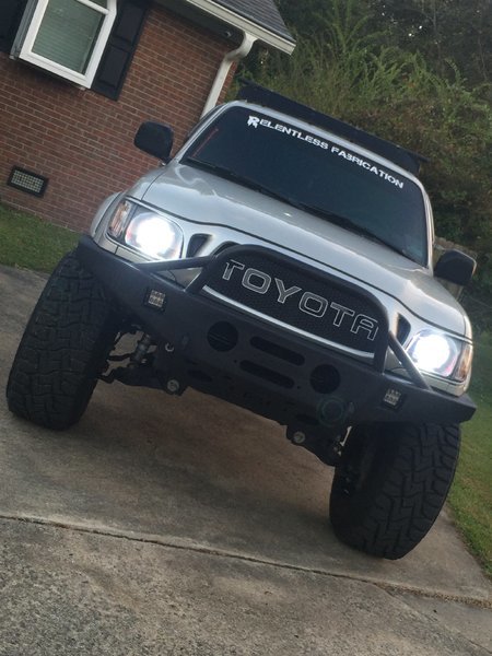

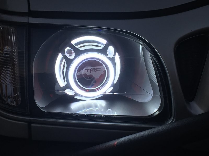

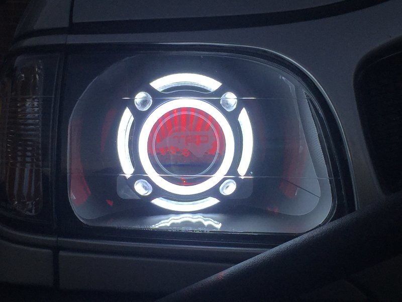

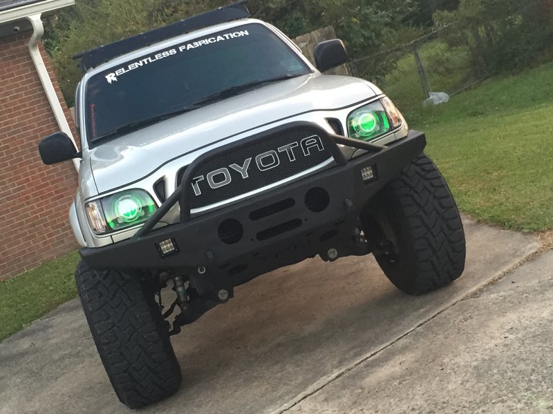

    I have a method I do on all my demon eyes of you want to message me. On another note ...finished up my new personal setup. Also got color changing demon eyes but not shown in pics

    Did you paint your halos? Hard to tell in the pics but they don't look chrome. I thought they all came with a chrome finish.

    Snap due halos?!

    Also who did the etching cus that is sexy

    I didn't paint the halos. But I did paint the shrouds
    Yea man love them
    @TRSAndrew does the etching for me man!

    Hah. I was thinking shrouds, but typed halos. They look good though.

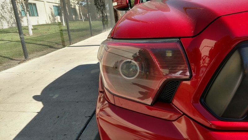

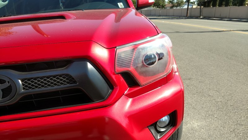

    I run into this after a week or two and i think that i did sealed them good but seems that i did not. I did use the housing sealant.
    The question is, can i fix this without having to open headlights? Or the only way to fix is to reopen them?
    Both headlights r the same but one looks wors cause the way i took the picture to show the fog/condensation in themIMG_20161102_131804854_HDR.jpg IMG_20161102_131748107_HDR.jpg

    You need to open them up. Let them air out, mount some silica packets in the housing and reseal with morimoto butyl from TRS. Make sure to lay the sealant evenly and aligned in the housing

    I dont want to open them again. But if its the only way ill do it.
    I did use the sealant from the TRS to reseal them. Maybe i didnt spread it evenly.
    I went and ask a few stores for some silica but seems they dont carry that. Seems that only online is where they sell them.
    Is there a particular store that do carry them so i can go get them my self?
    U think that a couple small packages of silica on each headlight will be enough? Small Like the ones inside a box of brand new shoes.Of course after i do the fix.

    Amazon sells em. Or buy a buncha beef jerky!
    I saved all the ones that came with my retrofit parts and used them. I added 2 packets in each light.
