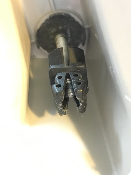

    When removing the reflector bowl, do the adjustment screws need to be fully backed off? I was going to do that, but the reflector is tilting up into the top of the housing before the screw lets go.

    Yes back it all the way out. You have mess with it a lil. You'll have to back one out then the other. You have to back the screws out to be able to pop the black connecter out.

    ^Thanks! Really trying not to break any more plastic pieces. :annoyed:

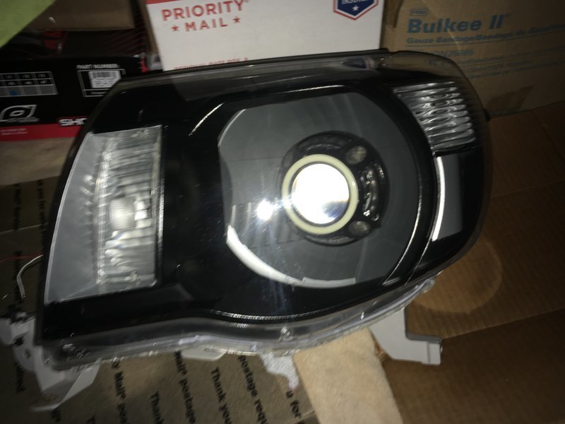

    Worked on mine today. Have been waiting on rgb demon eye to finish up. Thanks TRS for the help.

    Did you have to trim quite a bit off your shrouds?

    THose look good.

    Thanks and no I didn't trim them at all, I might have a 1/4 inch gap between shroud and bowl. I also was worried about it. The back nut seems to hold it all together pretty snug. I'm just waiting to bake them and wire up. I'm afraid to f them up in the oven!

    He didn't have to trim because those are the led panamera shrouds. If you get regular panamera shroud you will have to trim some

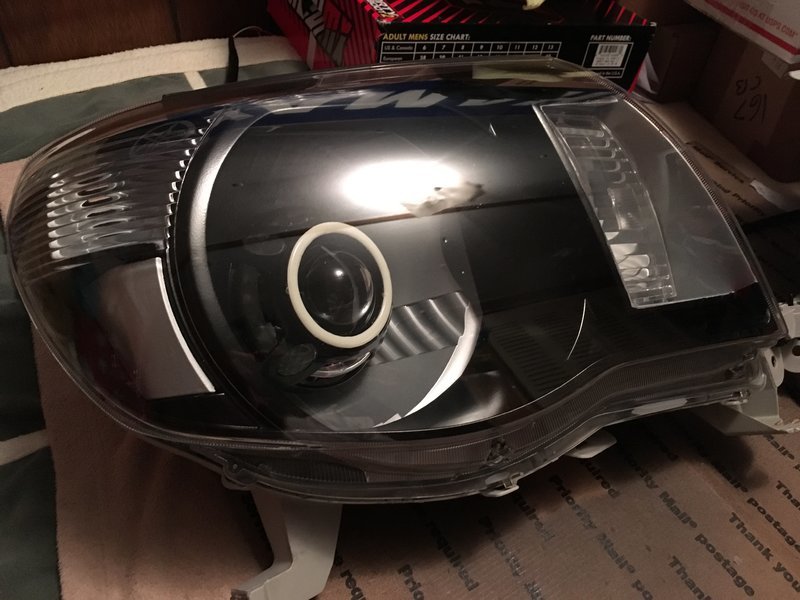

    Alright, got everything need. Halos. Ended up getting sent out, picked up a pair of oem head lights for $60. I'm thinking semi gloss black and clear coat for the bowl, but I can't decide to paint the shroud black or leave it chrome. It's the apollo 3, any opinions?
