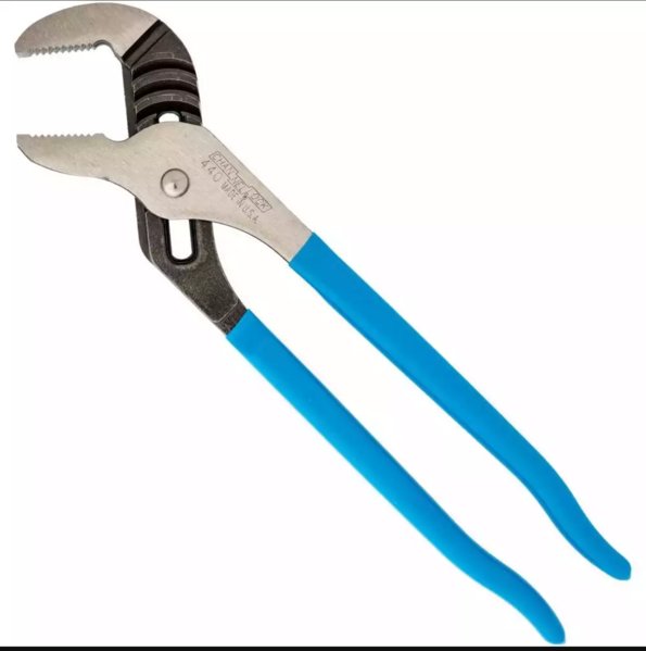

    The first time i did mine just went with hand tight. But the problem i found is that every time i had to removed the buld it will always move out of alignment.
    And then i had to reopen my headlights cause they got condensation on both. And im in the middle of finished it. Not done yet. But this time i used this type of pliers. First i did was hand tight then the pliers like half circle. I did tested removing the bulb a few times and seems to work really nice. Didnt see misaligned of the light.

    I just hand tightened them really tight. Kinda forgot to use pliers at the end haha. I didn't JB weld them incase I needed to take them apart or something. Also the washer is meant to deform so it is always tight

    Well that was another opcion aswell. But seems that its not necessarily. Seems that with plyers its tight enough so that it wont move.
    I was thinking of the jbweld to the locking nut. But since i had to reopen my headlights i redo pretty much everything. And seems that for me no jbweld ia needed. Seems that with the plyers was enough.
