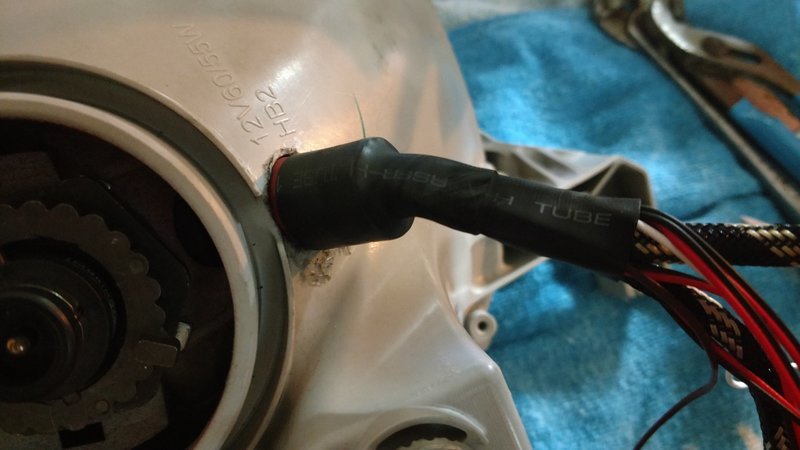

    What is everyone doing with their high beam wires? I see some drilling a separate hole in the housing but I was just planning on running it through the hole in the housing that the factory rubber boot goes over along with the bulb and ballast.
  8. Mar 9, 2017 at 8:08 AM
    #5588
    WildLand
    WildLand Does Ursus arctos defecate in deciduous forest?
    Dec 16, 2012
    #93212
    10,487
    Josh
    NM
    16T4RSR54WD
    I ran them through the little holes where to bulb cover was. That way the wires don't pinch when you put the metal washer on and stuff

    I did that for running the wires through the reflector, but was wondering about the headlight housing itself.
  10. Mar 9, 2017 at 8:31 AM
    #5590
    Santanero714
    Santanero714 Well-Known Member
    Apr 1, 2016
    #182972
    84
    If u only have those wires, just run them trought the rubber boot. So that u dont do any holes to the headlights.

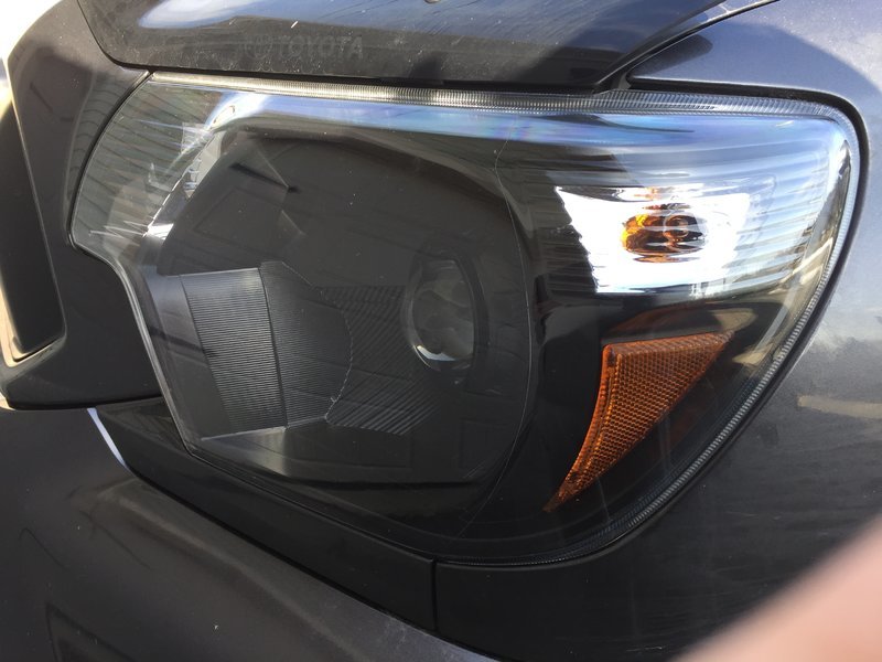

    Projector retrofit finally completed. Still need to tweak the alignment but output is pretty damn good. The high beams are insane. I ran out of time yesterday and didn't install the bolt on the lower arm of the headlights and have a little bit of jitteryness over rough surfaces and the lights are a bit loose too. Not sure why some people say you don't need to bother putting that bolt back in. I'll be putting it back in tomorrow when it's supposed to be slightly less freezing outside. And of course a few shitty cell phone pics...

    Those turned out nice. That lower "hidden" bolt is 100% necessary like you mentioned.

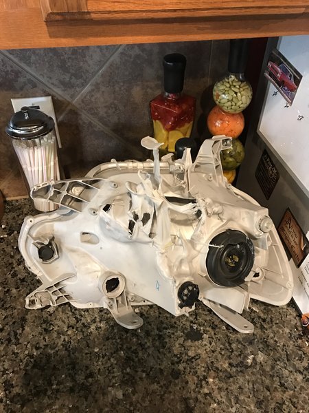

    275 for 7 min melted my damn light....
    Tacomalx4x4 likes this.
  20. Mar 16, 2017 at 10:56 AM
    #5600
    WildLand
    Dec 16, 2012
    #93212
    10,487
    Josh
    NM
    16T4RSR54WD
    Oh hot damn.
    Did you have it on a cookie sheet or cardboard?
