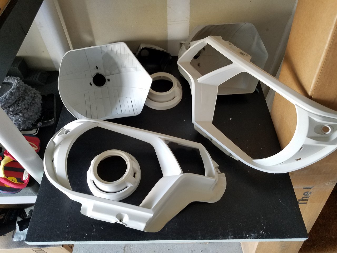

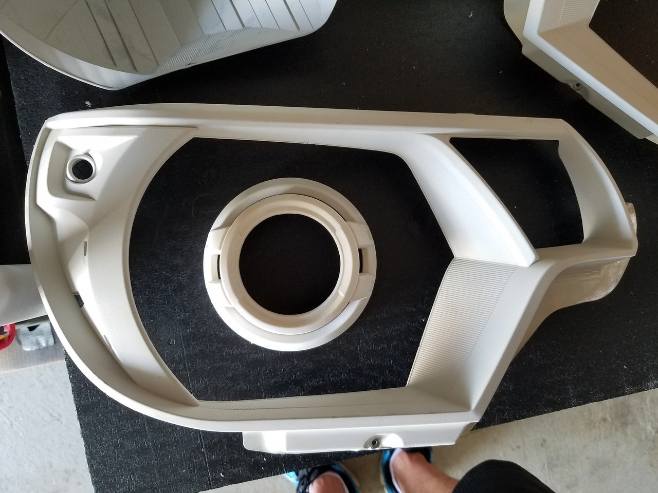

    Sand blasted the chrome parts and got them ready for paint. Can I use isopropyl alcohol 70% to clean the surfaces before spraying them with Krylon Fusion spray paint? 20170702_165003.jpg 20170702_165016.jpg

    Nice- opening mine tomorrow. Yes you can, Acetone would be my first choice though. Unless you already have Primer on it, not sure what the white is. If you have primer on it use the alcohol 70%

    Rubbing alcohol works well for prep, same does Windex.
