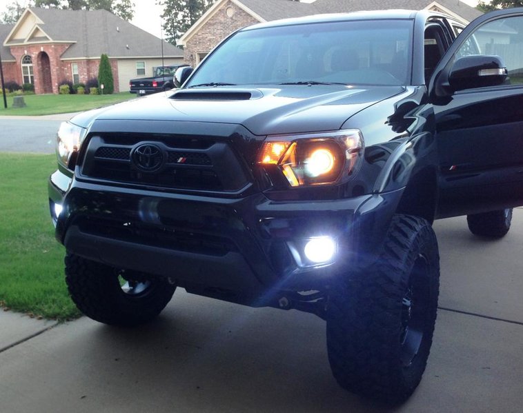

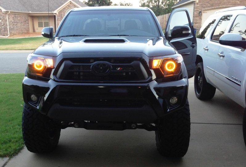

    Just finished mine this weekend Thanks Andrew!!

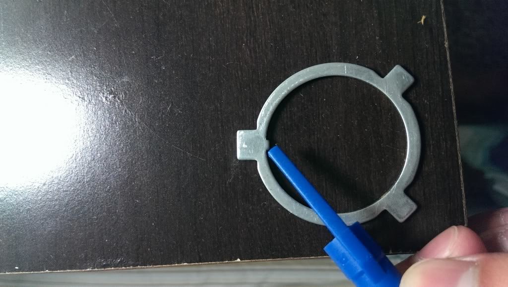

    Looks good! What did you do for the centric rings? I've heard they don't work on the '12s and up.

    You just have to grind the tabs a little in everyone about a 1/16 to 1/8 of an inch and they will line up just fine!

    Not quite following, do you have a picture?

    What he's talking about is the metal adapter ring for H4 lamps, the inner of the ring should be completely circular with the exception of a small "tooth", grind some of it off and it will line up, grind too much and its gonna turn without stopping, thus making alignment a bitch. Send you a picture tomorrow.

    Or here are pictures, I'm bored plus I'm sure gholcomb don't wanna take his light apart for the pictures.
