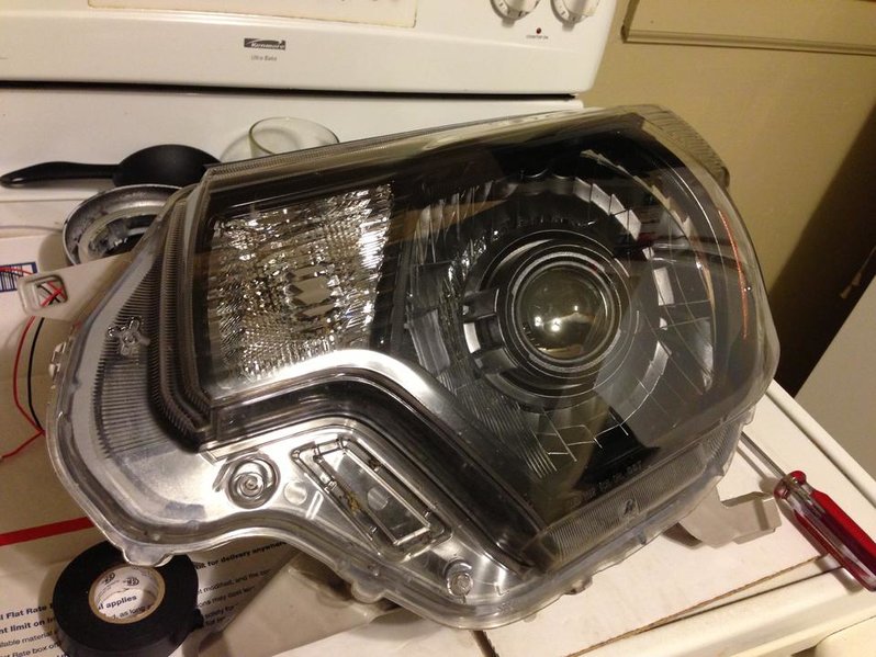

    Thanks! Figured it out once I fired it up in the truck last night, that cutoff line is wayyyyy off. Sealing the first one today and finishing the other one tonight once it gets dark.

    I actually didn't grind the inner tooth off I ground off a 1/16 to 1/8 inch off the three teeth on the outside so the inner ring would still be functional. All I did was lay the ring on the back of the light where I thought would be straight and marked it with a sharpy. I used a grinding wheel to grind them down. Then you assemble the light and test fit them to see if you got the lines horizontal if not repeat the process. Just a word of advice is to take your time and don't rush it cause you don't want to have to pull a redo. Hope this helps guys!!

    This is what I did. Doing #2 in a few hours once it gets dark out.

    Finished my D2S install tonight. Just need to aim them now to get the cutoffs perfect.

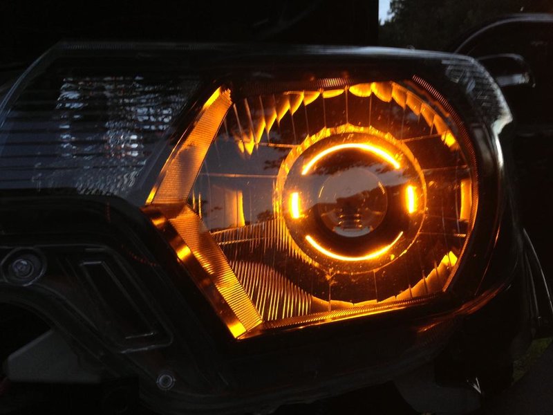

    ckeene9 your lights look awesome! got a question for you though...when your headlights are on, is the orange still quite visible?
  9. Jul 1, 2013 at 6:33 AM
    #589
    ckeene9
    ckeene9 Well-Known Member
    Sep 20, 2012
    #87325
    10,848
    Chesterfield, VA
    '12 DCSB Supercharged 4x4 TRD Sport
    See Build Thread
    I don't know as I haven't wired the halos yet. But I'm thinking of wiring to the DTRL which I believe will cutoff when the headlights are on.
