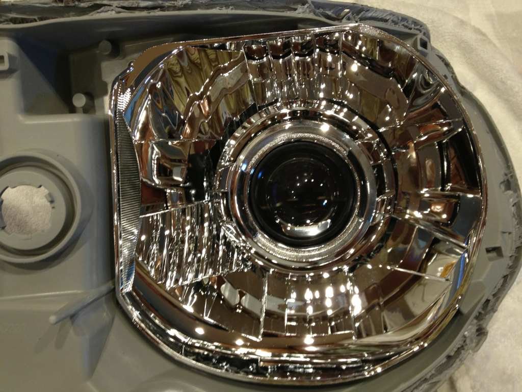

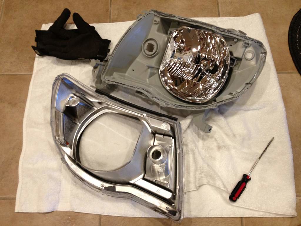

    Installing mine now. It took about 5 min for the housing to separate after pulling it out of the oven, with me going around it with a cheap screwdriver (yes, use one you will throw away). Then there is a good pry point at the bottom corner, closest to the grill. Get on there and just apply light pressure, and after a few seconds, the goo will start to release, and you can eventually get your fingers in there and pull the whole thing apart, releasing tabs as you go.
    Already got the projectors installed, solenoids tested with a 9V battery, and shrouds epoxied in with JB Weld. Pretty much done for today I think.

    Haven't aimed the horizontal yet. There is play in the locating ring (one that has the tabs on it, like a regular halogen bulb does) and the projector threads. So far, I just eyeballed them to line up with lines in the reflector. If they are off, all I would have to do is remove the connector, the gasket, and I should be able to grab the back of the threaded nut that holds the bulb in, and rotate it. Hopefully I won't have to.

    Yeah, I thought I'd go drop in on my first retrofit. I think I've got that projector in there nice and tight, so hoping I don't have any movement.
