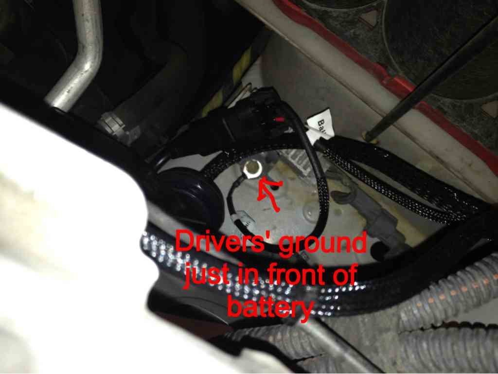

    Well, after a lot of email exchanges, I think that my ground was probably okay in that location, however, I'm glad I moved it to a real ground point anyway.
    It is a little weird, but when I swapped the ballasts, I did not seem to notice the flickering, which is why we thought the ground was bad. Maybe it's just that I couldn't see the passenger side very well, as the flickering is a lot easier to see when you are pulled up to a car.
    Anyway, I changed the ground, then swapped the ballasts back, and the flicker was still there. They think the ballast is bad, so I'm eventually going to get a replacement, when the weather is a little better.
    I was having an ignition issue on the passenger side, and that ballast D2S connector seems loose, compared to the other one. It would only ignite maybe 1 out of 5 tries. TRS suggested to make the center contact smaller. There is a small rubber boot in there, that is yellowish-orange. I pulled that off with needle nose pliers, then you can see a circle of orange plastic in the center, and inside is the contact for the bulb center pin. It is shaped like a "C" with little points on the inside that make contact with the bulb. I then took a small flat blade screwdriver and carefully bent the ends of the "C" shaped contact in a little more towards the center, so that it makes the semi-circle tighter (thus, it should make a tighter contact with the bulb pin).
    So far, it's only been a couple days, but I haven't had an ignition failure yet. I'm going to wait a few more days before I cut the cable on the other ballast, to get it replaced, just to make sure the other one is reliable.
    So that might be an option for you guys if you are having ignition issues.
