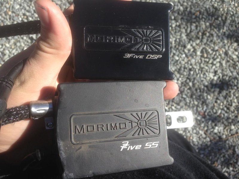

    After 3-4 days of testing the 3Five DSP's, the only issue with mine is during vehicle startup. If I have the headlight switched to auto, then 90% of the time, they ignite, but fail to stay on after the engine is started.
    They have so far always ignited and remained on if I turn them on after the engine is started.
    Flickering issue is completely gone. Been right at freezing here for about a week.

    That is not uncommon.
    They need a fair amount of current and the starter pulling the battery voltage down can cause them to un-start.
    Not sure if the Tacoma is wired as such, but use your parking brake and the headlights may not ignite until after the brake is released... a lot of vehicles work that way.
    The lights will come on with the brake set if you just turn them on, but if you are running them in "semi-auto" mode where you did not shut them off when you last parked, they may remain dark.

    I understand that about the battery voltage being pulled down. The headlights in the Tacoma are pretty dumb, actually, at least, for the '05. When they are in the ON position, they come on instantly as the ignition switch is moved to the II position, I believe, no matter where the parking brake is. They stay on after you remove the key, until you open the door.
    I'm just disappointed that the SS ballasts did not have this issue at all. I generally leave my lights in the on position in the winter, because its usually dark when I leave and return from work. Will be annoying to have to always turn them off and on again.
    I'm kind of surprised a change on the headlight side of the ballast design would change what I perceive is an input power supply issue. Seems like there needs to be more input side filtering to prevent the voltage from dropping so much, but I don't really know anything about the design of these ballasts.
    I don't know if TRS sees this as an issue or not, I haven't heard back from them yet.

    Colder weather, you are going to get a larger voltage drop.
    It may have been borderline with the old ballasts.
