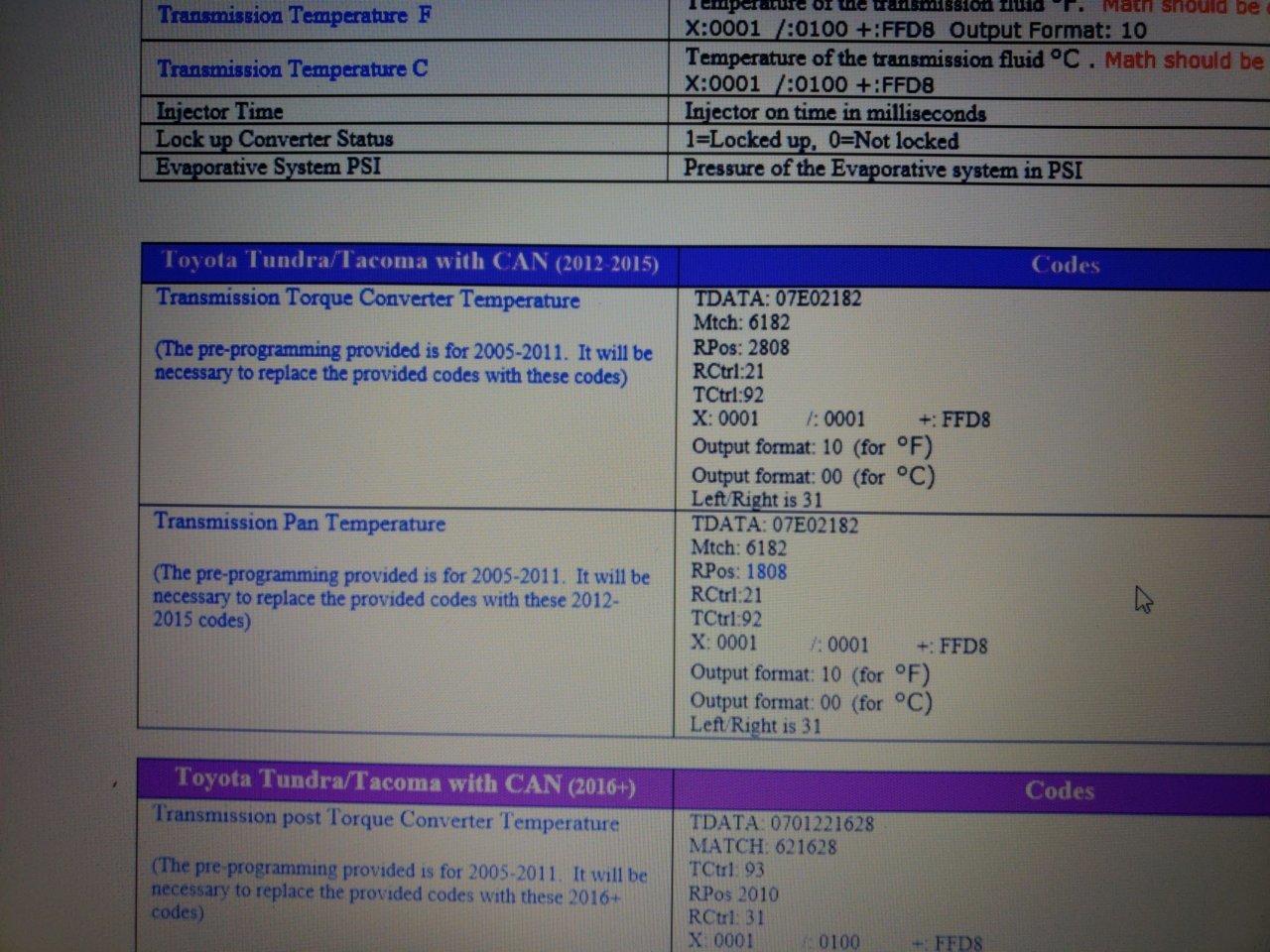

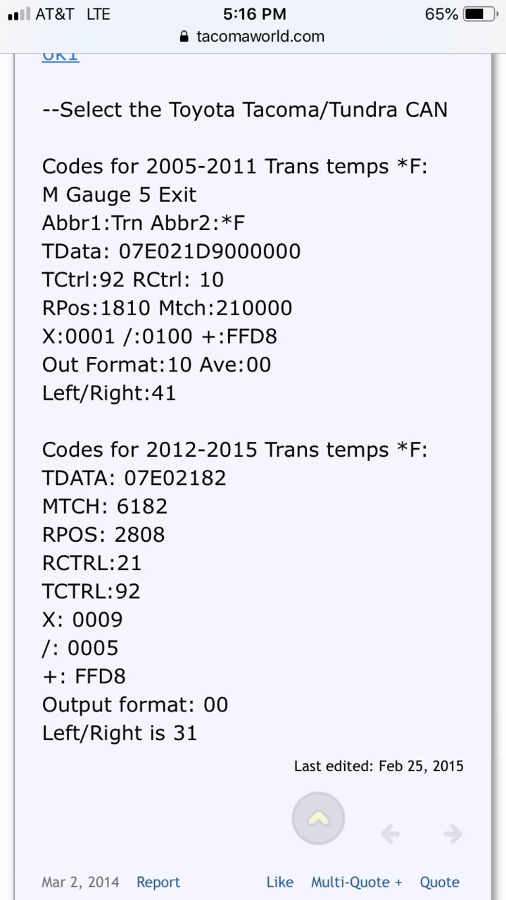

    I just received my MX 1.3. It is for "Tacoma/Tundra". Is the tranny temp options already loaded into it or do I need to still do that? Thanks!

    I believe it comes pre loaded for the 2005-11. 12-15 have to change some parameters to get it to read them.
    http://www.ultra-gauge.com/ultragauge/support/Ultragauge_MX_1.3.pdf read page 3

    If anyone with a 2011 Tacoma is getting an error message for trans temp on the UltraGauge, try entering the 12-15 trans temp data, it worked for me.

    Received mine today, took a few times reading the manual, and tinkering with it, but finally got it reading trans temps, I think. I changed one of the 8 supplied gauges, to the above settings for 12-15 models.
    edit: I changed the codes as stated below, and it works great so far.

    Went back to it, used the codes from the manual for 12-15 models, came up with a slightly lower temp for the trans oil pan.
