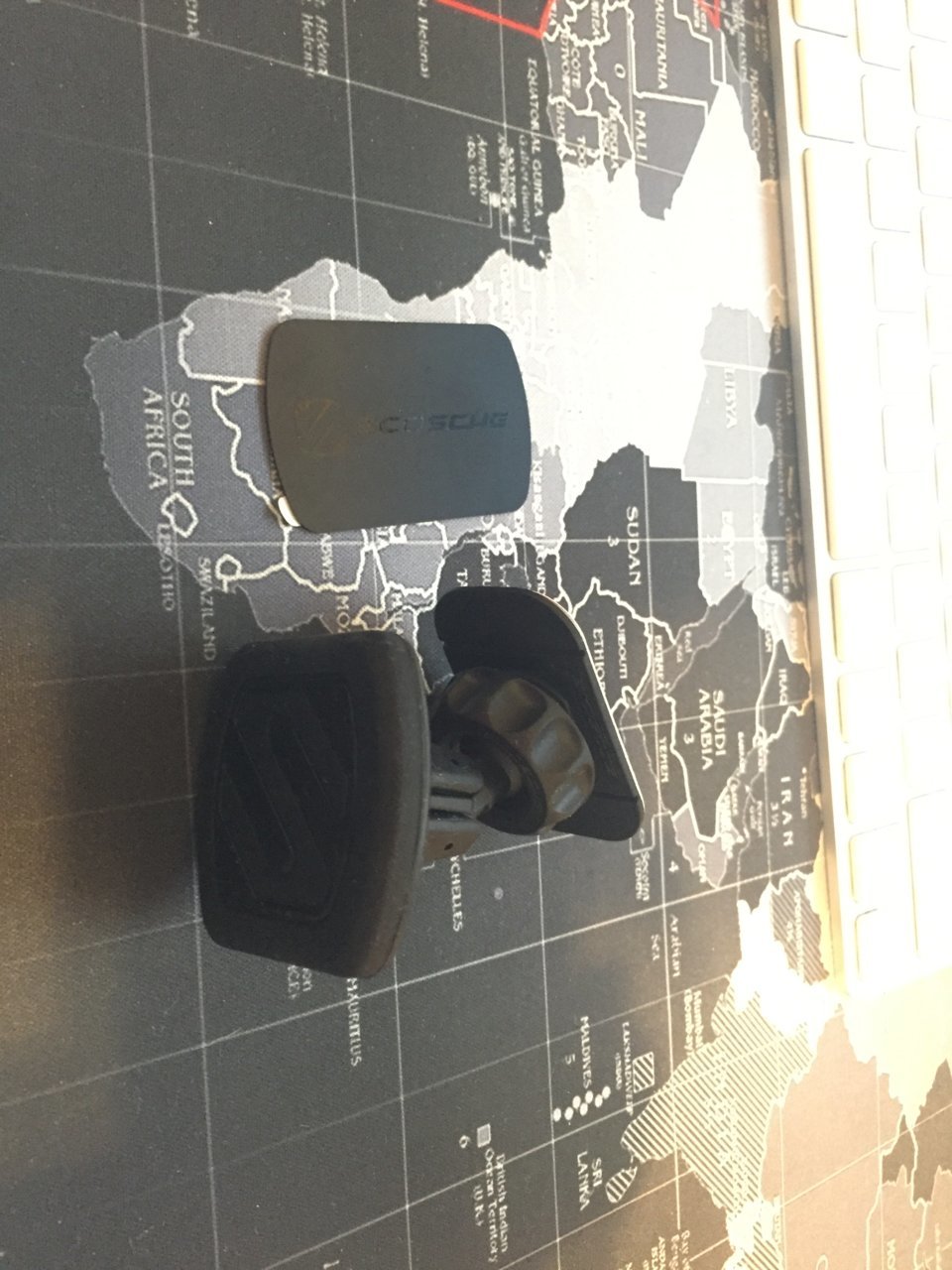

    Picked up this scosche device magnet from walmart 14$. It will work perfect for the upper A pilar above the oshit bar. Its already set up on 45 degrees then you can rotate it close to 70 degrees. Its also has rubber over the magnets so the device will not rotate.

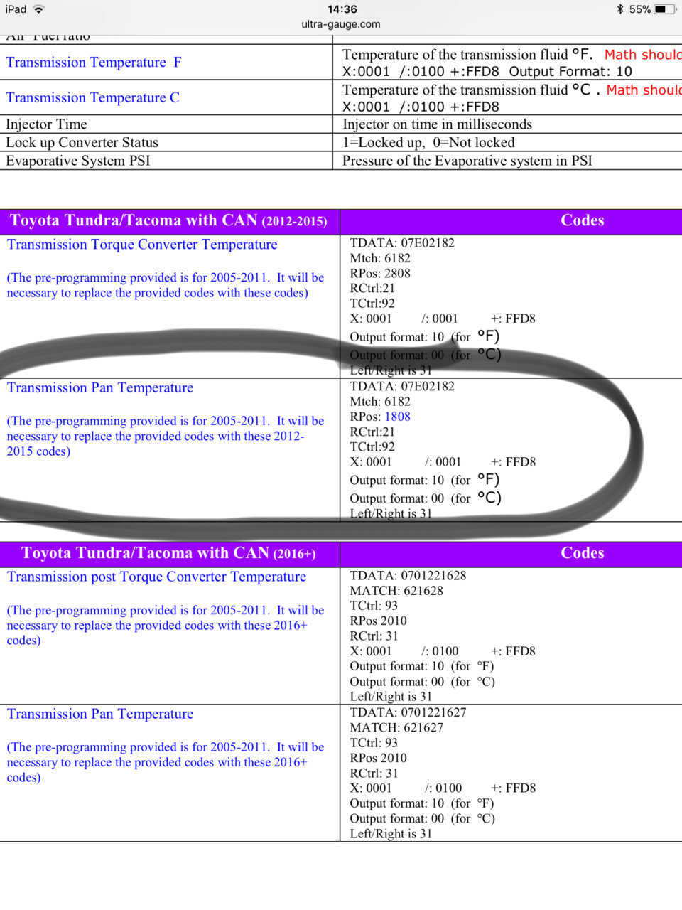

    Update.. have this from another thread and have Trans temp. 4219643D-BB89-48BA-810C-E33DE61C79CC.jpg

    @Wakecoach I used the info posted on page 15 and it worked for me. However, I am in a 3rd gen so idk if that makes the difference

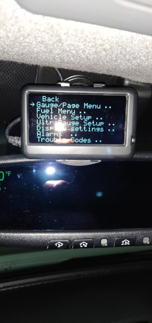

    Got my UG. Did a quick yet effective install but didn’t really mess with pages/gauges until tonight.
    I’m a little upset it took me this long to buy one of these.
    Thanks @ramonortiz55 for the GB!
    Also had to use the 12+ parameters to make my trans temps work. I have an 11.
    Horrible pic but you get the idea. Horizontal mount and stuck that bitch to the windshield.

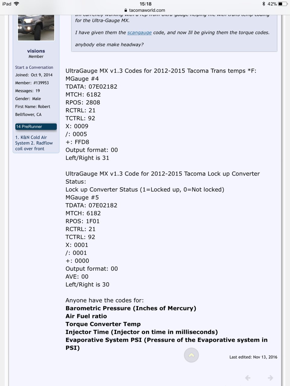

    Yes.. I used these numbers from another thread..
    My bigger problem was I was in M Gauge 1 and needed to be trying to change M Gauge 4 .. I believe anyways .. I’m no expert ..
    I have the Trans temp. Others have the Pan temp. I don’t know which is best to have. But I just want to keep an eye on heat during off-road and battery if I need to winch

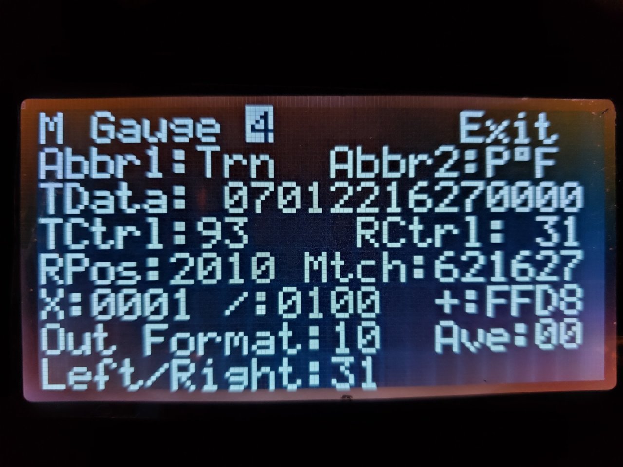

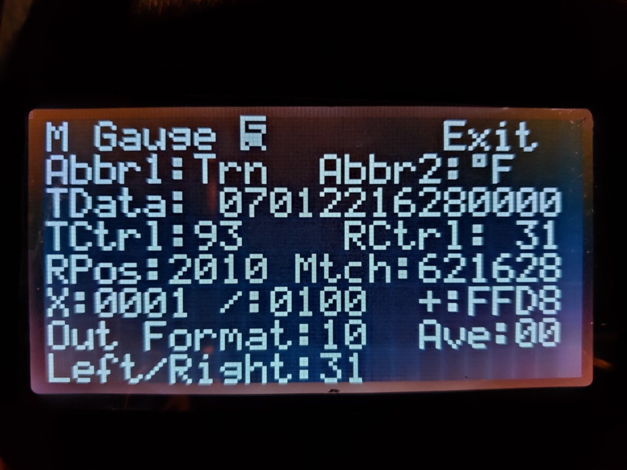

    Here are the codes that worked on mine. It's a 2013.
    This is for the pan temp.
    This is torque converter.
    It seems to have worked.
