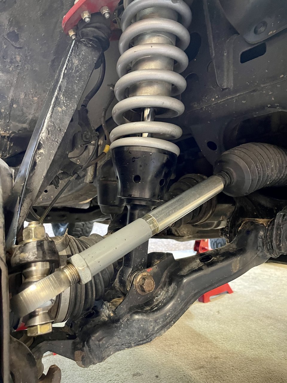

    Holy crap I want these. Anyone know what setup we need from this on our stock 3rd gen tie rods?

    I believe they may work for either. From what I remember you just choose rod diameter from your current inners. If the rod diameter matches to one of their selections then you will be good to go.

    Been wanting to do this exact thing when I get a new steering rack….heim ends with the WarFab sleeves. How’s it going so far? Any regrets switching to the heims? Any crazy noises? Lol

    It’s going great. After wheeling trips I throw some lube on them and clean them up. I haven’t had any noises out of the ordinary. My truck has quite a few noises of it’s own lol
    I was tearing boots left and right so this was a great upgrade for me. I would recommend it for sure.

    Hell yeah!! The diameters of the outers and these sleeves match up exactly the same which was a bonus.

    Awesome! The tie rod ends are pretty much the last booted ball joints on the front end of mine. Have TC uppers and just acquired TC lowers from a friend that's putting his truck back to stock but they need a major overhaul. Just want to make sure I order the right ones, are they 16mm?

    Damn that’s awesome. Lowers will be nice and shouldn’t be too bad to refresh. Yep 16mm is correct.

    why not go with JD Fab
    They have similar and weld on double shear tabs onto the spindle kit

    If you want to double shear it then you can get the shear kit alone and it will work with these. I don’t have a tundra rack and if that bolt were to shear off I can reach in my parts bin and put a new one on. I’d rather that then having to do a steering rack on the side of the trail.

    Probably already mentioned, but these work just fine with JD Fab Dual Shear Steering. Don't even have to remove the front tires to install these!
    [​IMG]Tie Rod Sleeves - Warfab by Michael Rickerd, on Flickr
    Front end tire area is done. For now!

    How much more maintenance is required on these heim joints?!
