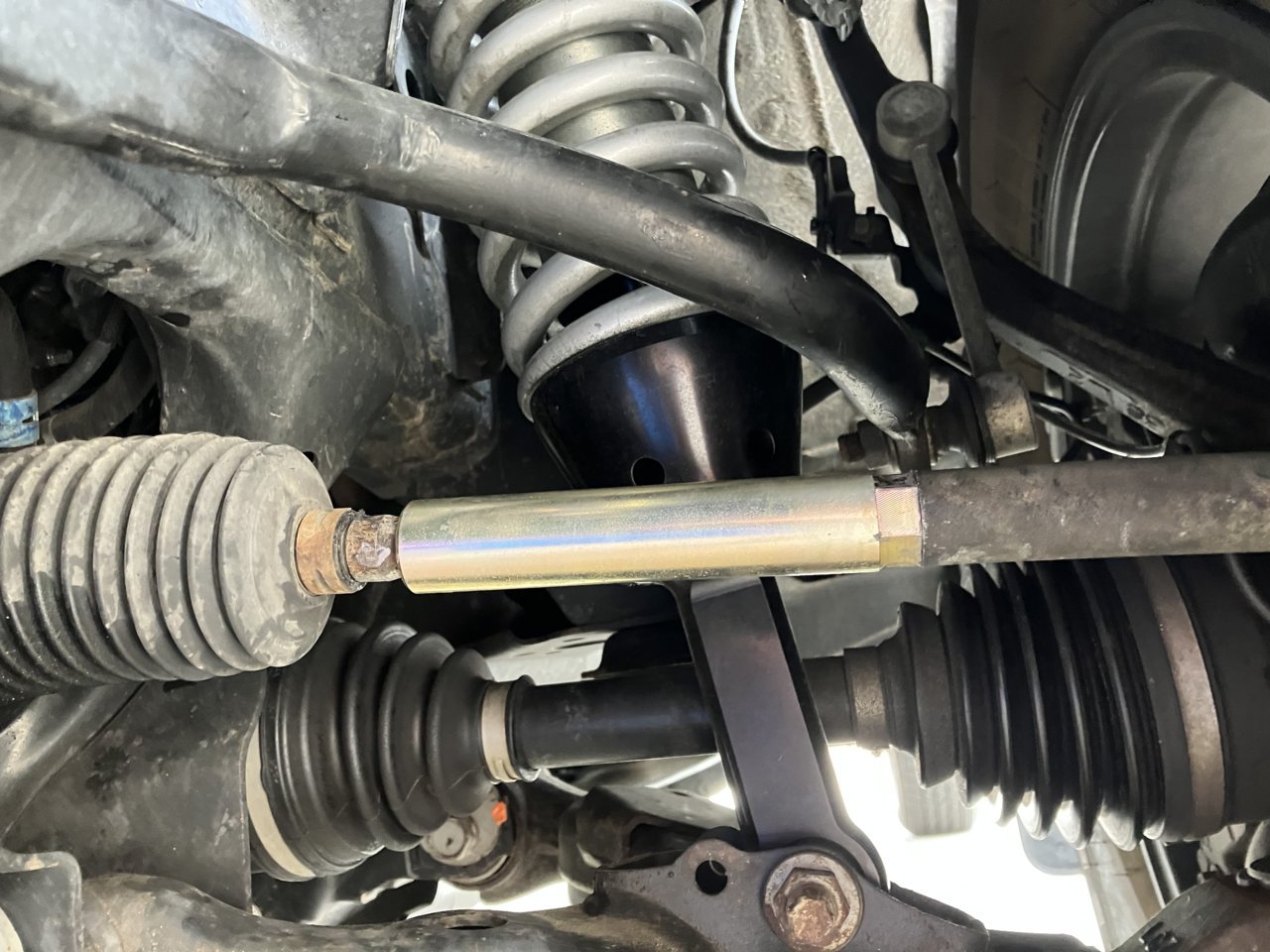

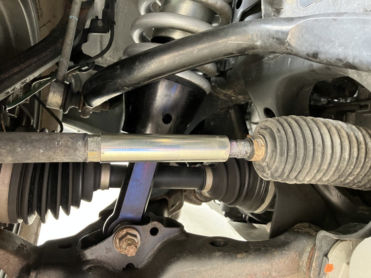

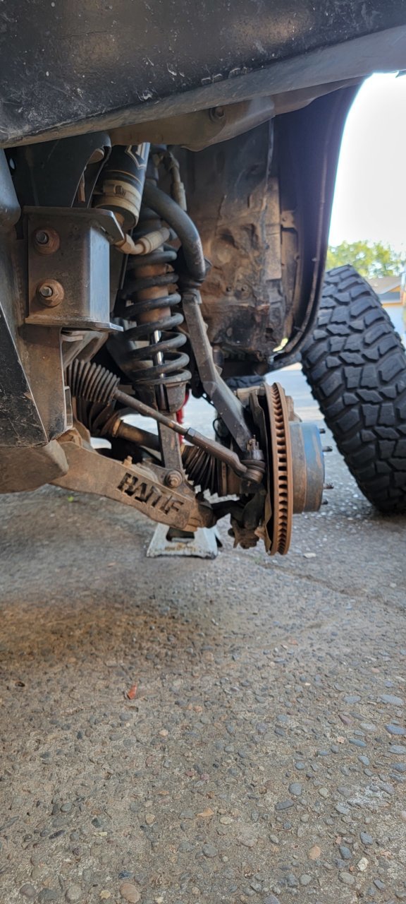

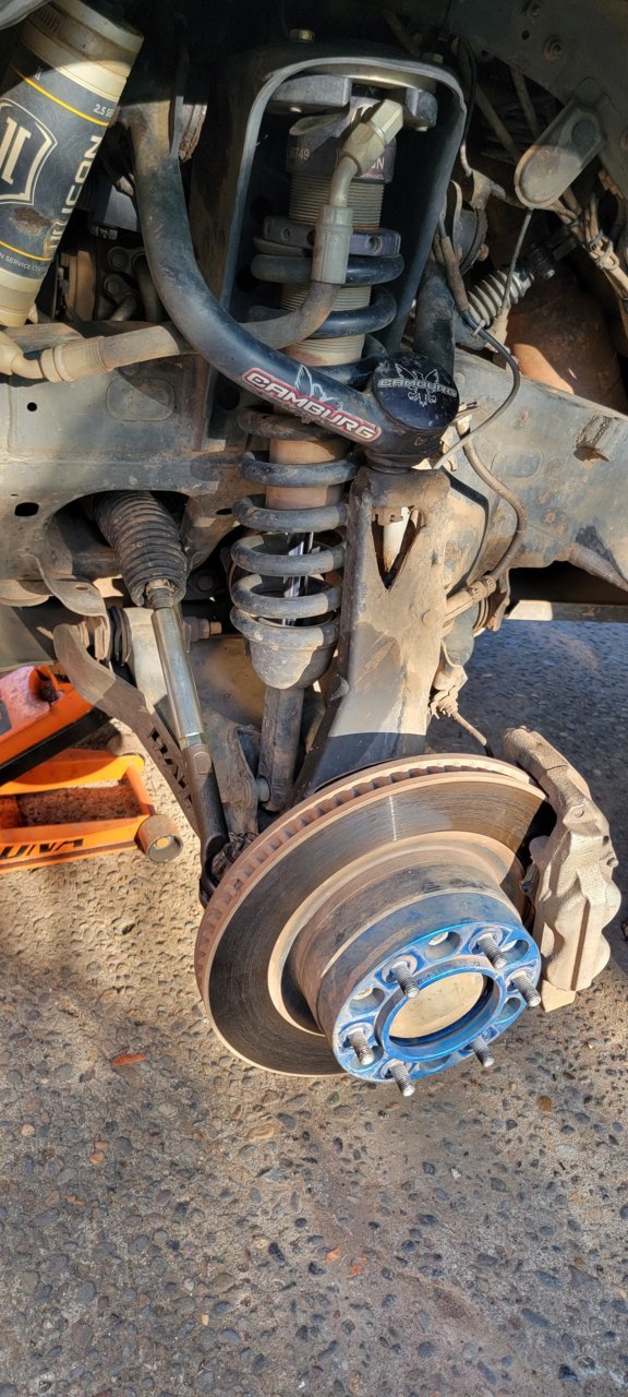

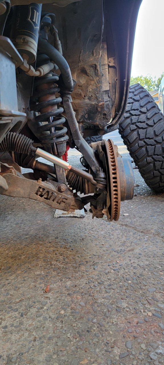

    For me, I’m full stock on tie rods. I was surprised as well that mods were needed. I believe it didn’t clear the bulge. @Speed Freek might remember more. I didn’t take pictures and he didn’t either but here are some for the after.

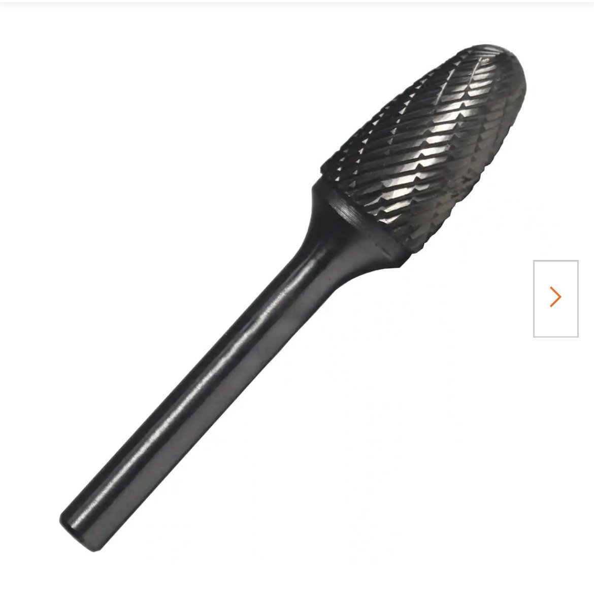

    All I had to do was ream the last little bit of inner diameter out closest to the rack. I don’t have oem tie rods, think they are mevotech or something. As far as some others trimming the sleeves shorter, I’m not sure why that would be necessary. I simply put the sleeve in the vice and hit it with one of these bits (will attach picture). All tie rods I’m sure vary with diameters as far as non oem goes. For what this product is and only having to ream a little bit of ID out is nothing. Thanks again for not only the product and discount but for such an awesome idea.

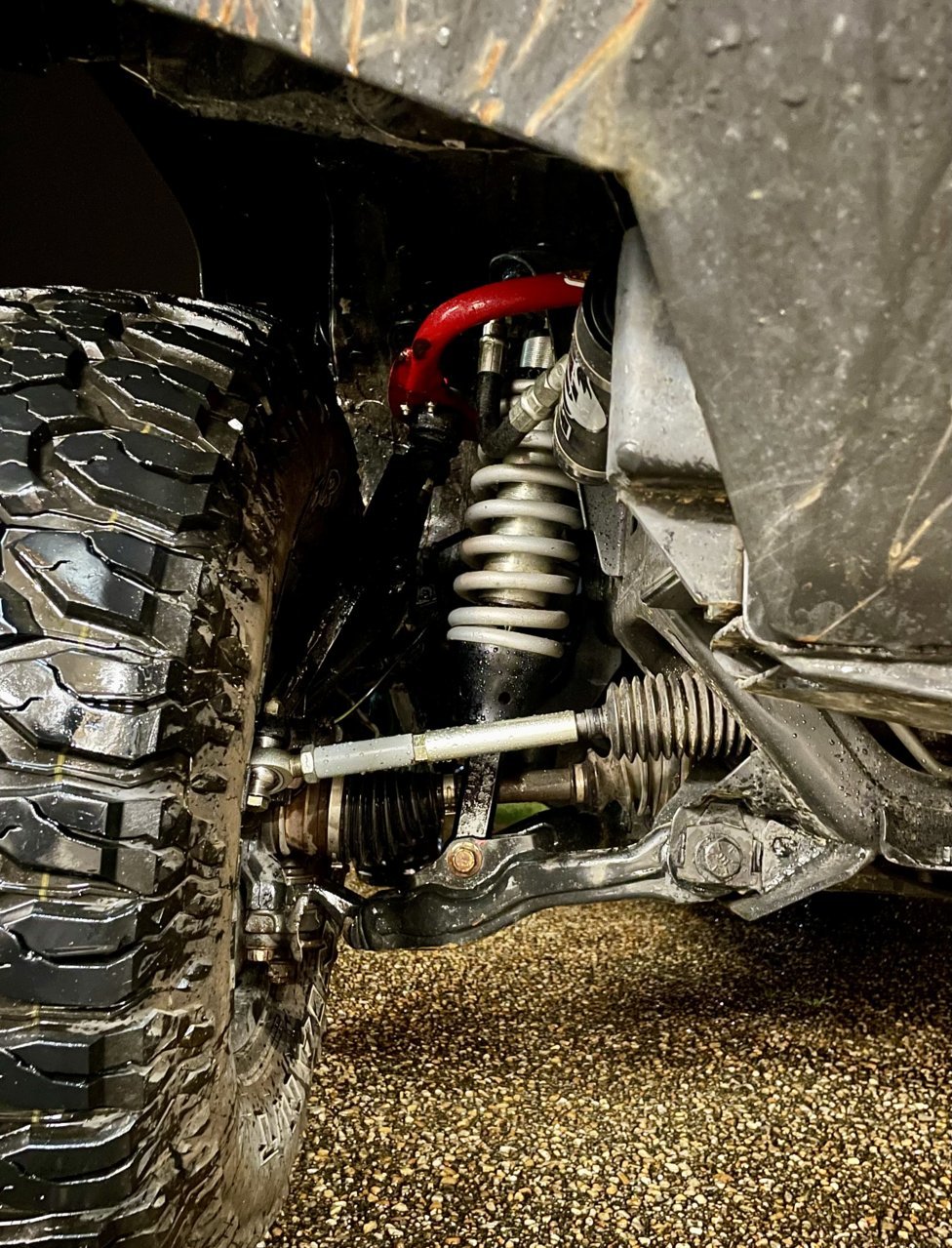

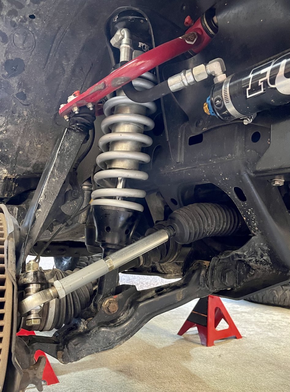

    Rubicon tested! Haven't bent an inner before, but a good piece of mind with the sleeves so I'm not as easily a trail plug. Also nice that the tires don't point at eachother anymore when the front is unloaded and locked.
    Not sure what the hype is over the heim outers, I have 60k of wheeling every weekend on my stock outers and they are fine, even with seeping grease. Meanwhile, I have gone through about 8 inner tie rods as the cups of them wear out.
