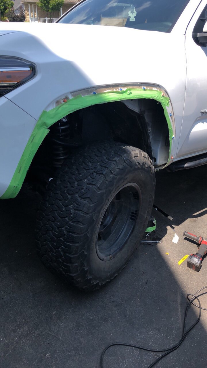

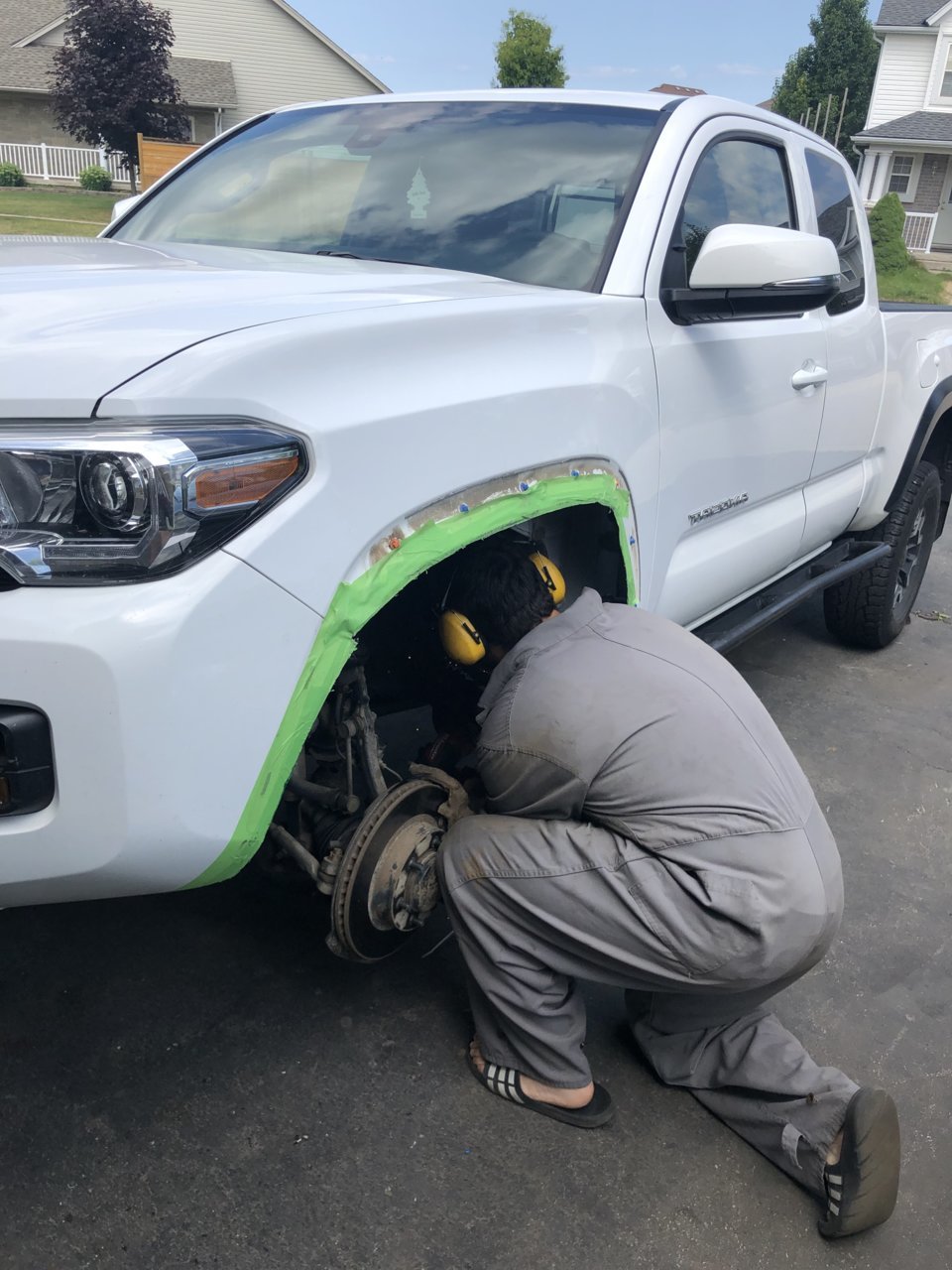

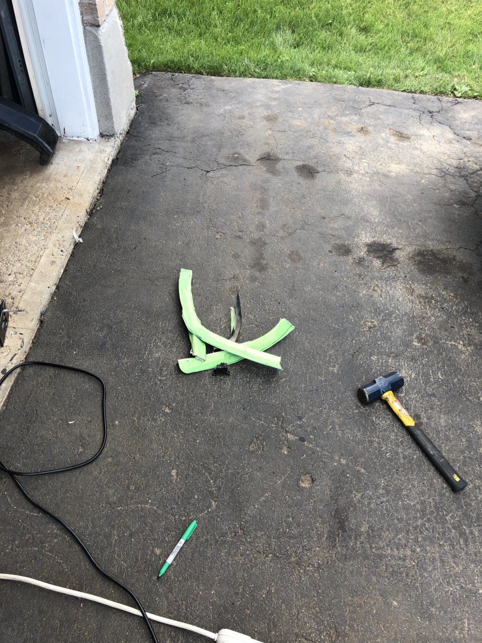

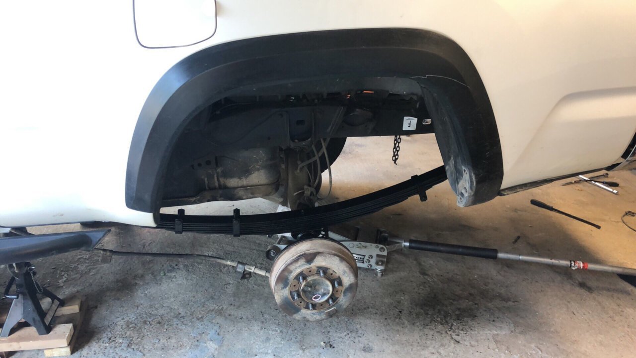

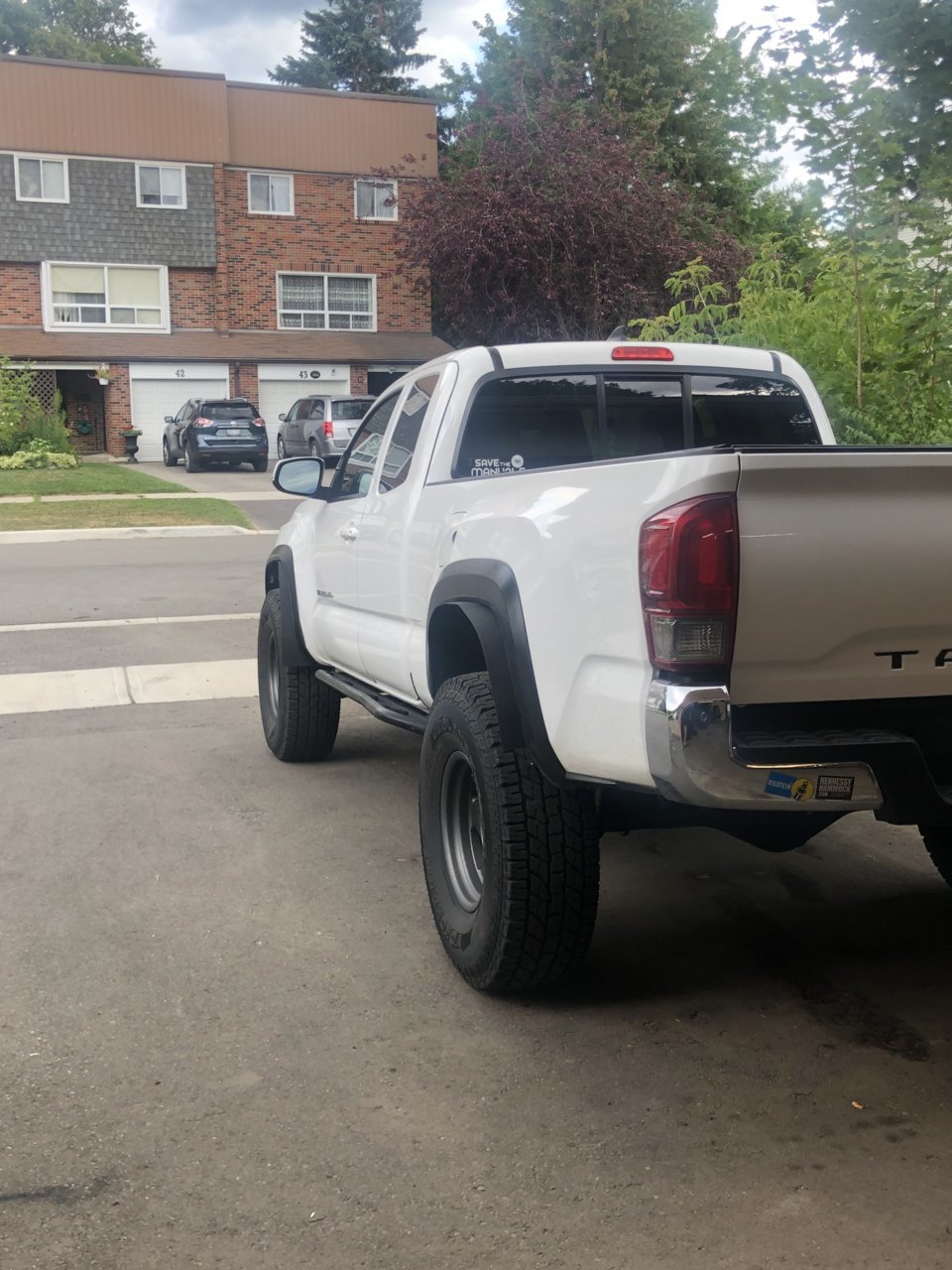

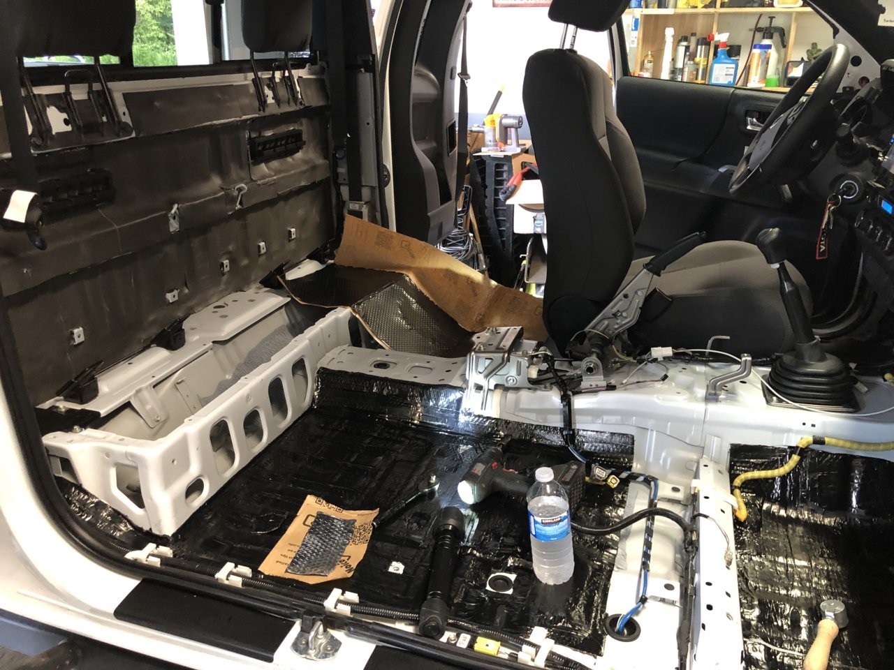

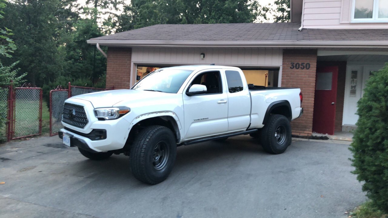

    How to do DiRtY5s the slav way
    step one: come to the terms that you are about to fuck up brand sparkling new tacoma with 44,xxx+ miles on. Drink.

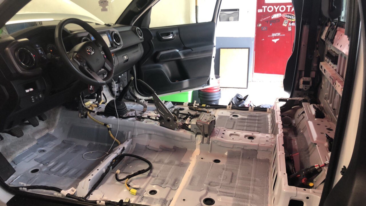

    step two: apply sound deadening material to your cab, doors, etc — those e-rated kicks will be loud! Drink.

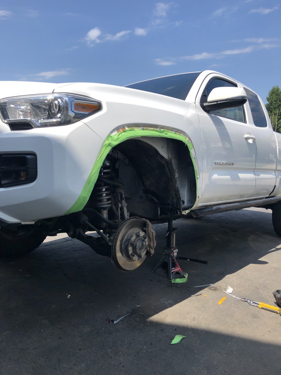

    step three: find a friend that can cut your fenders (because you are already too drunk from previous two steps to cut straight in line) and cab mount along the lines.
    @tacoma16 :sawzall::welder:
    Drink a lot.

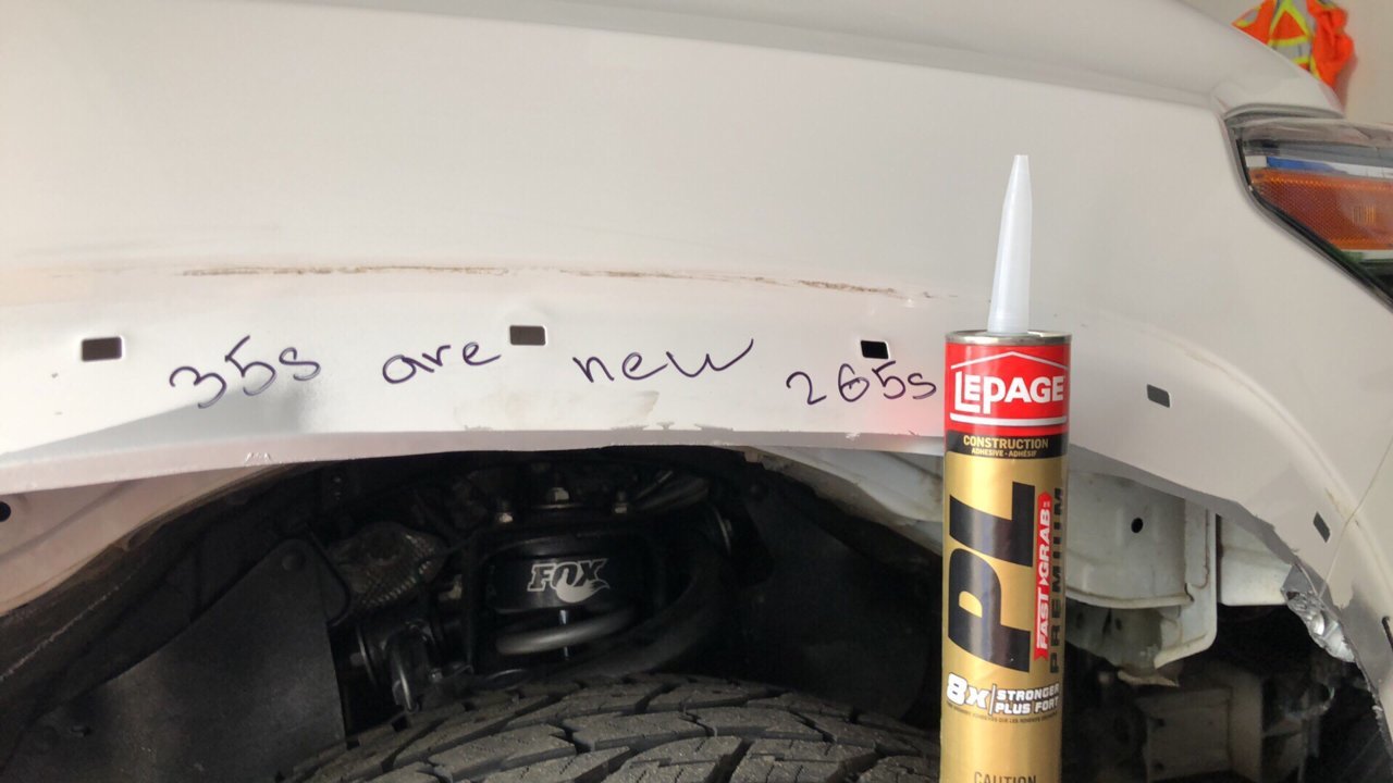

    step four: order new 16” wheels, -25mm offset SCS F5 and 315/75/17 shoes from Yokohama.

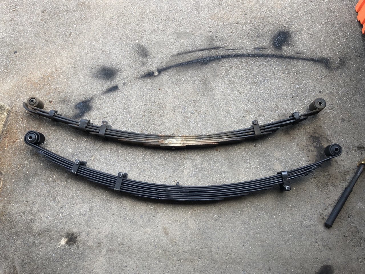

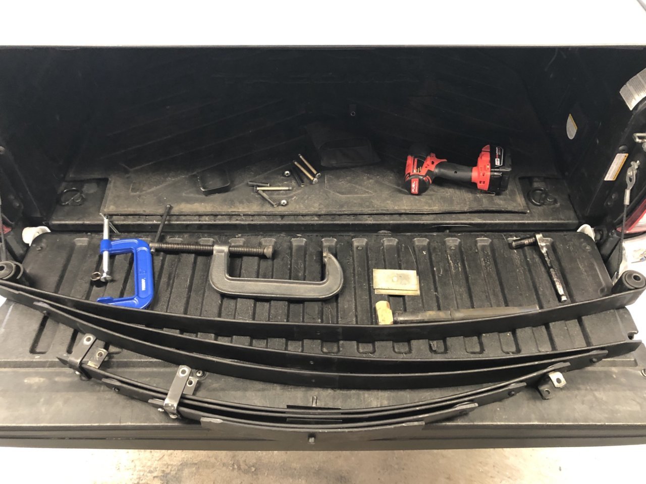

    step five: install approx. 3” lift using icon RXT leaf pack (setup 3 on driver side and setup 2 on passenger side) paired with B110 and new extended brake lines.
    step six: put the 35s on, smile and drink.
    step seven: attach front fenders/clips using sponsor provided glue

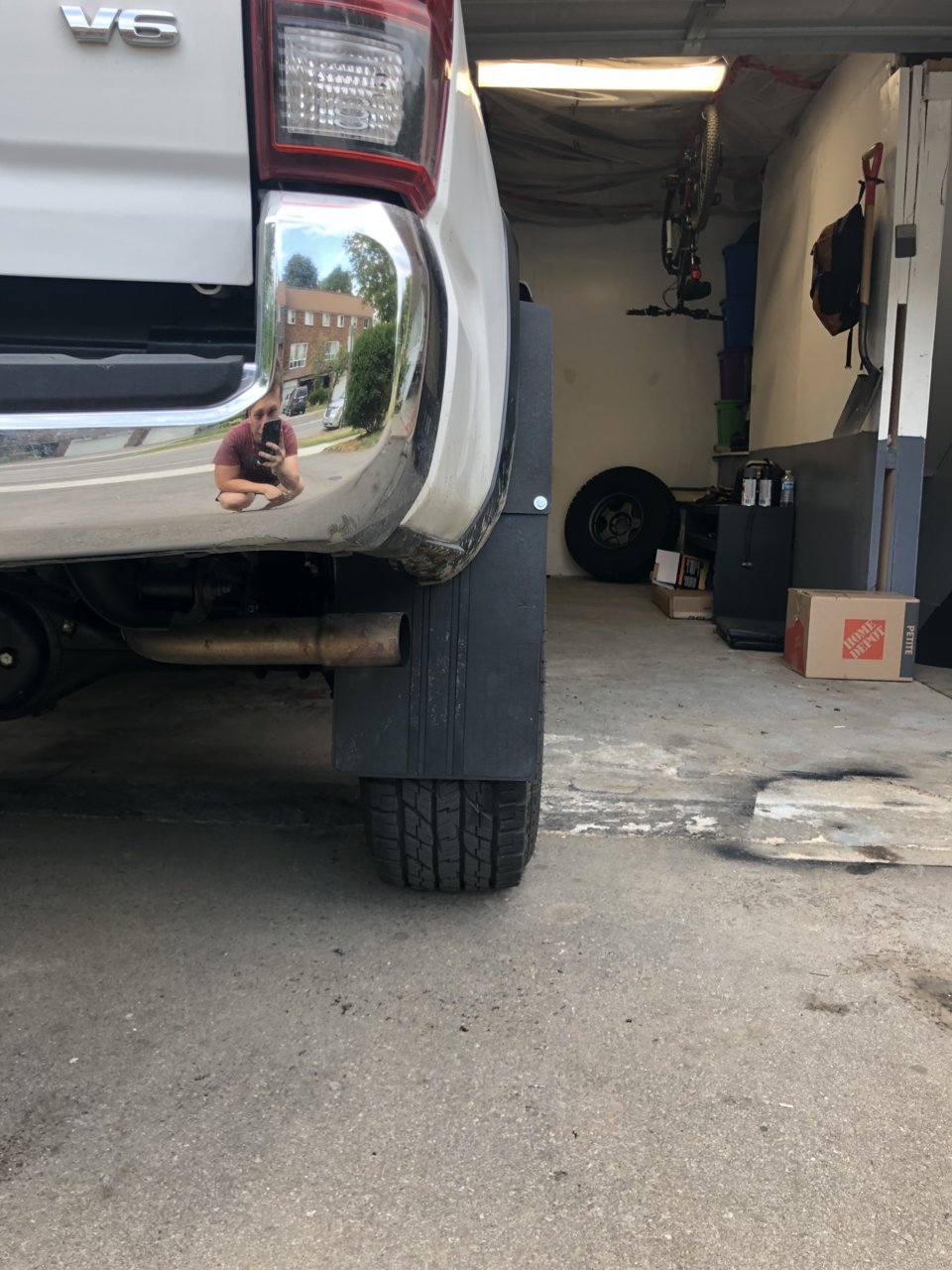

    step eight: make extended wheel covers and mud flaps, because you are socially responsible and don’t want to pay for a ticket. Drink, but not too much.
    277DC2F3-8BDB-4BB0-89A1-18D0386D85FE.jpg B6392388-A815-4139-9050-50837202AF8A.jpg 381958BD-89C3-4C42-8AB5-CB3057561352.jpg

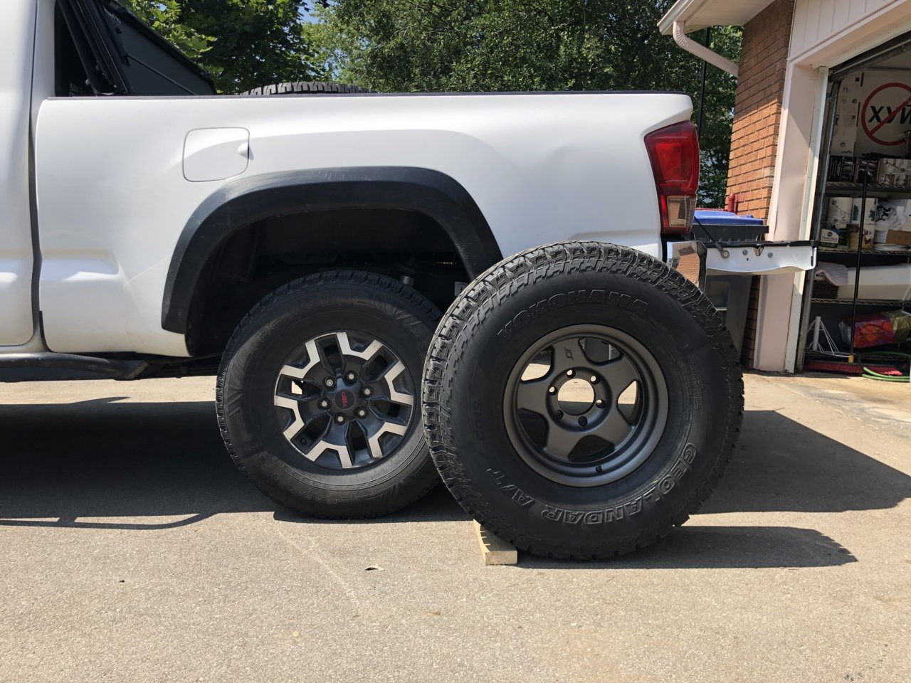

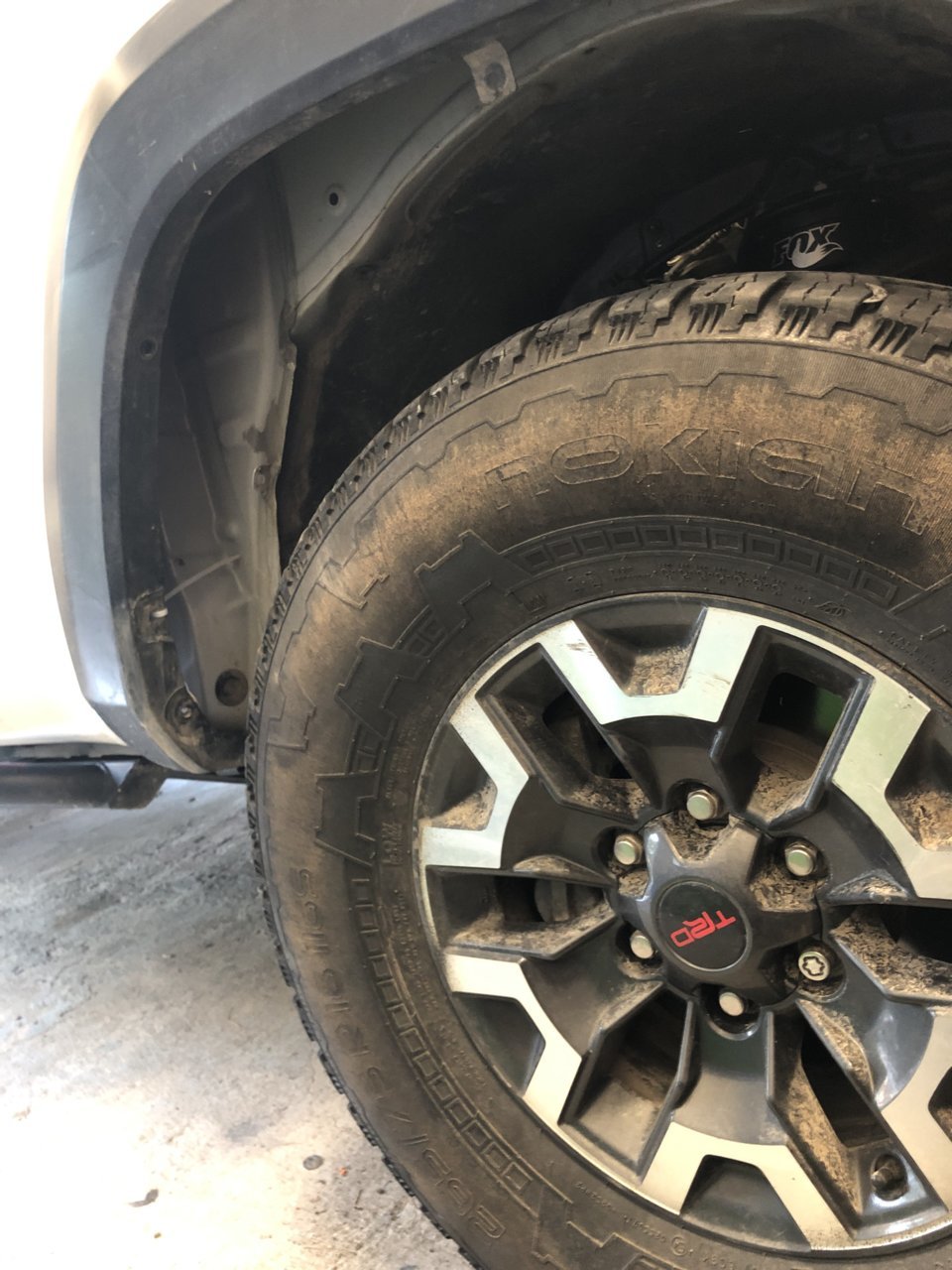

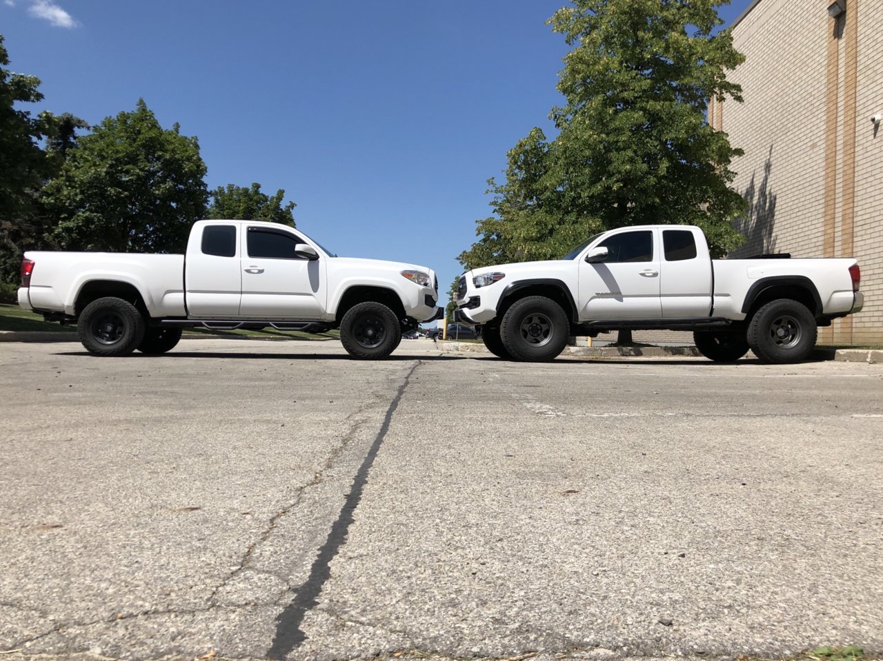

    step nine: park next to 32s:wink::p

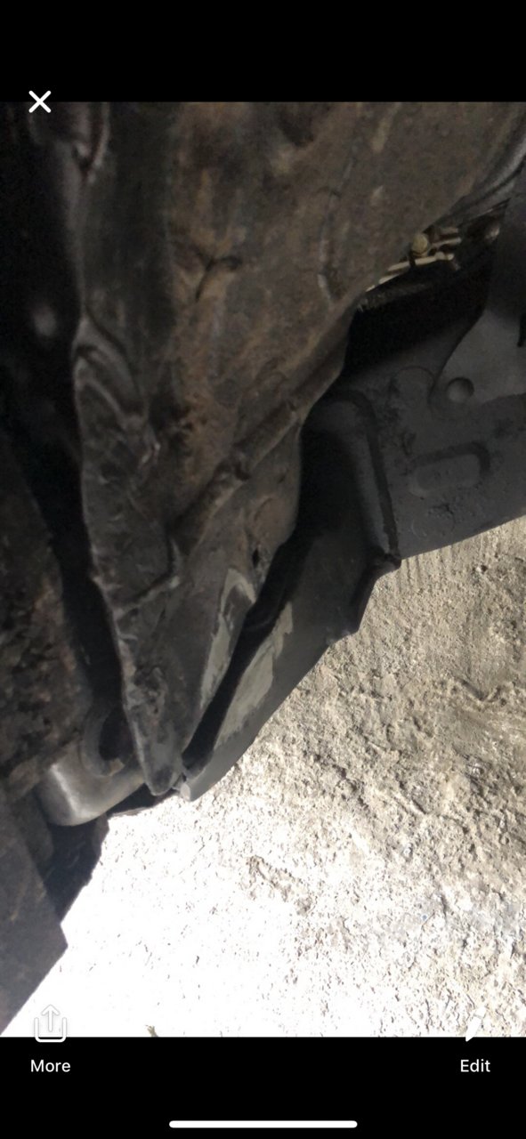

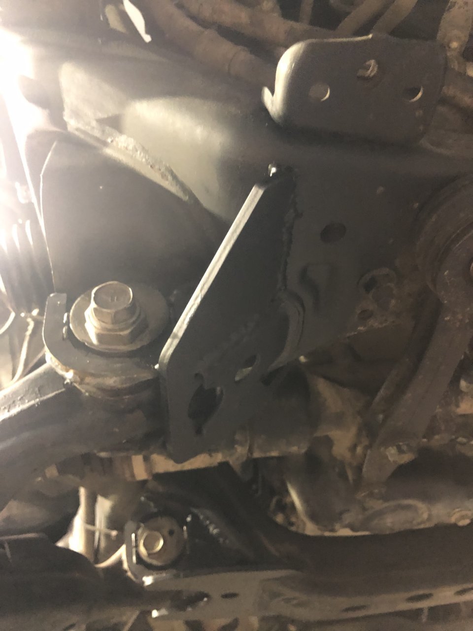

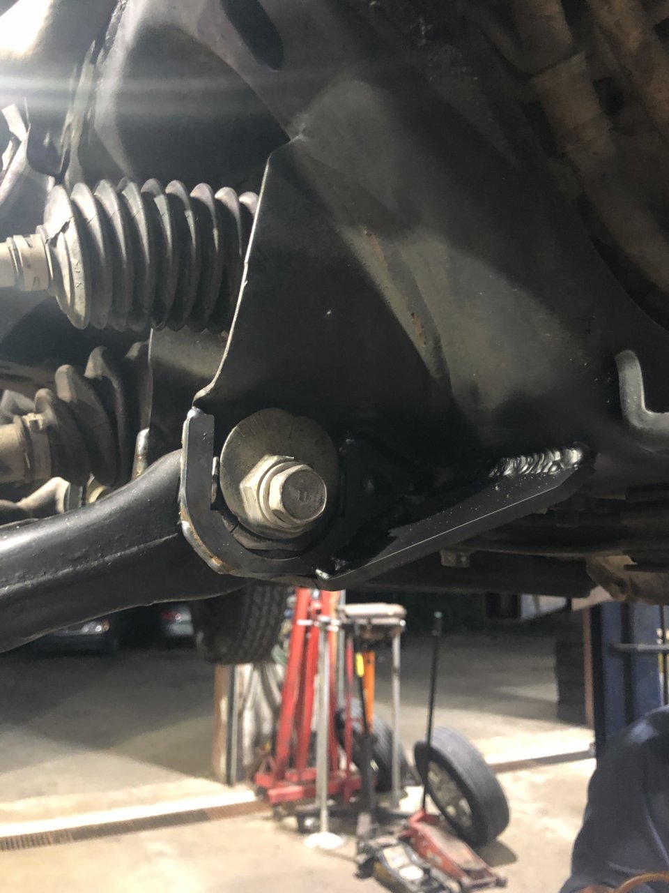

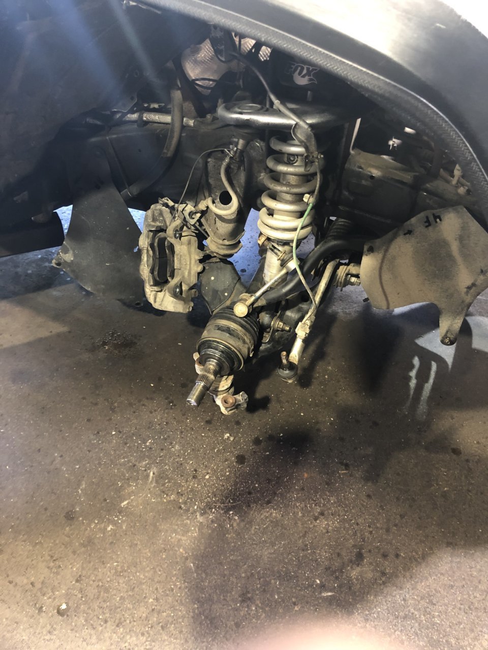

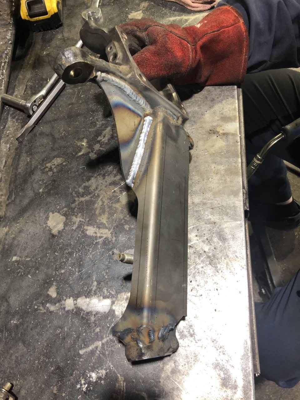

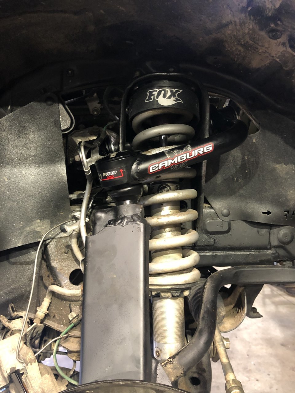

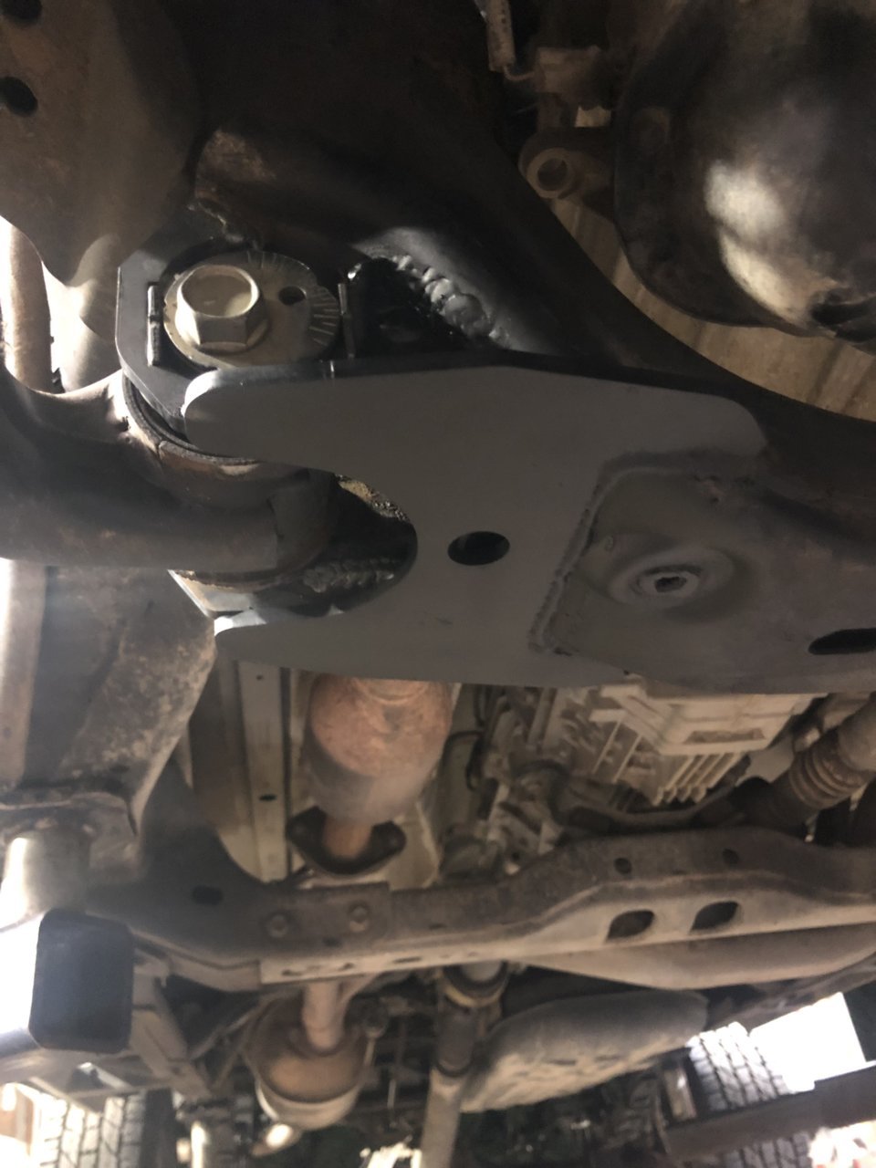

    step ten: gusset your spindles using TC kit & alignment tabs using marlin crawler kit. While at it replace stock UCAs with Camburg UCAs and change front diff bushing using ECGS bushing. :welder:
    DE8DAAA4-307F-46FC-B973-5614BED76050.jpg F02A21A6-094F-4CF6-ABFE-1D27FDE8C377.jpg 75910B94-615F-4191-8FD0-CE753BCA2FC6.jpg EDD01BAD-C96D-49A7-8915-8E70C8724FEF.jpg 9F551046-22DE-4867-8123-2242F9DF5A9D.jpg CC20E506-3E5E-41FE-A09C-600ACB4AAF8D.jpg

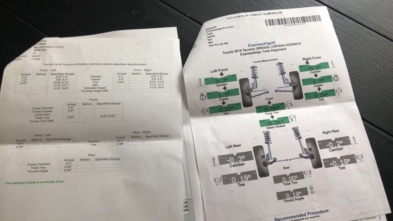

    step eleven: go get an alignment
    original on the right, new is on the left
    step twelve: continue rubbing in reverse, drink, smoke, drink again.

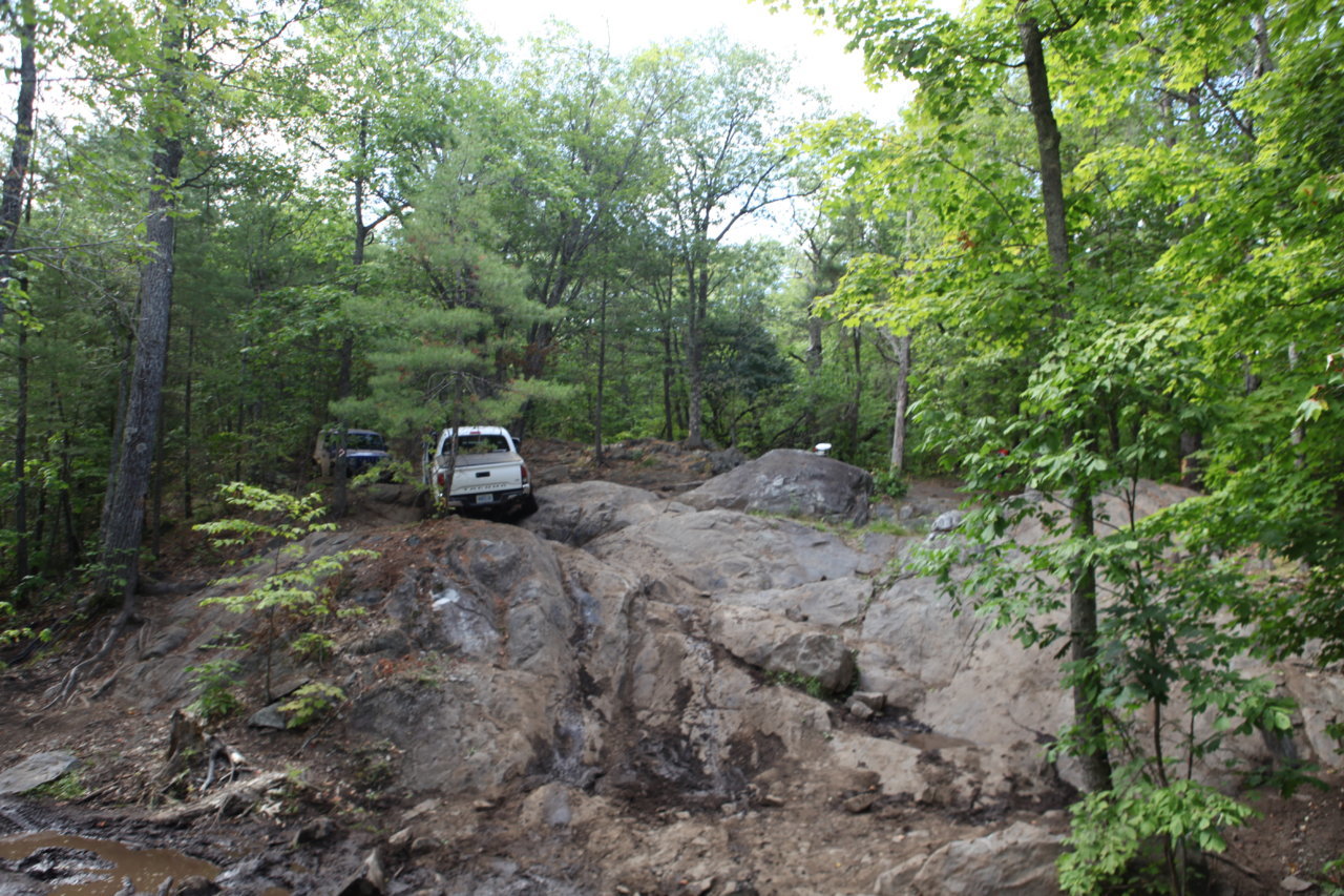

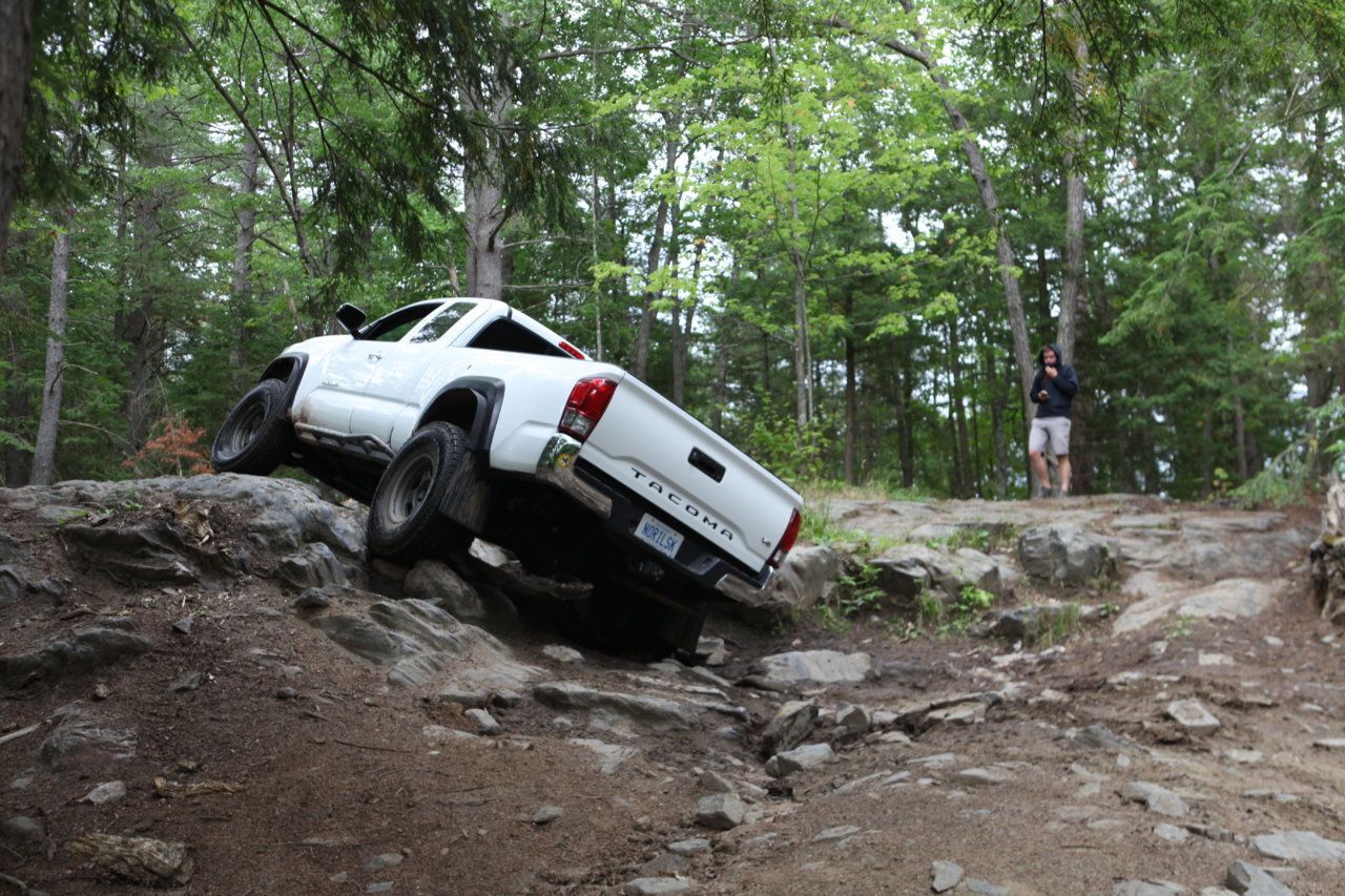

    Latest pictures from mall crawls

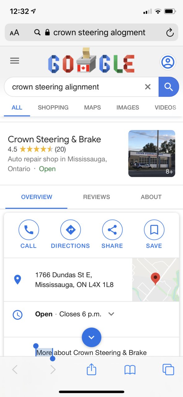

    Where did you go for alignment? I need to find a new guy.
    Manfred likes this.
  15. Oct 21, 2019 at 9:33 AM
    #55
    Norilsk
    Norilsk [OP] Well-Known Member
    Nov 12, 2015
    #169435
    8,370
    Eugene
    J100 (Bougie) & UZN215 (Spartan)
    This guys, they gave me what I asked for.

    The new numbers work well?

    nope (but that’s on me) - that’s because I got 35s lol
    Next month 3” lift coming, then we will see...

    Holy shit where is that?
    Norilsk[QUOTED][OP] likes this.
  20. Nov 5, 2019 at 4:44 PM
    #60
    Norilsk
    Nov 12, 2015
    #169435
    8,370
    Eugene
    :canada:
    About 2 hours north-east of Toronto. Will be coming back there for a steeper offshoots that require 37-40s and giving a go at them now that I have winch :burnrubber:
