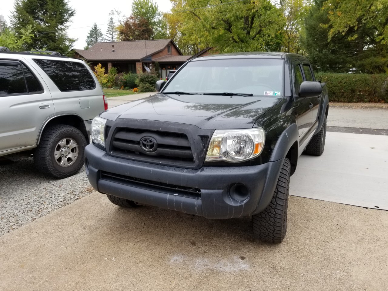

    It's pretty easy to wet sand a hazed lens clear. The problem is that in doing so you remove any of the remaining UV hardcoat. In order to keep the lens from rehazing you need to topcoat it with something that is UV stable.
    2k automotive clearcoat is a great option, but you really, really need to wear a chem respirator when using it.
    I've had good success with outdoor rated (UV stabilized) gloss clear polyurethane. It's easy to apply (50:50 poly: mineral spirits to thin it), cheap, and easy to fix if there are runs or fisheyes (just use mineral spirits to polish it back off the polycarbonate).
    I did my parents 2010 earlier this fall. The driver side headlamp was completely hazed over. It had been repeatedly sanded clear and then topcoated with auto wax (which even if the wax is uv stabilized, it wears off very quickly) for the past several years. The passenger side headlamp had been replaced a few years ago due to the reflector being roached.
    I don't have an up close shot of the finished product, but this was done with varathane spray outdoor rated clear gloss poly.

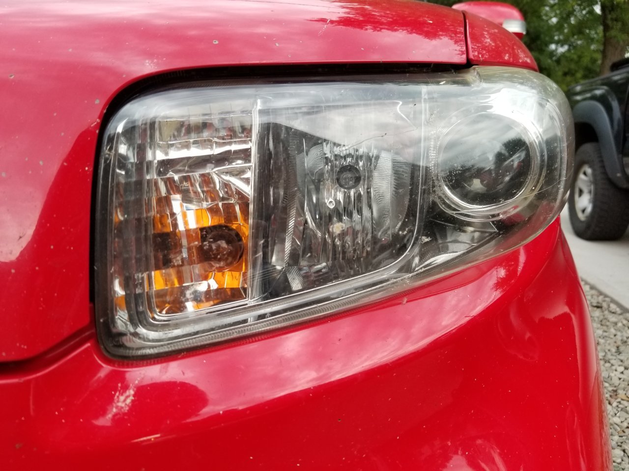

    I've also done my sisters driverside headlamp on her scion xB. She lives in myrtle beach, so it will get well tested by the sun. The pic here is about 9 months after application (december of '19 to august'20), and its still as clear as when it was coated.
