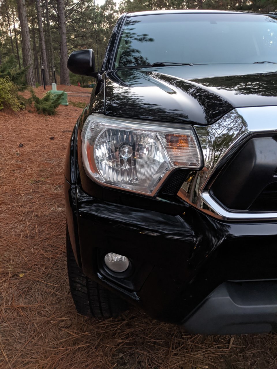

    Ok, so I went back with the 800 to get back to a base, and then I followed it up with 3000 grit wet sand. I tried to use as little pressure as possible, with just enough to keep the drill pad steady. I used ample amounts of rubbing compound and buffed it out with microfiber clothes. I think it's about as good as it's going to get now, and I'm satisfied enough with it. It could probably be even a little clearer but I'm done messing with it.

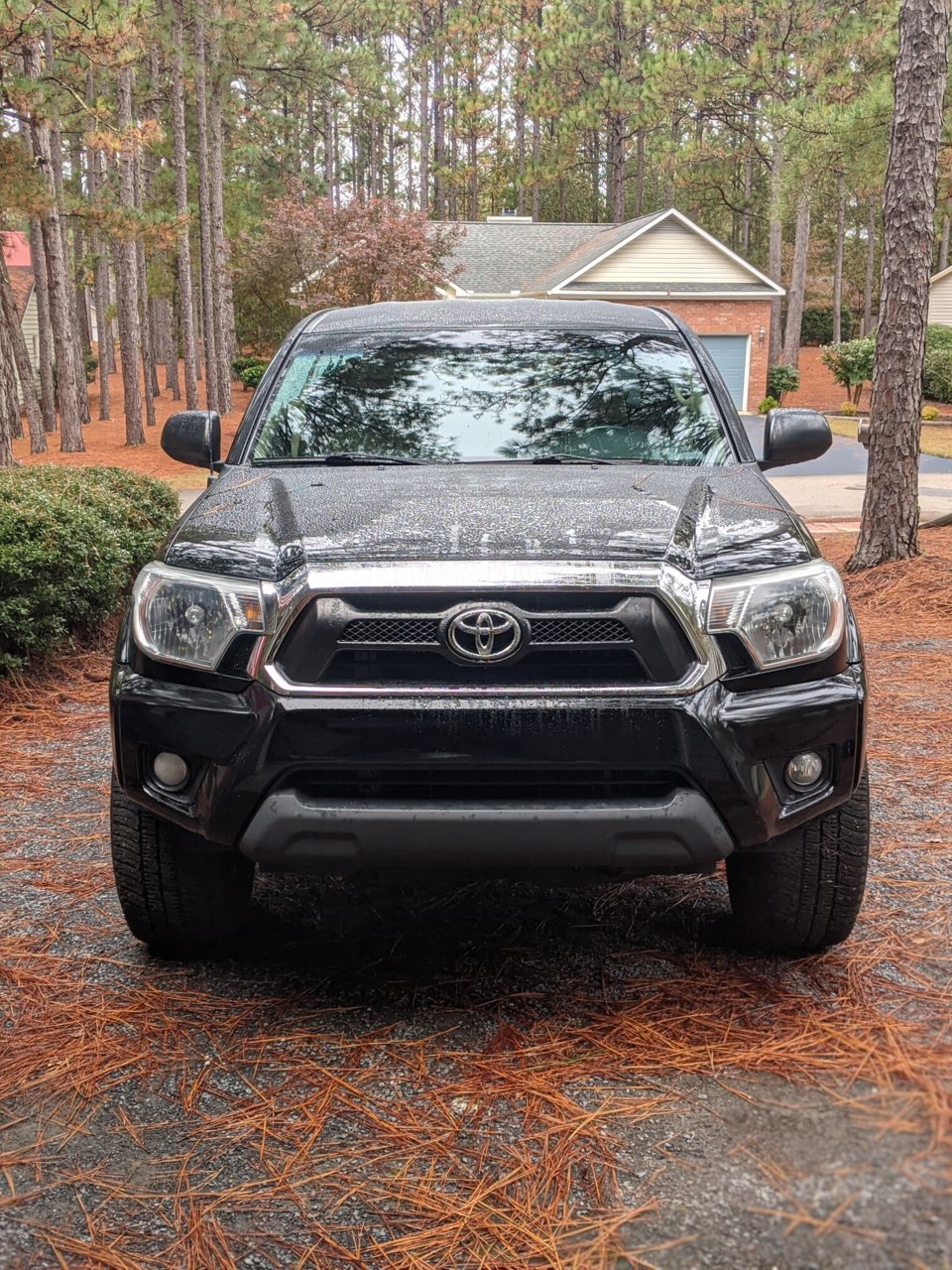

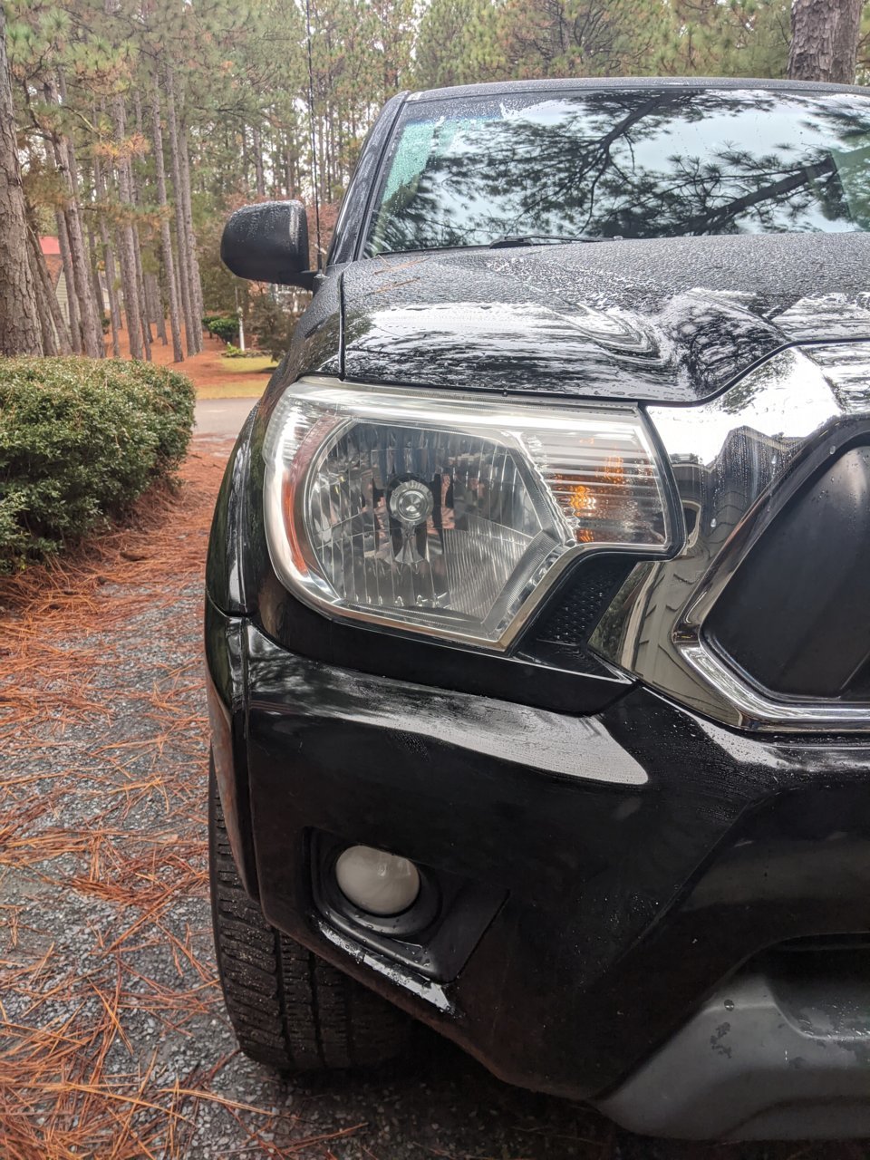

    I changed the fog bulbs the other day in the rain and now as you can see in the picture, they have condensation in them. I'm going to take the bulbs out on a clear sunny day here soon and let those housings completely dry out before replacing them.

    Ok, so my last step for this restoration attempt was a wet sand with 5000 grit paper followed up with Maguire's Ultimate polishing compound. The results I've been looking for. That was the missing step in really bringing out the clarity that the rubbing compound could only take so far. Happy camper!

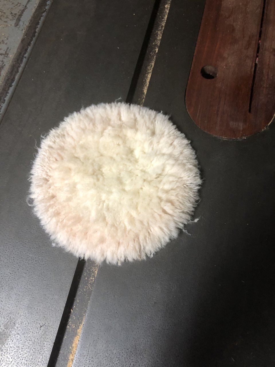

    I just use this:
    With polishing compound on my random orbit sander. Crystal clear. But clouds up in about six months again. No problem cause it takes like 5 minutes to do once a year or so.
