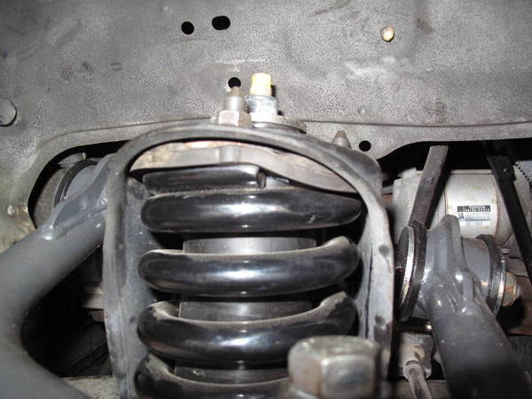

    Well thought we might be on to something but the nut is tight. All the way down. Talked to Kurt at Cruiser Outfitters where I bought the kit and he mentioned to try and spin the spring in the house. Says to put the upper end of the spring facing out. What do you guys think. I guess it is worth a try. Prob try Chris's suggestion tomorrow and spin the springs at the same time.

    Well the noise is finally gone!! Took the coilovers out and spun them so the top end spring faces out like the photo. Then put the drivers in the passenger and vice versa. Not 100% sure what the problem is but it is nice and quiet now.
    Also added a winch while I was taking things apart. Thanks again for all your help!

    Good to know! It looked like on mine the spring was making contact with the UCA bolt shaft in the tower. The coating on the spring was worn from rubbing. Can't tell you how happy I am this noise is gone. Peace of mind at last...
