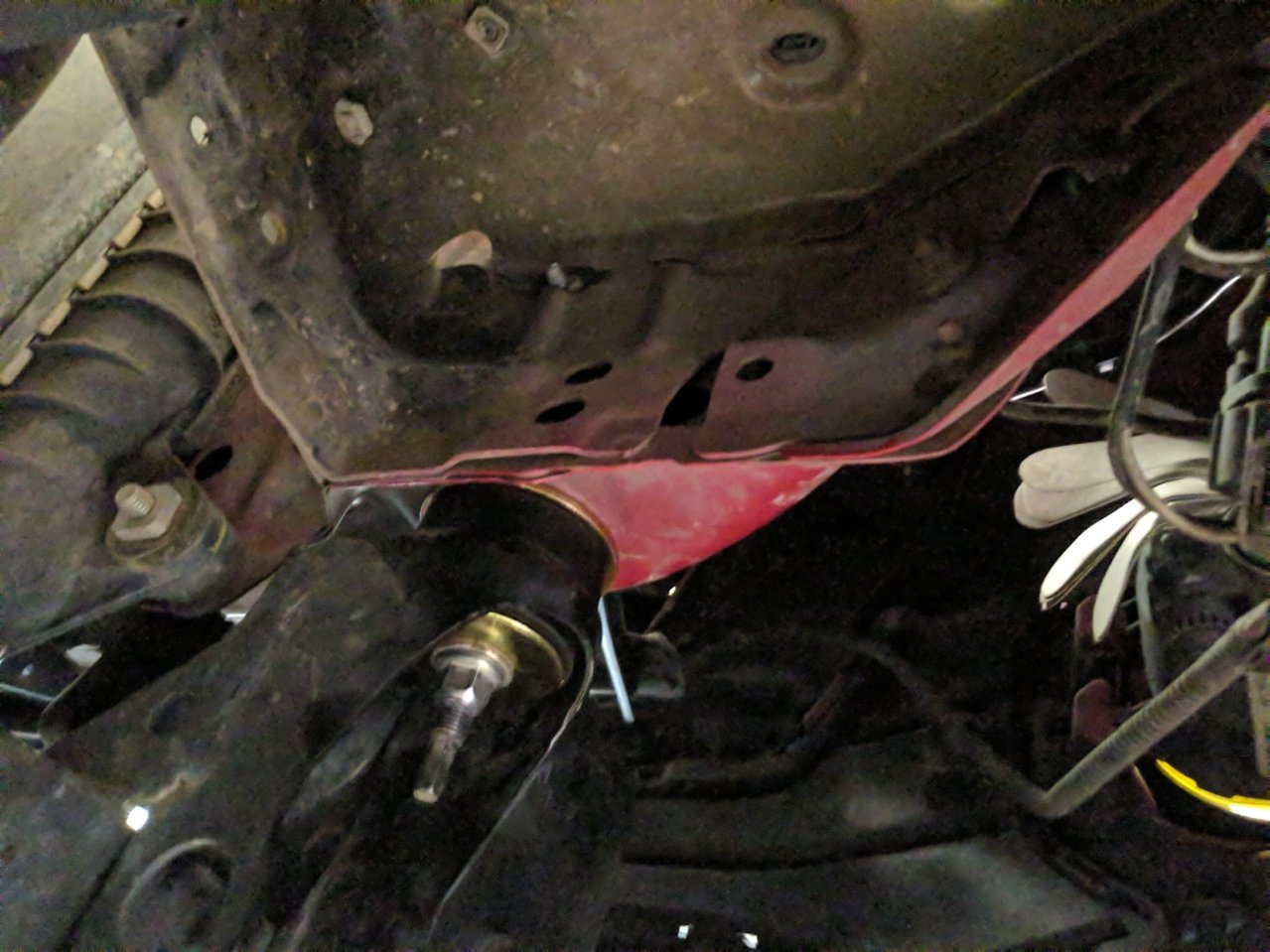

    Most likely the front body mounts. Known to waste themselves in early mileage like that because the rear four have way too much adjustability and allow the front ones to ride the end of their play.
    You have a few options:
    -- Replace with the same OEM ones. Requires very careful cab alignment for them to maybe last.
    -- Replace with the Energy Suspension Universal Kit. Quality parts that are not expensive. The only problem is that they are a bit thicker than stock:
    -- Quickly jump into the group buy for the full Rogue Offroad Poly Bushing Kit:
    Of course, the dealer can swap these under warranty, but you likely be back here again.

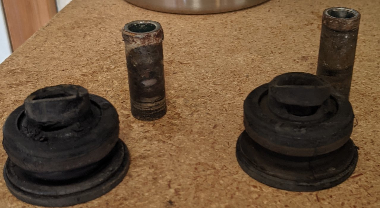

    So today was the day they could get it in.
    Both front body mounts replaced...same exact noise still there. Mechanic noted 'noise is still present' when he took it for a drive to test after the mounts were replaced.
    The noise has gotten louder since it's initial appointment a couple weeks ago. The temps have also gotten much colder, so that may have to do with whatever is/was rattling getting worse as the parts contract in the cold.
    I was hoping the body mounts were it but it seems not.
    Another appointment made for next Friday to look at it again.
    I'm glad I'm not paying for the time and parts, but it is annoying.
    I can't find anything loose on the truck myself from underneath or above, but I haven't taken the skid plate off either and I have no way to relax the suspension to look for loose fittings and joints.
    Now I'm thinking something is just plain loose, like a line or pipe that's clunking against the frame over bumps, but who knows.
    I thought maybe an engine mount, but the sound is independent of acceleration and engine revving.
    I'll let them pull it apart and do their job finding it.
