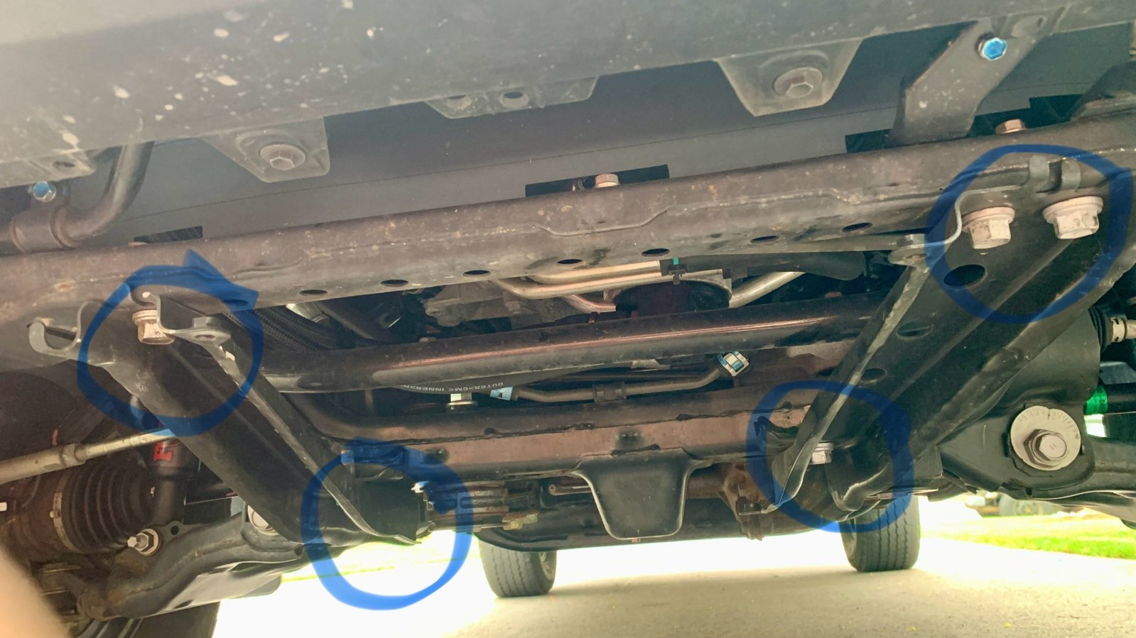

    IMG_9159.jpg I’ve had a squeak in my front end too. Took the skid plate and bolts off- still squeaked. Thought it might be the Heim sway bar links I installed. Ensured everything was tight- still squeaked. Purchased the longer lower strut bolts from the 4Runner but haven’t yet installed them. Read about how some low mileage Fox struts were replaced by Toyota so I have an appointment to go see them. I’m at 37k miles. Also read some low mileage Tacos had bad front body mounts. I was going to have them check that too.
    I found MY culprit. The two north to south brackets that hold the skid plate. The bolts were a little loose, snugged them up, and VOIL’A. Fixed. The truck feels new again. I can’t believe that is what it was.

    2021 TRD Pro
    that's great to hear, and thanks for posting your solution. these squeaks and rattles can really get you down. everything else on my truck works just fine, but this front end rattle makes me dislike the whole truck on some days!

    My skid plate wasn’t loose either but, unlike you, I kicked it in several places with my slipper so, I don’t know if that matters. But in all seriousness, we found the frame member the plate is bolted to was actually the culprit. Might want to remove it and check those cross members the plate gets bolted to.
    OZ TRD likes this.
