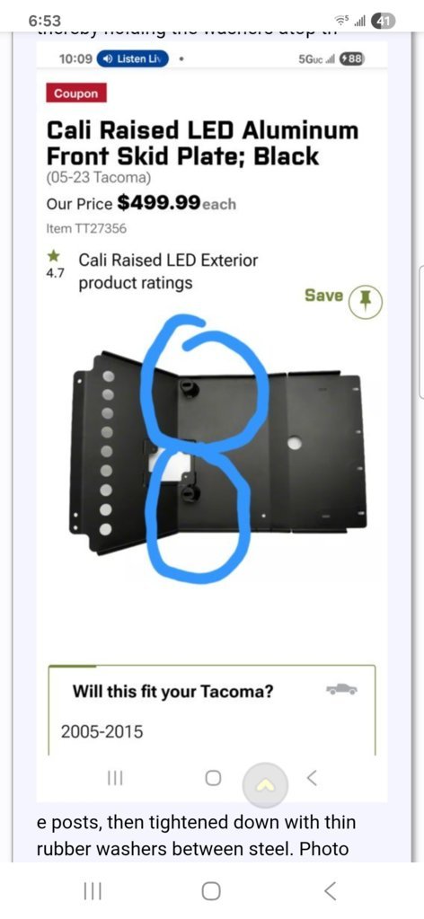

    Steel engine skid plate- rubber washer between the plates and atop the spacing posts that prevent the skid from collapsing up atop a rock or when jacked up under the mid plate.

    That's what I originally thought it was because it sounded exactly like it. I removed the skid plate all together and drove it. Still there.
