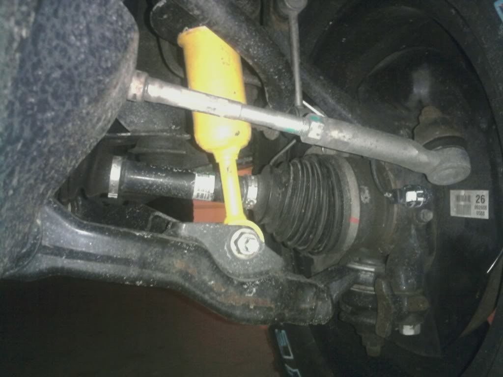

    Hi all,
    I just installed 3" OME lift with top plate spacers along with the LR UCA's. After a week or so driving a clunk has been coming from the front driver's side brake disc area... It happens when when accelerating from a stop after having just braked or going over bumps where the front suspension flexes. Once in a while it will happen going around 15mph and it kind of sounds like i just ran over a metal grate in the street, but its the truck. It sounds like metal popping if that makes any sense. Anyone else having issues like this, any help would be greatly appreciated.

    Did you do the install?? I'd go back thru and make sure you have all the bolts tightened up again...Double check the sway bar and skid plates.

    At they touching while sitting still?? or is there some sort of weld bead or anything??

    here is a photo, i can get more if needed

    the bolt holding the uca on was loose, tightened that up and fixed the issues, thanks for the help
