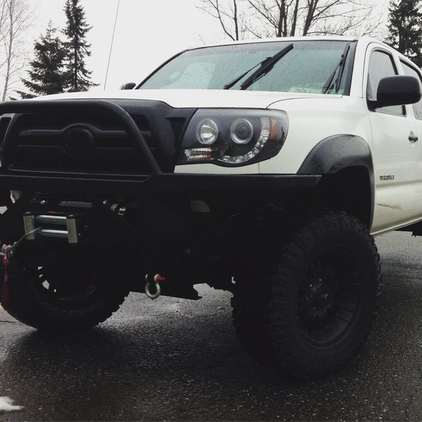

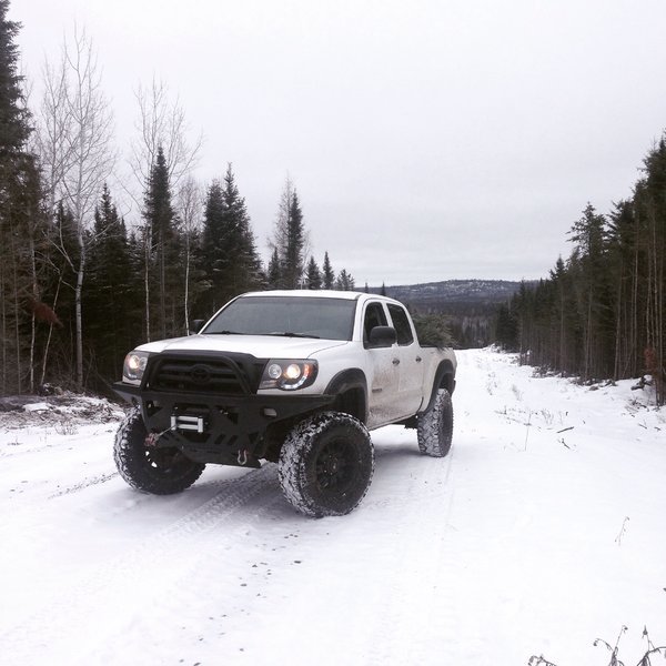

    2008 double cab long box
    260000km
    Icon suspension font/back
    Dakar leafs
    Carrier bearing drop
    Total chaos uca
    Cbi Moab front bumper/skid
    M8000 warn winch
    Spyder lights
