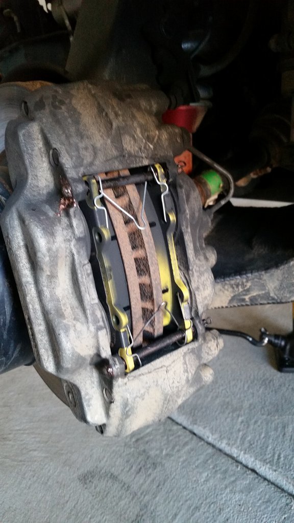

  8. Jun 26, 2019 at 6:45 PM
    #28
    hyper15125
    hyper15125 Headlight Retrofitting Hobbyist Vendor
    Feb 11, 2015
    #148420
    2,235
    NJ (609)
    ancient11 and camillethetoy like this.
