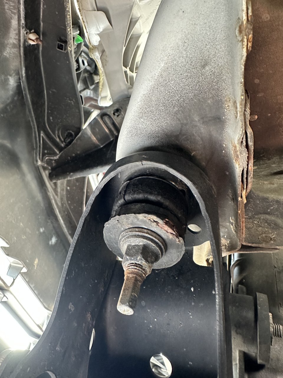

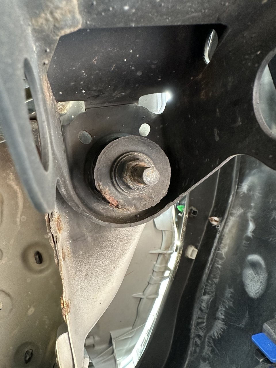

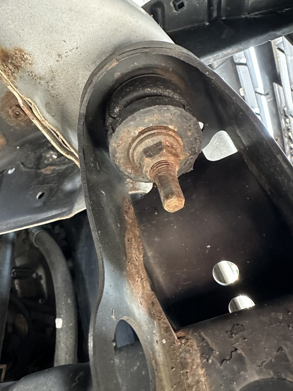

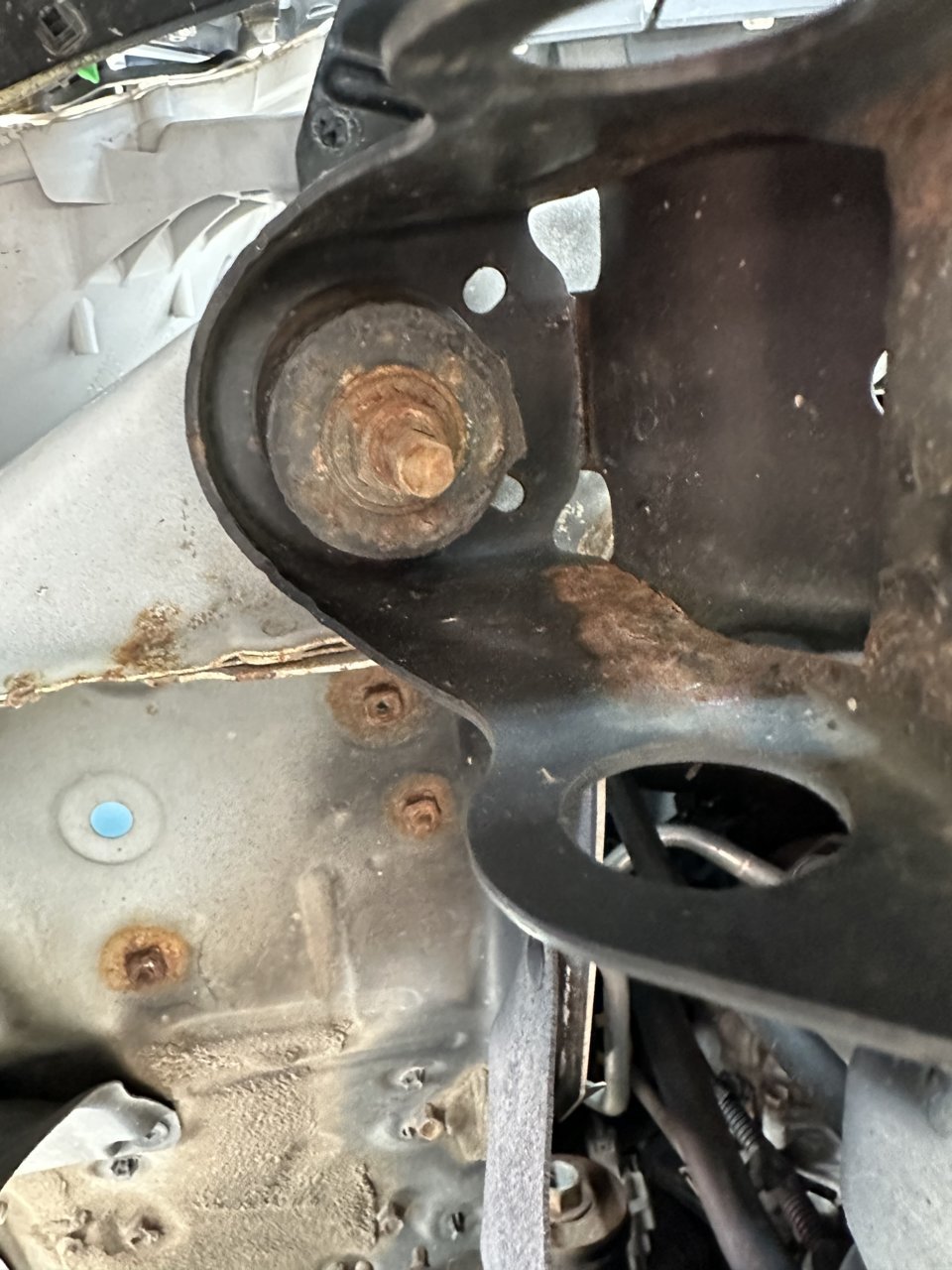

    I did look at the bottom ones while crawling around under the truck, but they didn’t seem out of whack or anything and I guess I hadn’t considered they would make a clunk like that.. are they a possibility?

    Here are pics of the lower bushings, they look original, but not sure if they look bad..

    Hahahaha yep, just went thru your thread on the rad support bushings and am now aware of how terrible mine look! It doesn’t sound like the coilovers, like I said, definitely sounds like the drivers side front bumper which would point to the rad support bushing. I ordered the ES kit, should have it Wednesday. Thanks for all your help man!

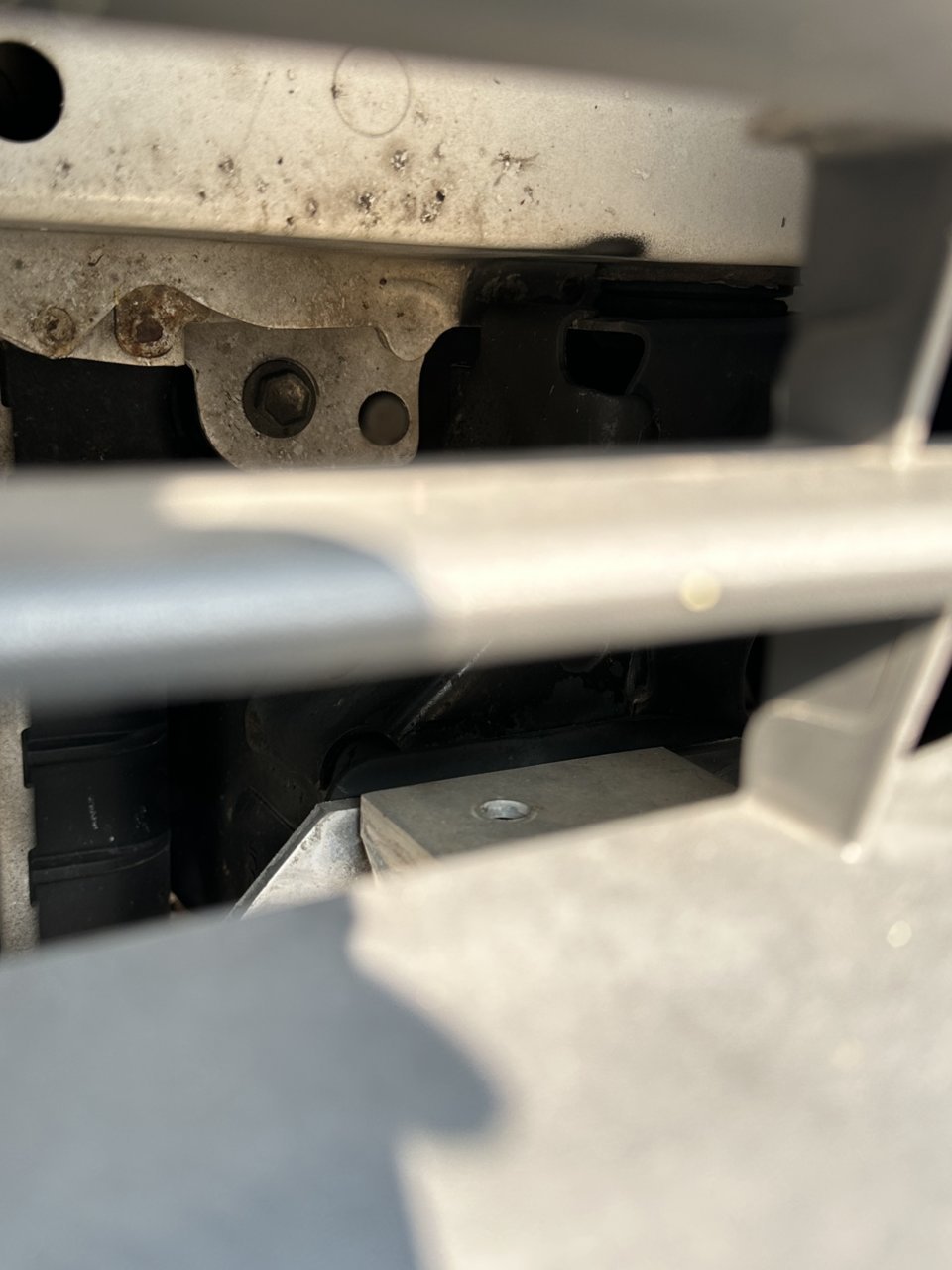

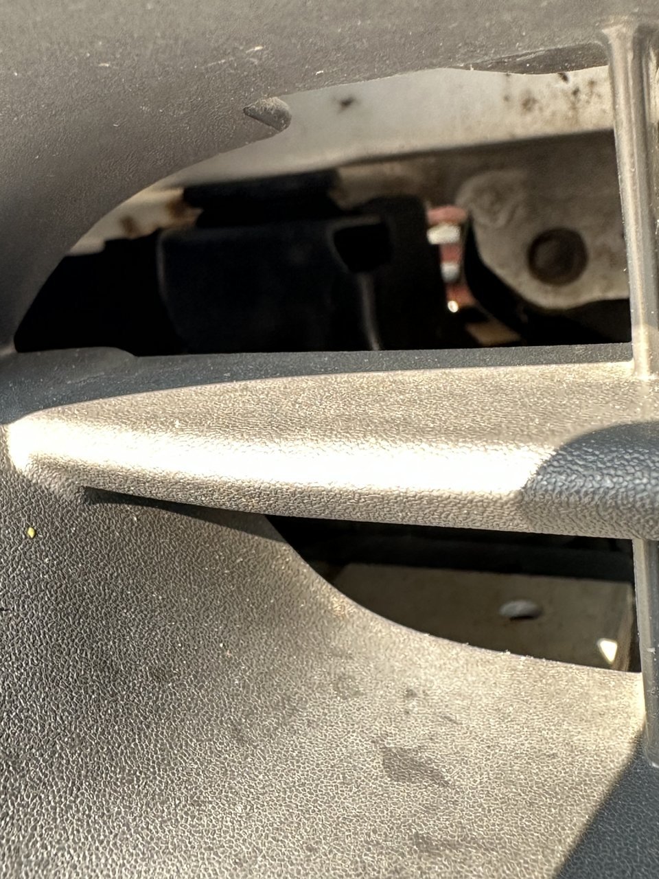

    In that last picture, is there a bolt missing?

    I thought the same, but I don't think so - it's the bumper bracket. Not sure if the PO had something mounted there or not.
