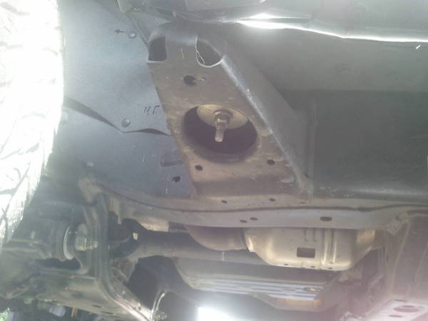

    Also, this: (sorry for the length, but the ladies like it)

    They're tight but I'll get the Torque Wrench out and check them again while I check the body mounts vv
    Thanks! I'll check in a minute.

    Did you do any brake work recently? This is probably unrelated, but I'm gonna post it anyway (since I am so relieved the damn "brake-click" is gone):

    Nope no brake work. Check all four cab bolts and they are tight (34 ft/lbs).

    Seriously though.. that mod is incredible. It took up the little play in the steering that was there.. and it is rock solid now. One of my favorite mods to the truck to date. It blew my mind the difference it made.

    I noticed mine clunking/popping a few months after bringing it home. It would do it mostly around corners, and it was pretty loud with the windows down.
    I put Billies on the front and found one of the Cam bolts was frozen in place. I lubed it up with penetrating oil, and it hasnt popped since. Its on my short list to do eventually though. Hopefully your replacement cam bolts take care of it. Good luck.

    Just tried this, got rid of the numb feeling in the steering.

    Seriously. I did this and tightened down the body mounts (driver side front was looser than the others) so we'll see if it got rid of the clunk under the floor board.
