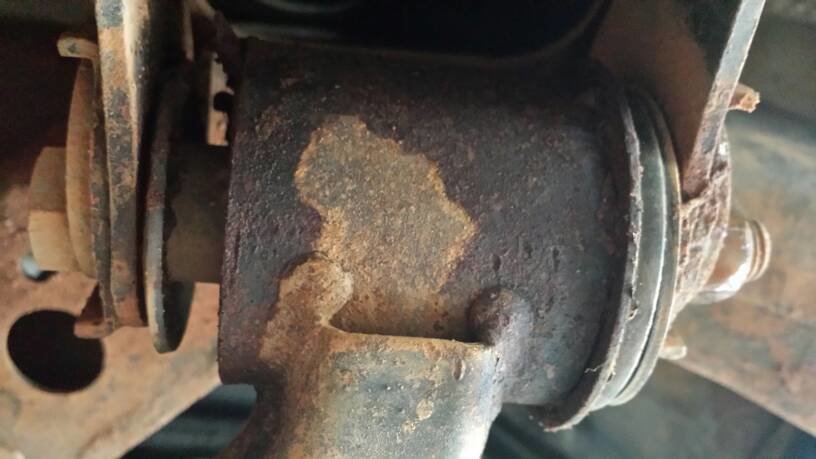

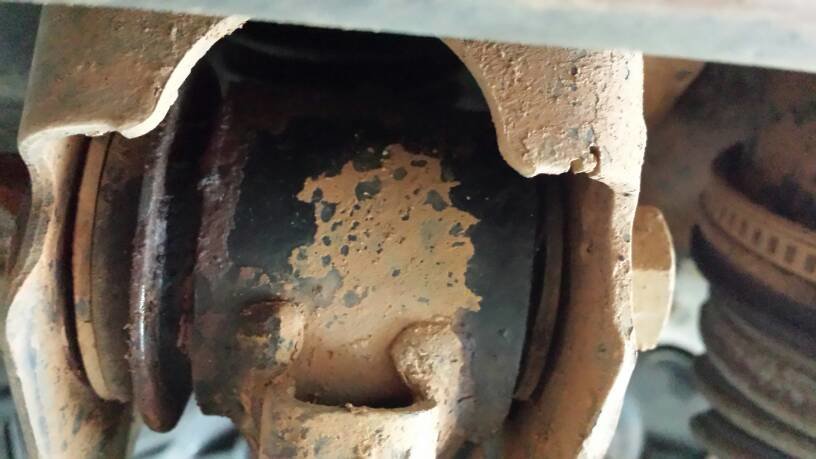

    The moog front (smaller) lca bushings are not working out for me..
    I finally figured out my Pop,Clunk,Bang,Knock in the front end. The LCA is "breaking loose" from the LCA bushing.. I thought the LCA was bent narrower when I removed or installed the LCA bushings but turns out the moog are too small.
    https://www.youtube.com/watch?v=s-Ub2rUdqEI
    Front bushing
    Rear bushing
