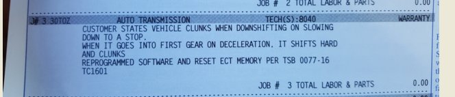

    My 17 also clunks. Took it in this morning for the 5k services and asked them to check it out. Just got a call from the service writer that they did a software update, but the tech couldn't actually duplicate the clunk. Update to follow.

    Here's what the dealer did:
    Didn't notice a clunk on the way back to work but it was a short drive.

    This sounds like the issue where the transmission is a quart low from the factory. If you have the tow package, it could have come from the factory this way. The clunk, when cold, on stopping, rough shifting, shift flaring can partly be explained by this. The Transmission TSB posted earlier should help with some of those symptoms as well. Many 2016's are effected by this. Here are the related TW threads:
    TSB for Transmission: https://www.tacomaworld.com/threads/t-sb-0077-16-rev-1.457782/
