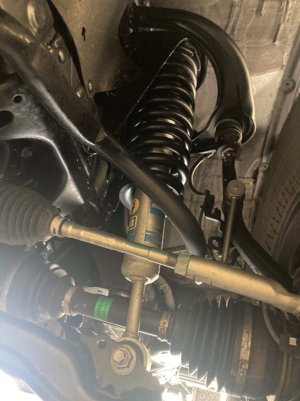

    If you have Aftermarket Coil overs inspect the coils and sway bar to see if you see any marks of evidence that the sway bar is contacting the coils.

    mine looked to be making contact so I installed a sway bar spacer which seemed to fix that but I still have the noise. I didn’t even think of that, hopefully that fixes OPs issue.

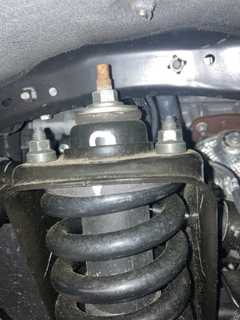

    You mean this area?
    Gfenza89[QUOTED] likes this.

    That strut looks factory. Didn’t you say was aftermarket?
  17. Feb 26, 2023 at 9:11 AM

    I’m gonna say it’s the strut try spraying the top mount area with silicone and see if it goes away
