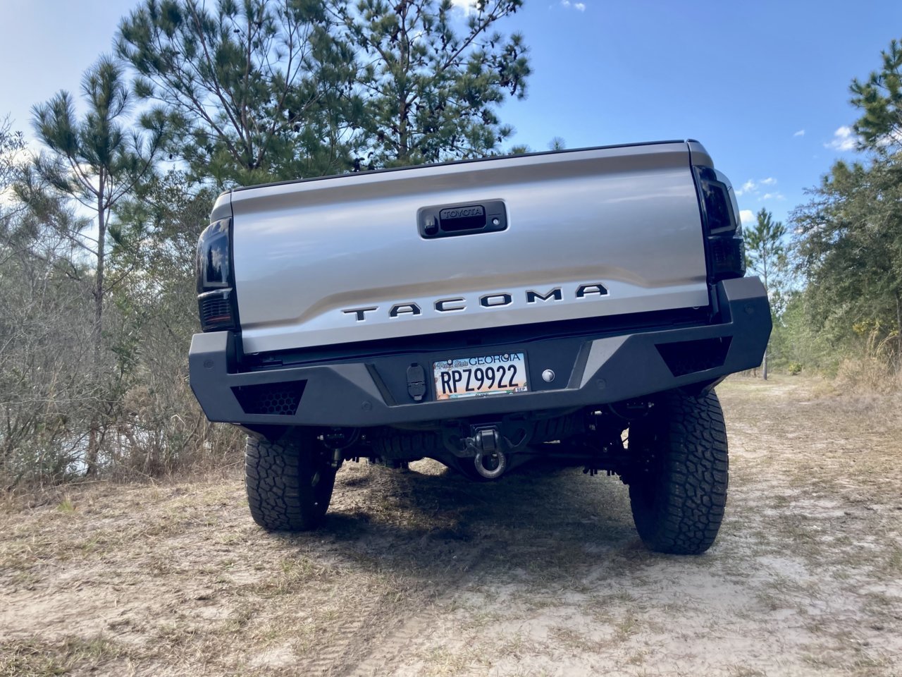

    It drove me crazy for about 2 weeks thinking it was my front Fox coil springs or swaybar mounts.
    Never thought that our frames could be that weak to flex that much on angled driveway slopes.
    We Need some X cross braces like exotic cars have.

    In all fairness I’ve helped work that trans skid by giving the frame some flex; the frames certainly can get twisty, especially on real moguls. This is just one of the times I’ve happened to step out and snag a pic (yes, it’s a lackluster one), normally I just keep wheeling and regret not taking any pics later.
    However this was right about the time I started noticing the clunking sound.
