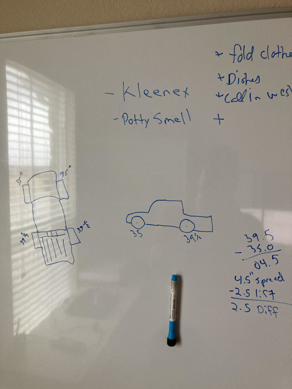

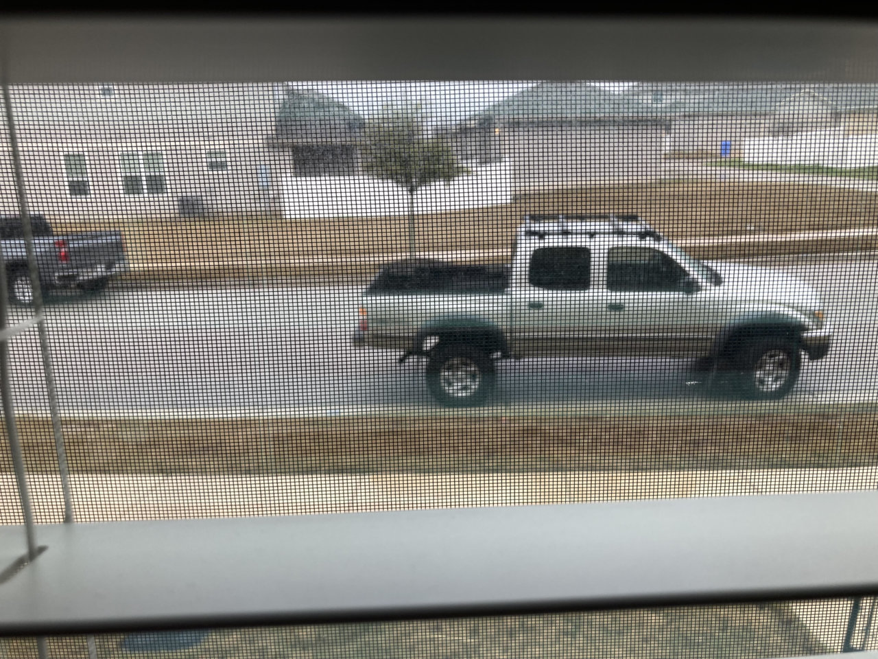

    Update:
    Finally installed my J59s along with Bilstein 6112 Front Shocks + Springs & 5100 Rear shocks and happy to report all (noticeable) axle wrap is gone! These suckers gave me a >4inch lift on the rear and I posted my front 6112's for a 2.5in lift. I'm hoping the rear will eventually settle and meet the front 2.5inch lift. Currently my J59's are not drooping but smiling.
    Cheers!

    OP, your dry erase board has me wondering what the status of the potty smell is? Hahaha

    Central Texas had an unprepared freeze last week and we had some friends without power stay here for 2/3 nights. We got to eat their fridge food but boy something didn't sit right with me and our poor bathroom was ravaged without air freshener!
