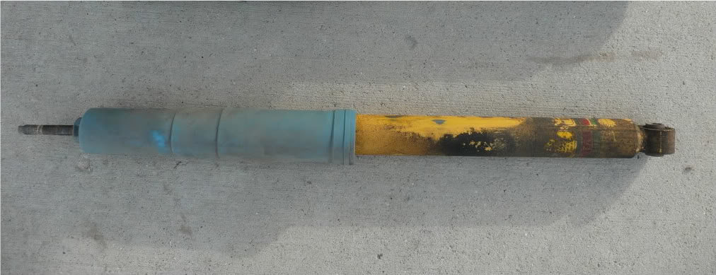

    Positive it is coming from the front?
    I had the same problem, swore it was coming from the front, but after a year of trying to find it, I changed my focus to the rear.
    This was the culprit....
    Vibration traveled up the frame rail, and led me to believe it was up front because I could feel in the floorboard right under my feet.

    I swore up and down for almost a year it was the front. After torquing the front over and over again I decided to check the rear. I immediately noticed the wierd rub marks and oily build up on the driver's side rear shock.
    I haven't heard the noise since installing my 5100's on the rear.
