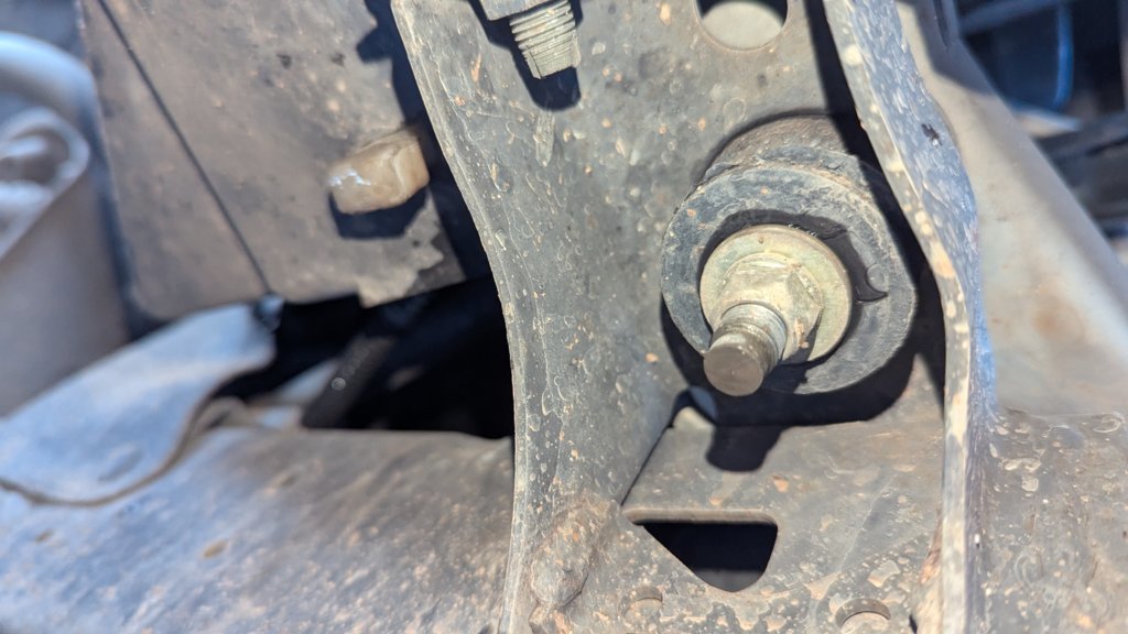

    Hey everybody. About a week ago I went mudding with my buddy in my 2003 toyota prerunner V6, and near the end when I hit a small bump going slow crawling uphill and I noticed this "Clunk" or a "thump". He mentioned it and I passed it off saying it was probably a rock under the skid plate, later in the day I was pulling into a mcdonalds and it had a decent little lip to get into the parking lot. And I heard that same distinct "thunk" or "clunk". I parked and went to take a look at it, and there was nothing that seemed out of the ordinary for a week after that I didn't do any offroading, besides slowly driving the dirt road up to my work, and I didn't hear anything. Yesterday, I had to pick up my little sister from school, and I took a backroad back to my house. One that I am very familiar with, normally before the noise started my truck would eat up every bump without the sound going at least 35. This time I was doing 15, and it was clunking and thunking to all hell. Still drove smooth and overall had zero change in how it drove. Got back on the road and it did no such thing. Of that week of silence I attempted to recreate the sound and get it on video, but was not successful. I attempted to flex it out, nothing, I got in the bed and bounced it a lot, nothing. Nothing I did could make the sound. Yesterday I could not get a video of it because the backroad had a lot of mud, and I needed my full attention on not sliding into a Ditch. Today however, I finally managed to get a video of it making the noise on a somewhat bumpy little shortcut on my way home from work. The bunks weren't that bad but enough that I could recreate the sound. My windbreakers kind of loud, but if you turn up the volume you will hear a distinct "thunk" like a second into the video, and then two or three other identical sounds for the rest of it. https://youtube.com/shorts/GhuTmZIJN0E?si=hOP7kcDfzrA51Pg8

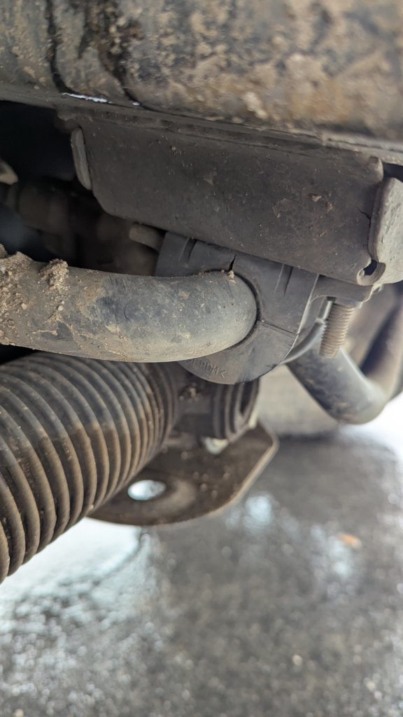

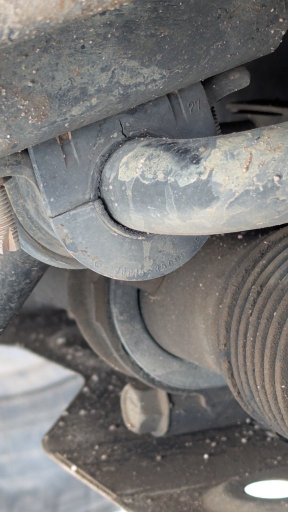

    Every time it made the sound I could feel it in the floor. From what I have researched it could be a number of things. I've looked at my sway bar bushing and they don't that great, but they don't look bad enough to make that sound. And if they really are that bad then they must have just started to go out if the only thing that makes it is some decent sized bumps. I also looked at the driveshaft carrier bearing. And it wiggles around but it doesn't seem to be an excessive amount of play. I haven't jacked up the truck yet, but all of the front end components seem pretty right. I've heard things about cab bushing going bad or coming loose, but all of them seem pretty decent. I'll probably check again anyway, they are not my upper ball joints because I have camburg uniball uppers. And the lower ball joints were replaced not too long ago. I'll try jacking it up tomorrow to see what's going on, but if you have had the same sound and might know what it is, please let me know! [​IMG] my passenger side sway bar bushing [​IMG] my driver side sway bar bushing, I'll update with more photos when I look at it more.

    Could be worn out radiator support bushings
    Black97v6MT likes this.

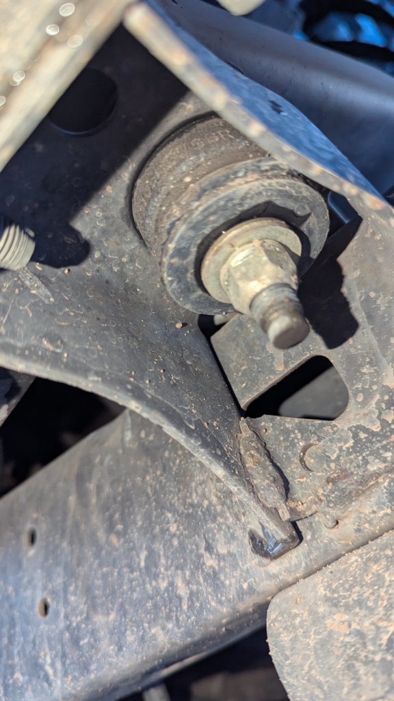

    I took a look at those and they look pretty fresh. The radiator didn't have much play to it

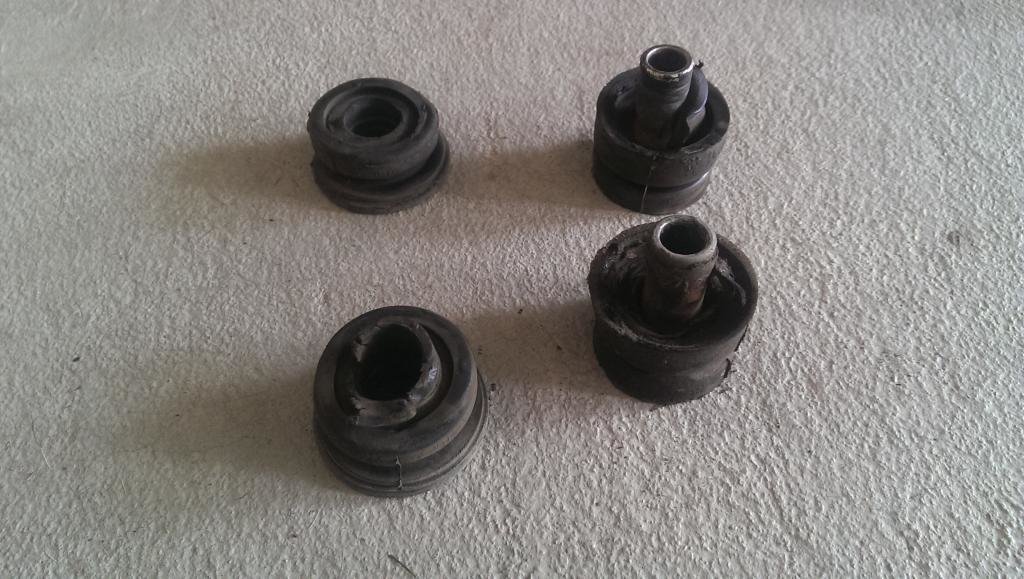

    If they original they’re worn out, it’s the inside part that wears. I chased a clunk for a bit. It was these. Easy to replace.

    Yes they do, when they’re worn out the radiator support can drop and bounce on the frame.

    I had loose sway bar end links and it sounded very similar.

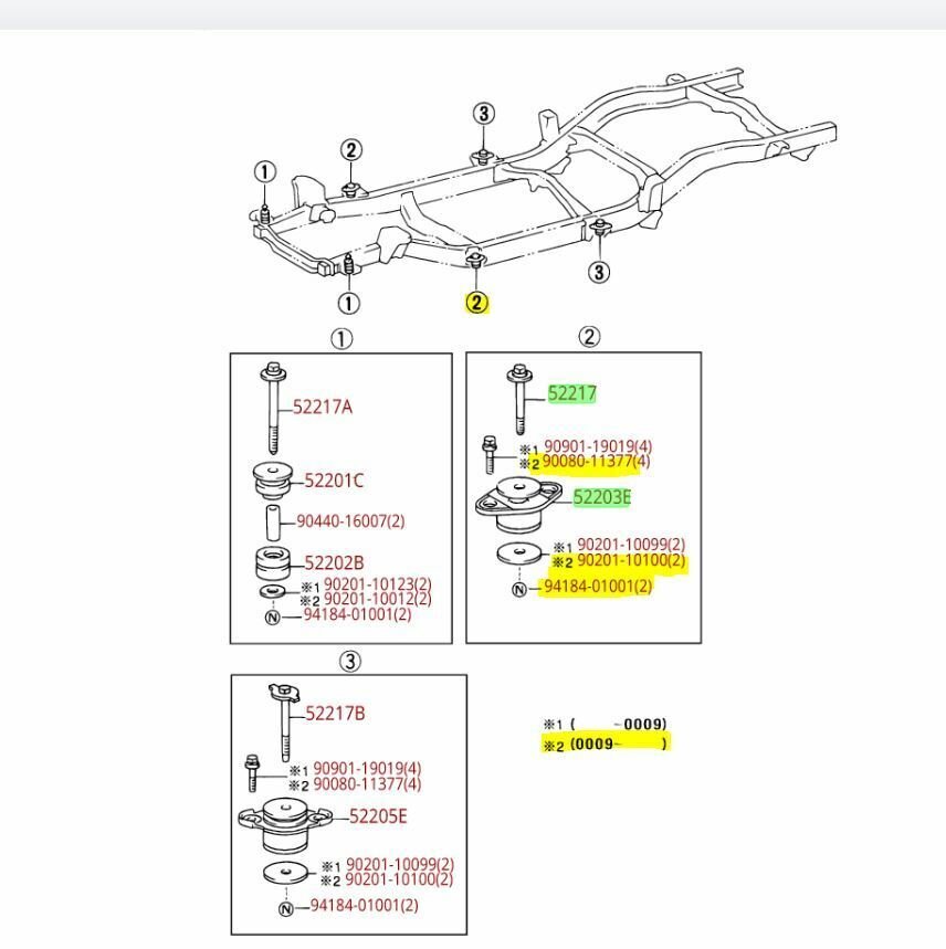

    Just to add two more possibilities worth inspecting and ruling out:
    1. Front Diff Mount Bushings - when these are worn (and anytime oil leaks or is spilled it finds its way down to these - and hot oil will accelerate the bushings wear), it can allow the diff to clunk against the skid plate. Easy way to rule this out is remove the skid plate and if symptoms go away, this is your cause.
