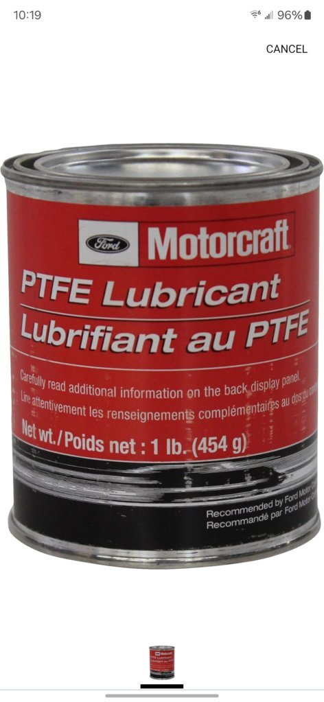

    To add to what @Parkvisitor said, here's a prime example of when the slip yolk will clunk:
    If I'm backing out of a parking spot, then catch 1st gear while I've still got any rearward momentum, I'll get that same dull thud.
    My truck just started doing this again, so I'll be disassembling the slip yolk and greasing it again today.

    Yea it'll sling some grease for sure. That being said, the Ford/Motorcraft PTFE grease that Timmy recommends in his video is thicker and won't fling off as much (also fixes the issue for much longer than typical greases you'll buy at your normal parts stores).

    that stuff is probably better than what i have been using
    red tacky in a tube for the squeeze gun
    Jimmyrace and Red_03Taco[QUOTED] like this.

    I was using Red & Tacky at first but the ford stuff is superior for this application imo.

    I would stick to standard grease tubes for the Joints. The Motorcraft grease is pricey and only comes in a can, so it'd be a pain to try and load a grease gun with it

    I recently dedicated a small grease gun loaded with the ford stuff just for the slide yoke.
