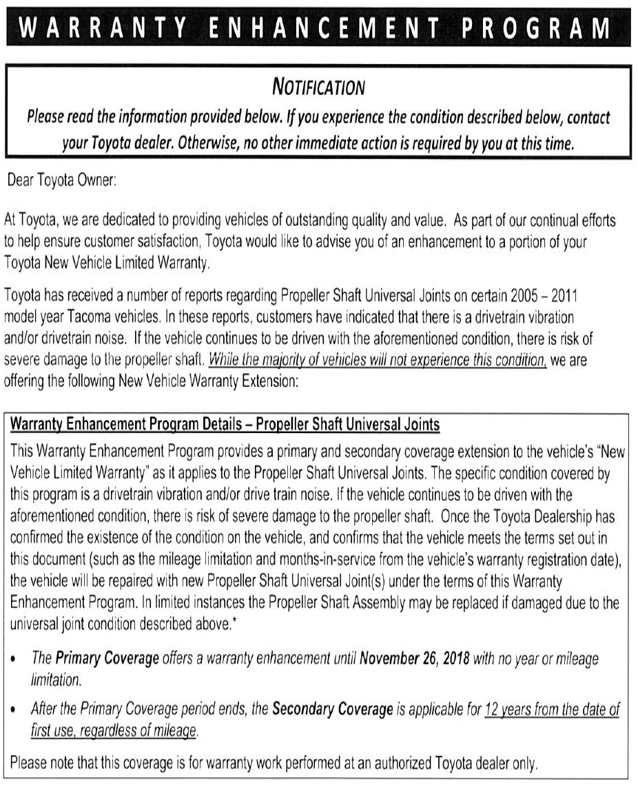

    Maybe this is you issue go straight to dealer and complain. Get it fixed pronto.
